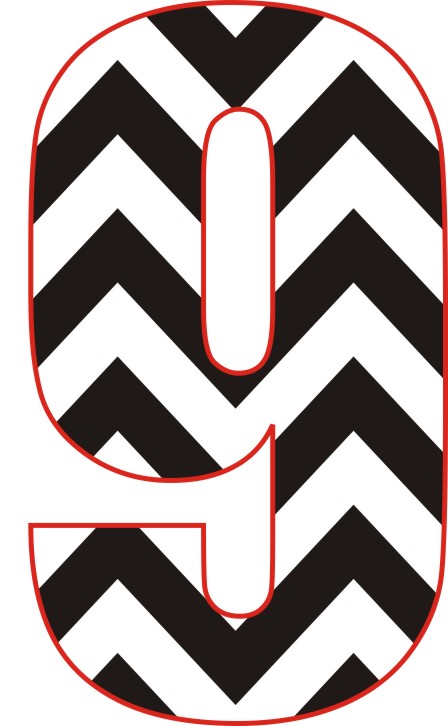

I have some jerseys that the customer wants to have a chevron design in the number so that the material is showing through. The black area in the image is what would be cut out and thus showing the jersey material.
How can I apply the Contour Cut to the image so that it cuts out these sections? My initial thought was to Power Clip the image into the number, but then I can't apply Contour Cut.
Using Corel X4. The red outline around the number is just that... an outline that's part of the graphic.

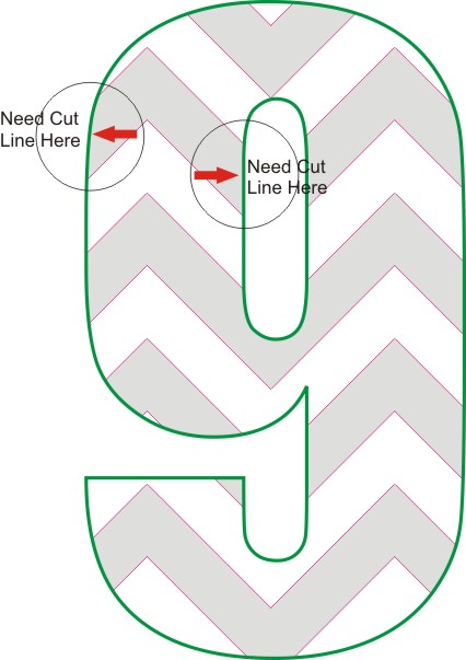

My problem is not being able to figure out how to "close" the cut out section.
In the pic, I changed the red outline to green so I wasn't confusing the issue. The darker area of the chevron is what needs to be removed so the jersey material can be seen. I want the Contour Cut applied where the arrows are.
In this image, I applied the Contour Cut to the chevron before applying the Power Clip.
I know I could apply the Contour Cut to the number, but I'm trying to eliminate having numerous pieces making up the graphic.

SP, use the [1] Intersect command to get your chevron pattern 'cut' to the shape of your number.
Then it's just a matter of clicking with the Smart Fill tool in the areas that you want a cut line.
I set my Smart Fill to default to a hairline (cut-contour color) and no Fill.
Makes these kind of projects quick & easy.
Team Valhalla
That's the ticket!! Thanks for the directions, that gets me right where I want to be!
