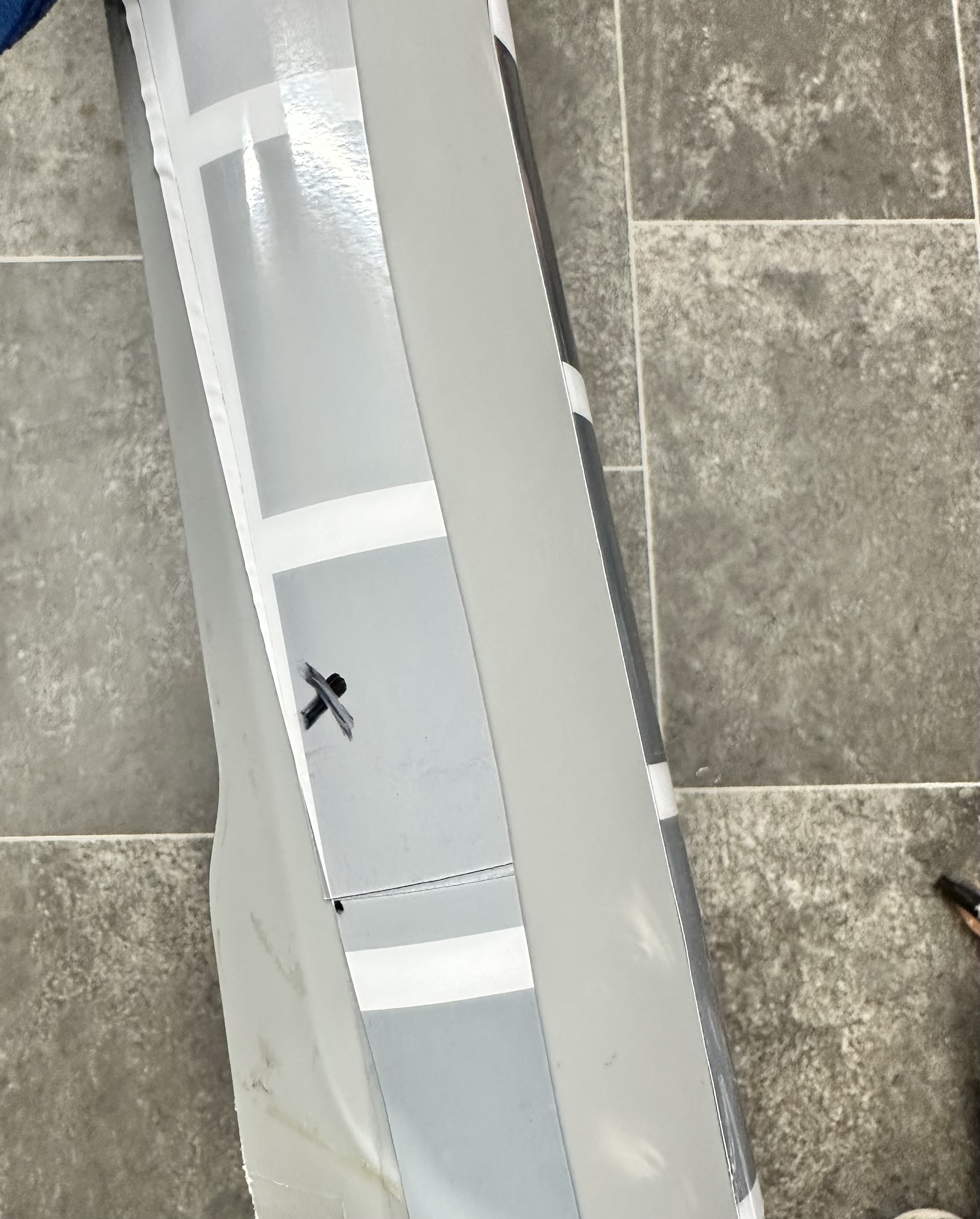

This is the shade of grey I get with my 80600 with the “cool grey 7” the square with the cross mark.

Come on man, this k part of the game.
You need to print out the entire gray searching you wanna get closer than that’s.

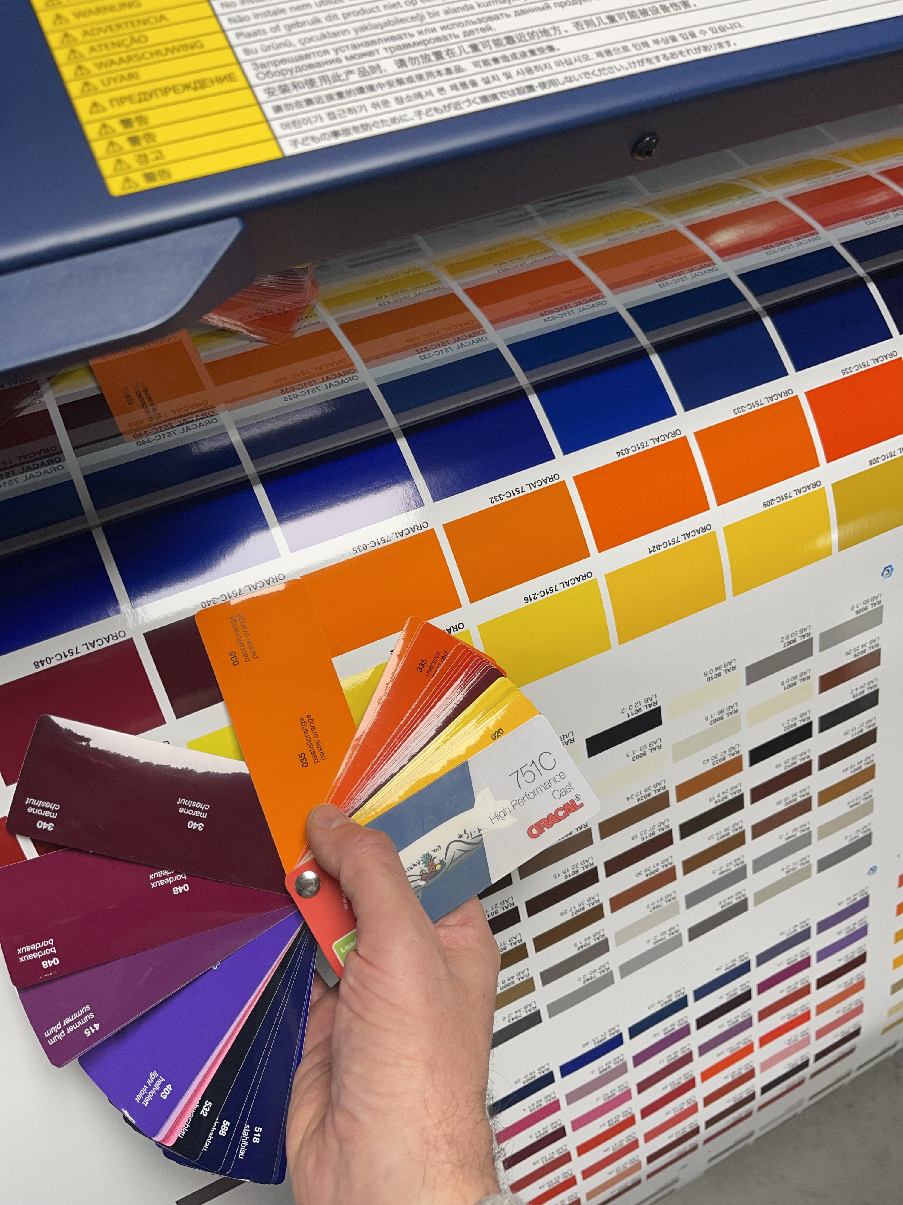

Work with custom spot colors, not only in Illustrator but in in Onyx too. In Onyx they need to be defined in the LAB colorspace. Defining spot colors in CMYK in means the color will be defined by the CMYK source profile you have set in Onyx, which is not the way to go. You can measure each reference color in LAB using a spectrophotometer like the i1Pro or the very affordable Epson SD-10. Together with a super accurate ICC profile (like 3M IJ40-10) you’ll get spot-on colors. Naming of the spot colors in Illustrator and Onyx is case sensitive.
So what you basically need to know is what are the LAB values of Acerbis Grey.
Attached is a sample of what can be achieved using this technique.
