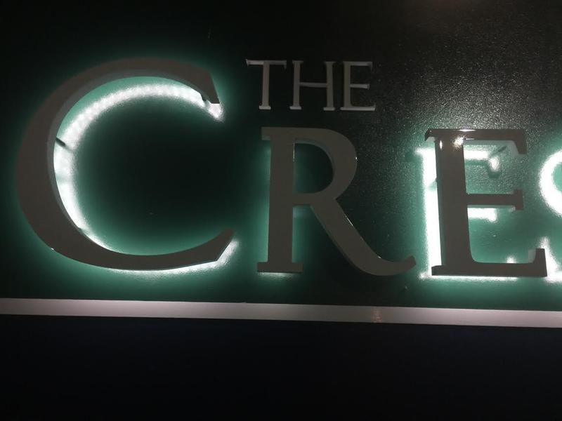

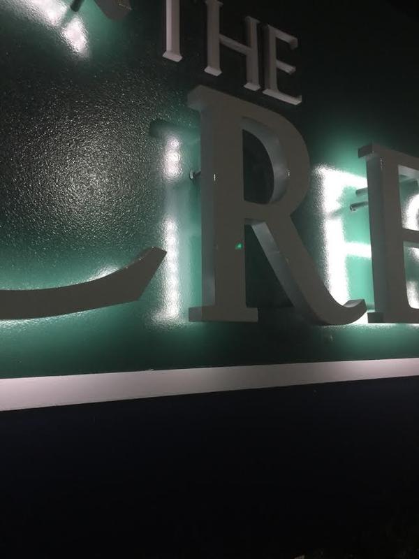

I need some help understanding what kind of problem I could be experiencing. My company built a monument and utilized slimbrite letters. The problem I am experiencing is some of the lights are going out in the letters. I have had to replace 3 already (under warranty). I just replaced the 3rd one yesterday and less than 24 hours later, another is going out. The problems I am experiencing have been on 2 seperate panels and 4 seperate letters now. What could the problem be? There are 3 panels with letters on them with separate power supplies for each. If my memory serves me correctly, the power supplies are 12v/dc. My thought is inferior led's were used on this project or the manufacturer of the lights is experiencing problems all the way around.
Your thoughts?

I am following what your saying and I don't think it's an overload of the power supply. All 8 letters on one power supply are only supposed to be drawing 1.4 watts if I remember correctly. None of the wires are pulled tight, all are making good connection in the box (letters are sealed), and no splicing of the wires. I guess to make it easier to explain think of this line as a string of lights that are all working in one letter (-------------).Now this is what it actually looks like in the same letetr (----- ------).
I would say the "C" alone is drawing about 8-10 watt (judging from the number of LED's in the reflection). Althouh.... I would agree with you... I think the LED's themselves may be the problem.
