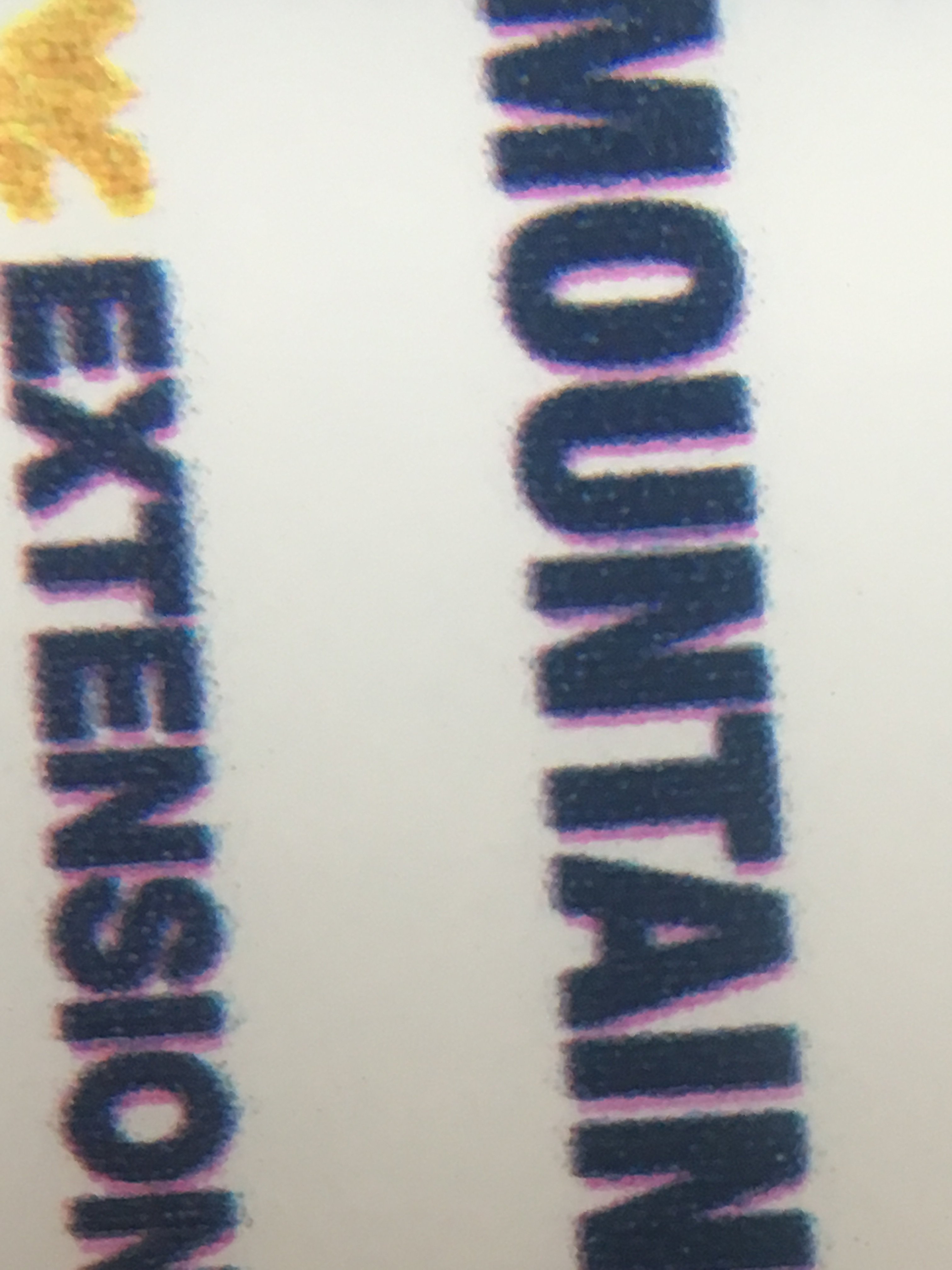

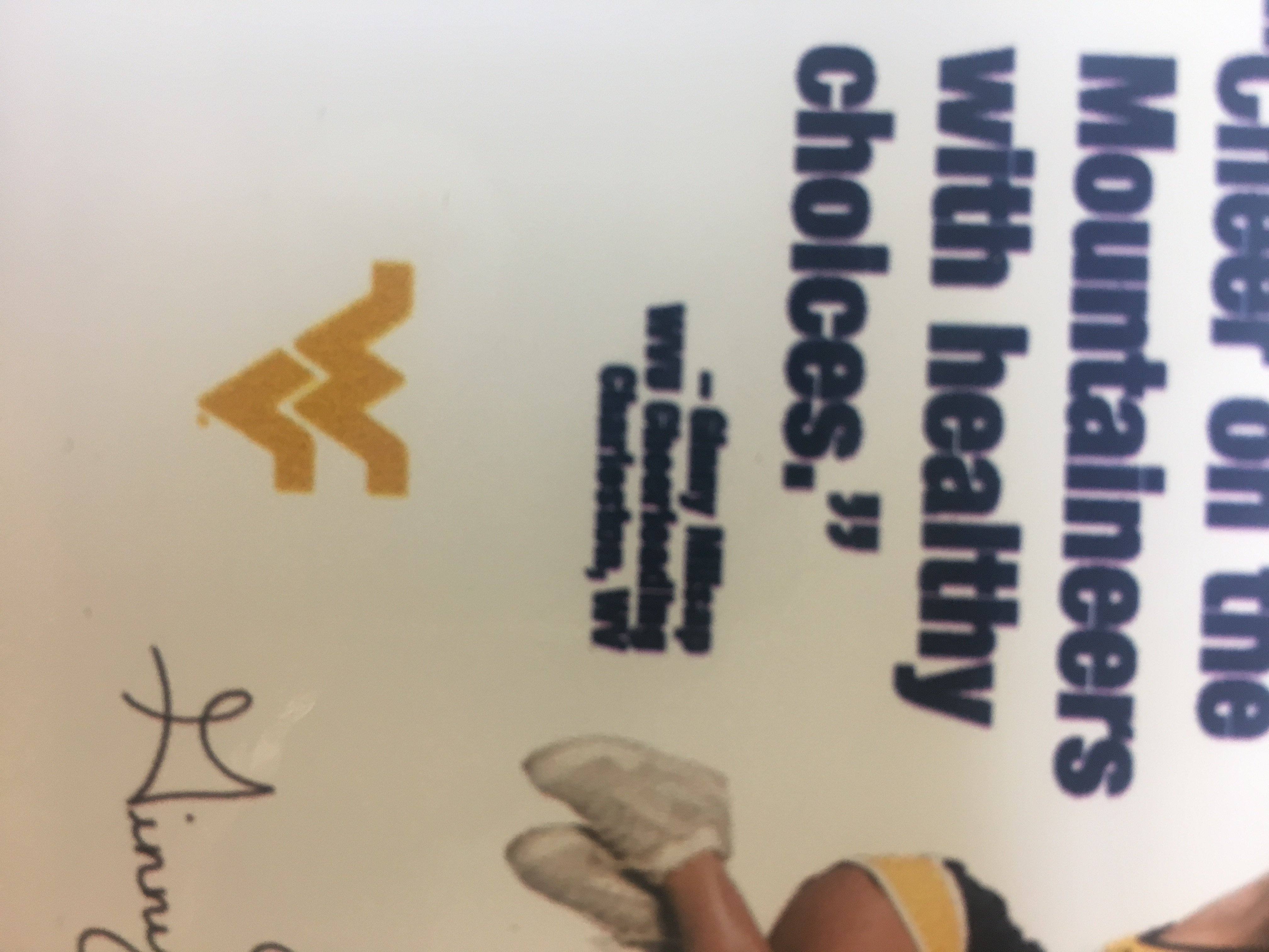

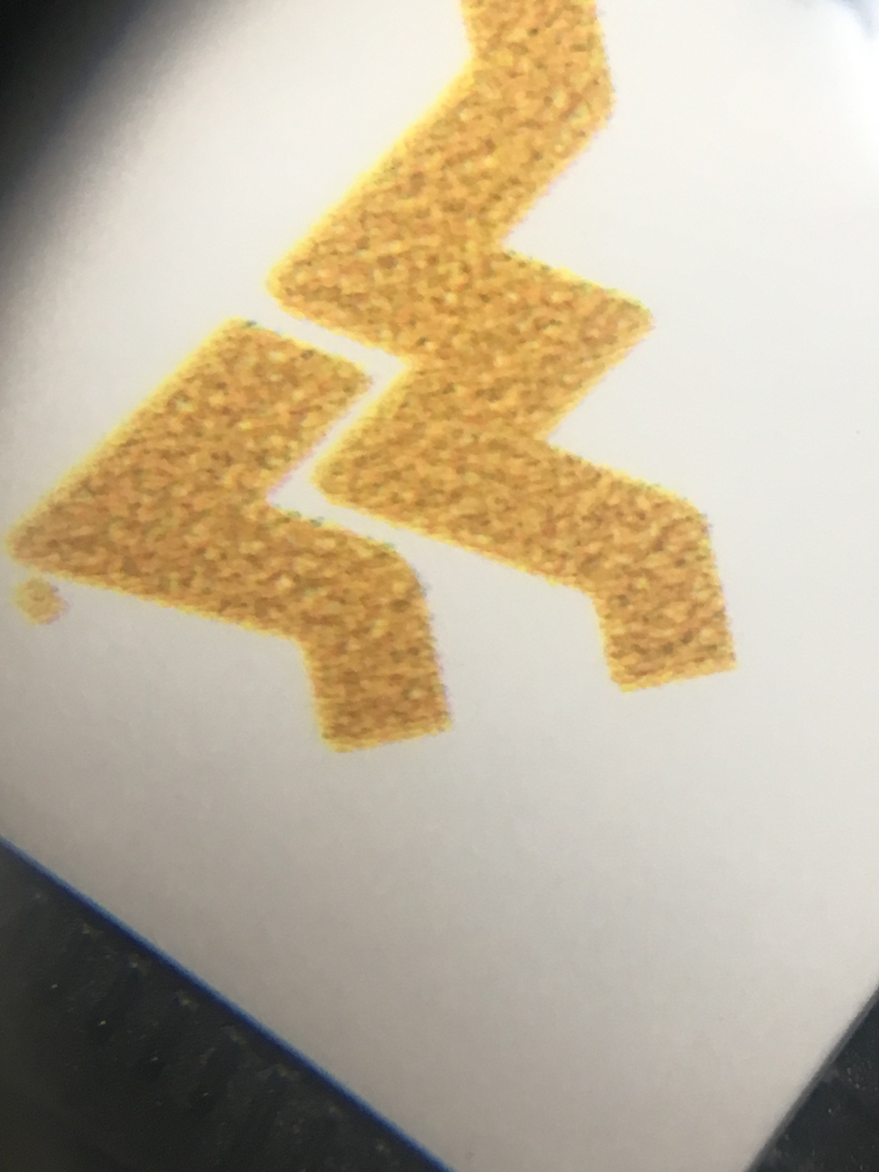

Hello everyone,
I am running a Roland TruVis VG-540. RIP is Versaworks Dual 1.3.1.
I have a very large order I'm working on, and can't get the print quality up to where I want it.
My test print is perfect. I have with through the Bi-Directional detailed and simple calibrations. I have went through the regular calibration. My tech has came in and adjusted calibration. Everything seems to be set there.
These were printed on the roland print profile for General Formulation 208 Static Cling, which is the media it is on. The magenta drop shadow is on any media I print. I'm also getting very fuzzy fine print.
Two of these photos were taken through a loupe. The third is under regular magnification.
Any help is appreciated.

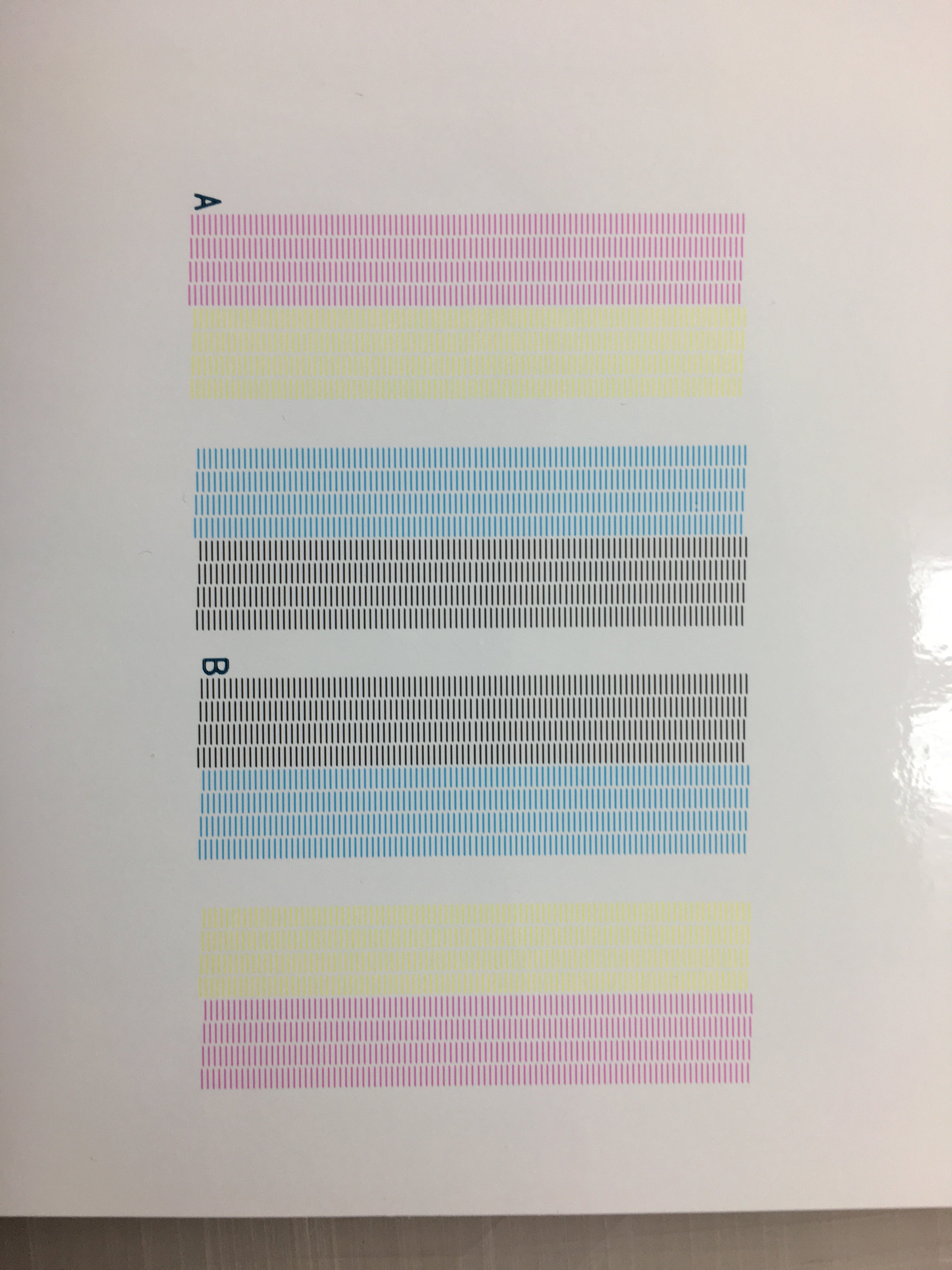

Also a picture of the nozzle test print would help. Your description that it's perfect is pretty subjective unless you know enough to not have to post this question.

The print head was printing horizontal on both of the original photos. I have attached a photo here of my nozzle test. I consider it perfect, when there are no missing or deflecting nozzles.
My tech's supervisor just came in and double checked all of my alignments and calibrations. He also ran some service mode tests and calibrations, with no change whatsoever.

All of the calibration tests are set to what they should be. This machine has had 3 print heads replaced. I am thinking that maybe the replaced heads are physically out of alignment, but that should still show in the test prints.

from what you say the machine should be running pretty decently.
how small is that type. what type of file are you using. could it be software driven issue
Dr. Decal
That particular type in the photo is very small, however I'm getting this "magenta drop shadow" on every print no matter the size. On large prints, it is less noticable, but still there.
I am printing from .pdf files.
The undesired effect is present across all prints, on all media, on any profile. That tells me that it is a calibration problem, but the tech is here now with my machine disassembled. All calibration test prints are showing what they should be (according to tech) and it's still printing with a magenta drop shadow.

It looks to me that head 1 needs to be reseated. Or that the carriage may have a problem. If this were an older printer, I would recommend that the bias adjustment needs to be done, but the VG doesn't have this adjustment.
Also, on this material, the feed calibration is slightly high, but I don't think this is affecting the magenta overspray.

The issue was corrected by the tech. However, when we tried to test it (with the tech here), the machine flashed red with an error code. We had lost two print heads. *This makes 5 total in just over a year. The two new heads came in yesterday and were installed, and one of the new ones wouldn't produce a solid test print. Soooo, print head number 6 should be here today, but the tech had another install and can't be here til this afternoon. At this point I should have taken this week off.
