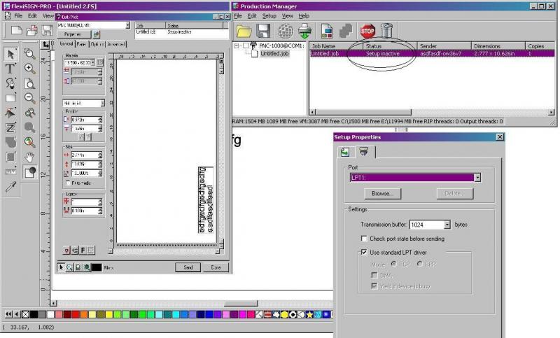

I've been away from things here for a whilllllle and sorta give up on it all.
But i've been looking at this machine and thought id give it a try again.
I know this an old machine but it has worked well in the past and i thought everyone give up on drivers for it all....
Until i loaded Flexisign 8.1 the other day and seen they had a driver for it!! Hmmmmmmmm
Well... I'm setup... and i think im close .... but it's been so long....
that i might have forgotten something about getting this to run.
I'm attaching a screen view of the settings for Flexisign... and i've noticed the words "setup inactive" hmmmmm what does that mean??:help
Is there anyone who might be able to let me know if i've got the setting right? I seem to be able to get the pen to jerk on file input but no further.
Any help would be appreciated!!
Thanx and have a good day!!!
rickCAD
GAC05
Quit buggin' me
I am not sure but one thing that stands out;
Your set up name lists: PNC-1000@com1
But your port listing in the set-up properties shows: LPT1.
Is it hooked up using a parallel or serial cable?

I think that's just the location or title because i DID change everything to LPT1.... but thanx for noticing...

have you tried it with serial (com1) instead of parallel? I believe you will need a RS-232 (null modem) cable but thats how I run mine..(PNC-950)

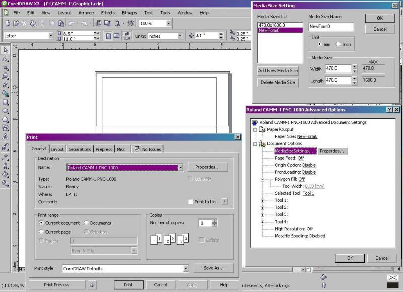

Since i'm not working.... it shows how fast i am on this.... I've got Corels X3 on an XP machine......
The first panel on the PC-1000 comes up with .....
Press Function Key
Set Width = 460mm
After i press function key i get....
*Coordinate Display*
X= 0 Y= 0
After I hit send on the computer the pen moves ALL the way to the left and up a few inches.
Hmmmmmmmmm.... Any suggestions​
THanx to all
rick​

And I wanted to add.... that all i have drawn on Corel are a couple of large boxes as shown on the attached JPG.

Ya know.... i think im almost there.... in the jpg i've attached im showing you how i changed the 'Media Size Setting' to 470.0x470.0 and did a run ALL FROM COREL.... and bing bang boom.... it printed fine....
Soooo.... i've got the driver and i'm familiar with setting to hairline for cutting.... but I've got to workout the paper size i quess. I thought the paper or material or whatever WAS 470 by 1600 but that was why the pen run high to the left.

pnc-1000 has a cutting width of 19.25 inchs and a lenght of 62.99 inches. set a custom page in corel to corespond to that and show it on the screen as 19.25 high X 62.99 long.
place graphic in lower left corner. you may have to set orintation on the plotter to be the same as the screen, this is the I/O ROTATE commamd.
