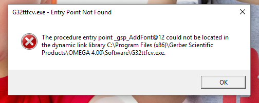

thewoodage
Fred,
thank you for the try,
but that's giving me this error message now:
the "small text" feature isn't going to be effect just because I need to convert a lot of fonts, and need them editable.
