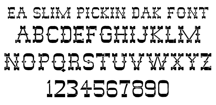

I have looked over a copy of the font. It appears to have been modified in ways I have never seen and definitely will not show up in the menu for Illustrator 8, 10 or CS2. It shows up in CorelDRAW 8 but will not give you anything usable when you type with it.
I converted it to OpenType and it will enter in Illustrator but not prreview correctly. With preview off I am able to see numerous overlapping shapes in every character.
It was either modified for embroidery in ways I do not understand or modified by someone who had no clue as to what he or she was doing.
The font itself began life as Abilene from Fluent Laser Fonts and can be downloaded HERE. I doubt the inner decoration is anything more than a result of overlapping shapes knocking eachother out.
