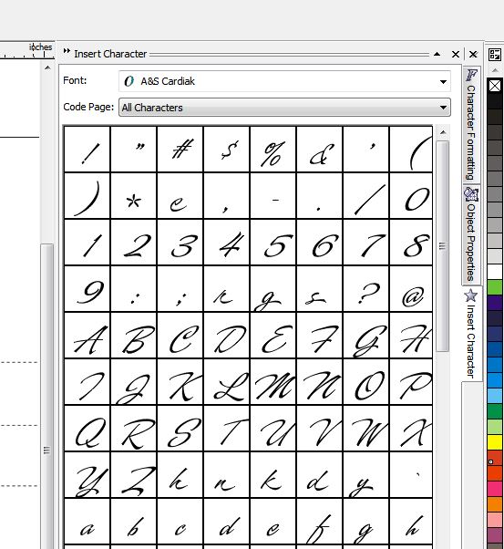

Colin, did you select "All Charactors" in the Code Pages drop down menu?
I'm not on that computer right now (it's in the shop, all turned off) but I think I did try that; it shows some characters, but not all of the special characters, ligatures, or contextual alternates that were revealed in the OpenType font in Illy.
Steve C.
The new script I'm working on has dozens of alternates and auto ligatures. I
notice that they were not showing up in Corel until I selected All Characters.
Just make sure next time you are at the PC.
