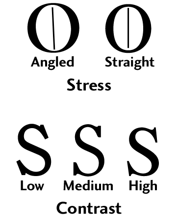

A couple of terms are used in several classifications:
Stress and Contrast.
These are very distinctive earmarks of major classification (vs. individual earmarks) of typefaces.
The capital O best illustrates stress. In the example you see that either the center or both loops are angled on the left and vertical on the right.
Contrast is the variation in stroke width of a typical letter, ranked from None to High and is somewhat subjective.
Also note in the three S characters used, two have oblique serifs and one has straight serifs.
