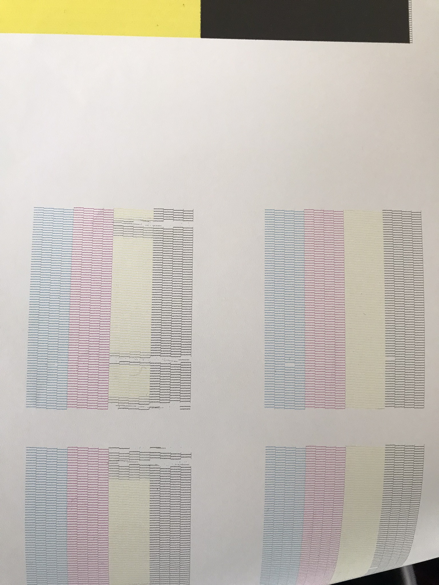

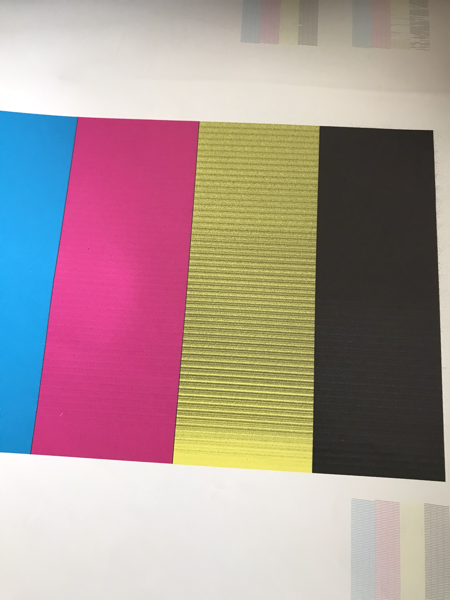

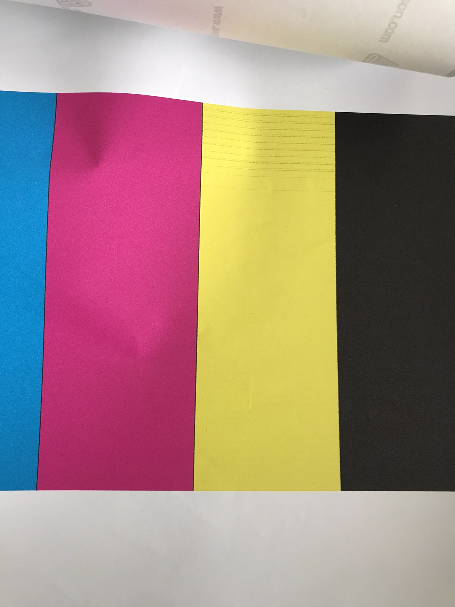

Hi there,
Since last week, I have been facing an issue with UCJV 150-160 where black unwanted lines is been mixing with yellow color.
Cap adjustment done - Negative & Positive pressure checked and within range - wiper good - waste pump looks to be working fine - cap absorber new.
The first nozzle test after cleaning is fine - the second test print shows a black line onto the yellow side. Can the capping be responsible? Looks like a leakage but not sure. What can be done for next step.

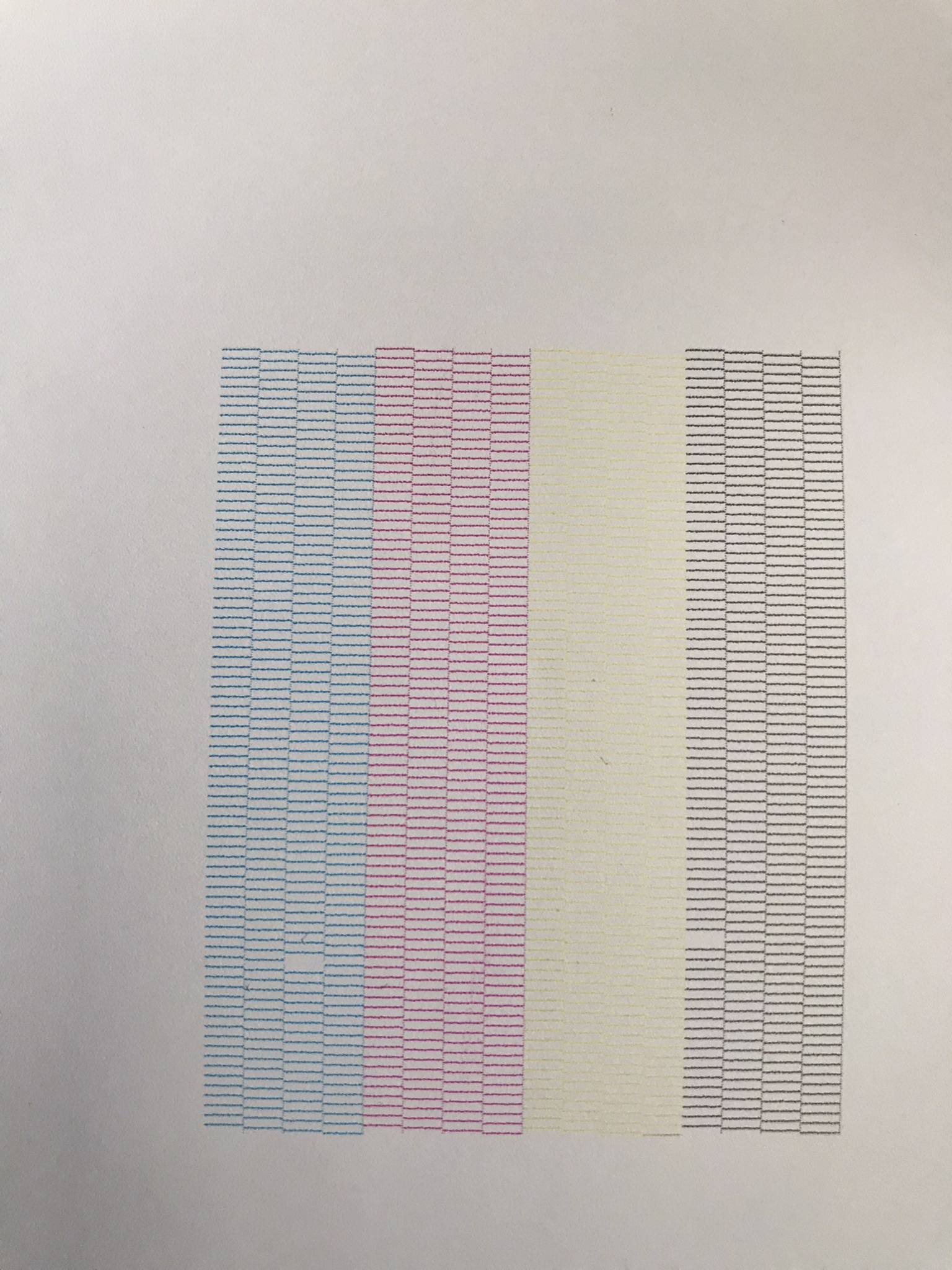

Hi,
Air purge have been done.
Cyan good
Magenta good
Yellow tiny air bubbles in ink
Black no ink at all only air.
Sub tank levels -- High -- for all four colors.
Yours,
D
