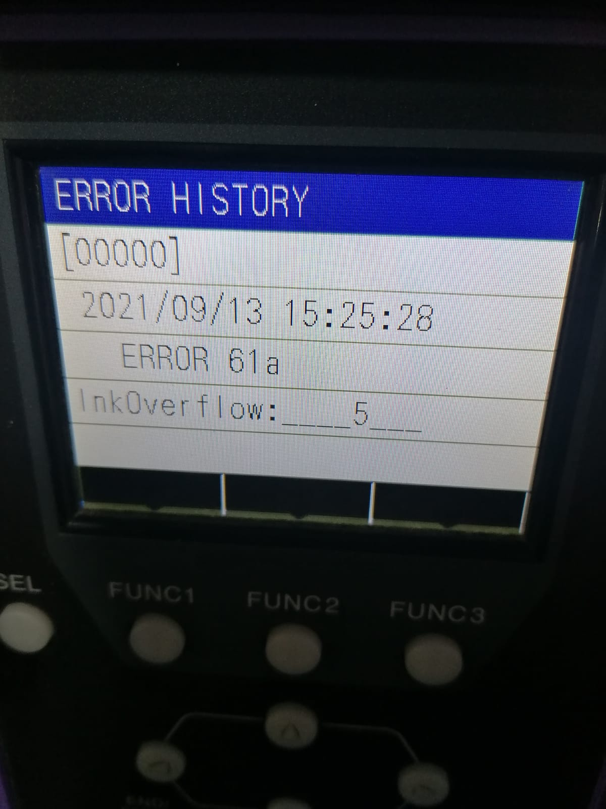

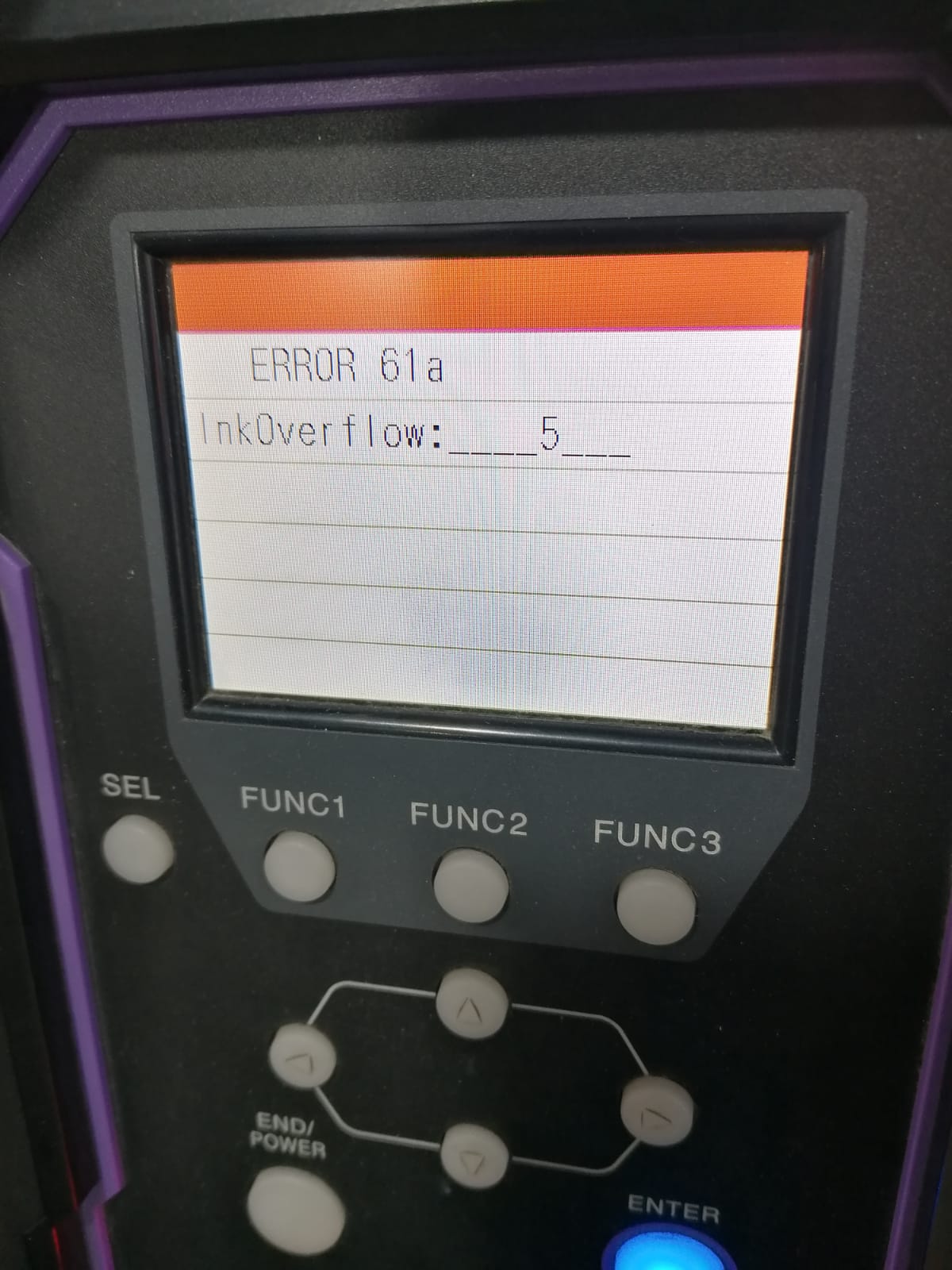

Need Help UCJV300_107 SUPPLYINK AND OVERFLOW ERRORS 61A AND 61B
I have a problem with my ucjv300_107 mimaki printer supply ink CL 6 and overflow CL 5 I tried all the solutions that I have in my manual operation anyone have a solution for this error u can see the errors in the pics

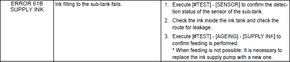

Check your positive and negative pressure values and adjust if needed. Then I'd run an air purge on the clear channels. The ink supply error means the machine is not detecting ink in the sub tank after trying to fill it which could be a pressure issue or even a clogged tube. The overflow error means the ink is too high in the sub tank. That could also be a pressure issue but if you run an air purge it should lower the ink level and get you back into normal spec.
very thankful , already checked positive and negative pressure . will try air purge .
