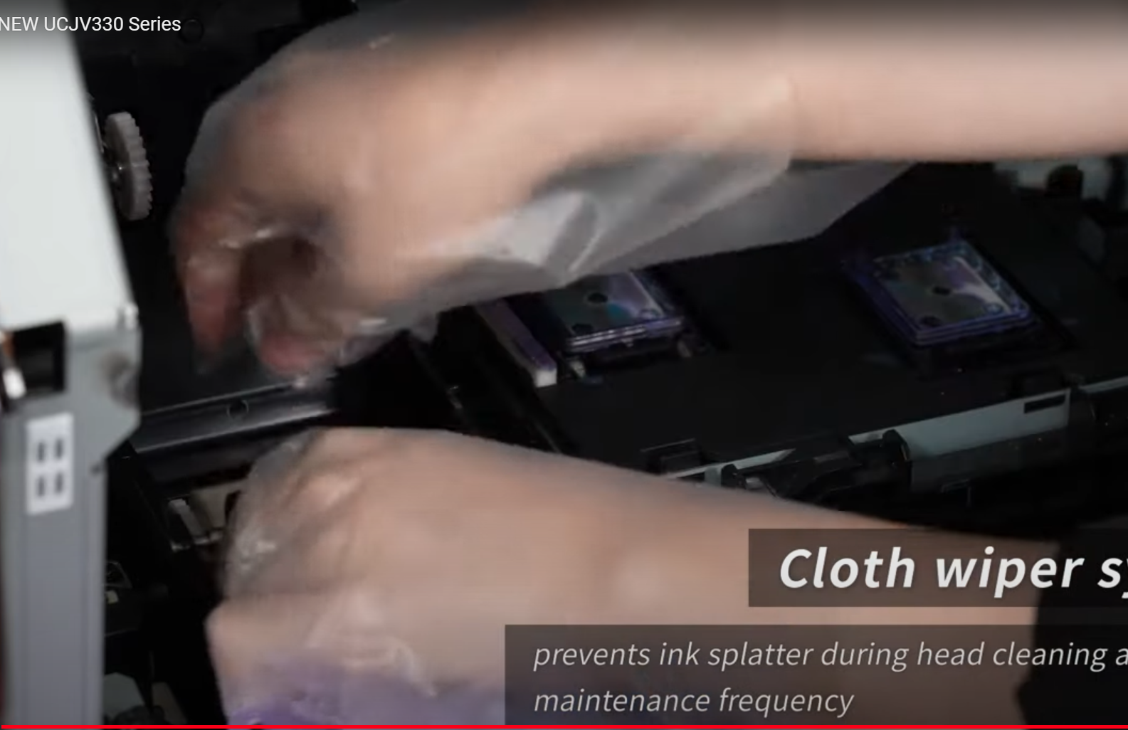

Just wondering if anyone has seen these in the wild yet? Seems pricing is still listed as TBB (but they show in stock and a 5-star rating, impressive). Not a lot to go on from the videos they've released recently and the spec sheet only goes into so much detail. If I were to guess, they seem to be using some kind of 8 channel head (maybe Brother Maxidrive series?) printheads based on the frame where the capping station is briefly shown. Color ink on left, white on right in both capping stations seems to hint at all 8 colors on both heads. Not sure about the newer Brother heads, but the DTG ones are a big pain in the butt to clean. The fabric wiper looks promising, has worked well in other printers, especially those with thicker inks. As to the pricing on the consumables and the lifespan, might be a small fortune in printer toilet paper to keep one running. Looking to supplement my early UCJV300-107 that was made way back in 2016, but really like the reliability and durability of the Ricoh Gen5/MH5430 heads.
Keeping an eye out for things like service manuals and the like as well and will post them as I go.

Specs look pretty close on dimensions of head and what I can calculate off images and diagrams. Not seen any CJV330s in the wild either, but they seem to share a LOT. As UV gets more popular, seeing a lot more UV/Solvent heads out there. Used to be solvent for the higher density heads and the lower DPI industrial oil/UV printheads. Since it's the same inks, the heads are the things that are evolving, higher drive power and larger frequency bandwidths to adapt to the different viscosity of the inks.
Nice thing is the heads are pretty dang cheap in the grand scheme of things. Seeing around $900-1200 each for the 8-channel variety. Cheaper than even the CE4 that the UJF 3042/6042MKII uses, as those are around $550-650 for a 2 channel if going by price per channel. Also, with unlocked control boards in the wild for around $600, it's a pretty versatile head. Rumors of the UJF's successor are going around as well, if the thing can do good long droplet formation for gaps, we might see those making an appearance as well.

We're a Mimaki dealer but even we don't get much info until we sell one. They don't give access to tech manuals etc. until we have one in the field. I'm wondering if maybe they're using the Epson I3200 heads like the CJV330. That model also uses the toilet paper wipers.

Seems the JV330, CJV330, TS330 and UCJV330 all share the same manual, so I think we're going to have the (A)queous, (U)V, and (S)olvent series of the i3200.
