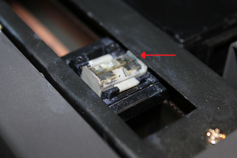

Hey everyone,
The wiper on my UJF-3042 appears to be getting jammed under the metal rail as seen in the image below. It has been a regularity since its first occurrence, normally happening when doing a regular/hard cleaning. I was curious if anyone else has experienced anything similar and could recommend a solution. I don't think it is being caused from a build up of ink.. I've looked into replacing the wiper assembly myself as it seems straight forward.
Thanks, any comments will be greatly appreciated!!
Glenn586
We run two of these all day for the past 4 years and have never seen this before. If you are confident changing the assembly then go for it. I am sure it will solve this issue.
