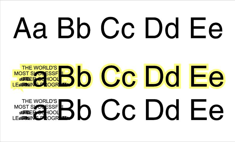

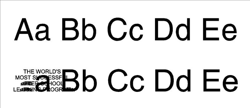

I'm having issues with flexi, more specifically the Arial font. It just replaces uppercase a's with random stuff. it actually took the text block I was typing up and started using that for the A. It doesn't do it in any other program. I have no idea what is going on with it, any help or hints would be great.

Outlining the text will probably fix it.:smile:

no dice, it does it as I type, doesn't even let me get an A. The bottom is converted to outlines, the one with the outline is... outlined

I am asking my buddy who used to work here. You need to go in and redefine the character. There is a some combo of buttons in flexi that will take what you selected and change it to a text character. Happened the same to us but on Helvetica the a changed to an arrow.

With outlining, he meant converting text to paths and not adding the stroke to the type.
Which is why I did both, you can't be too figurative around here. The Define Character thing worked, took a little effort to find a way to bring in the correct letter to define though, Flexi wouldn't even import an eps with the letter.

I think Big Easy refereed to this, what happens if you digitize an upper case A and then use the design character command, then select arial , and select A for the character and then replace the uppercase A?

Thats essentially what I did. I had to bring in an A from Corel and replace it.
