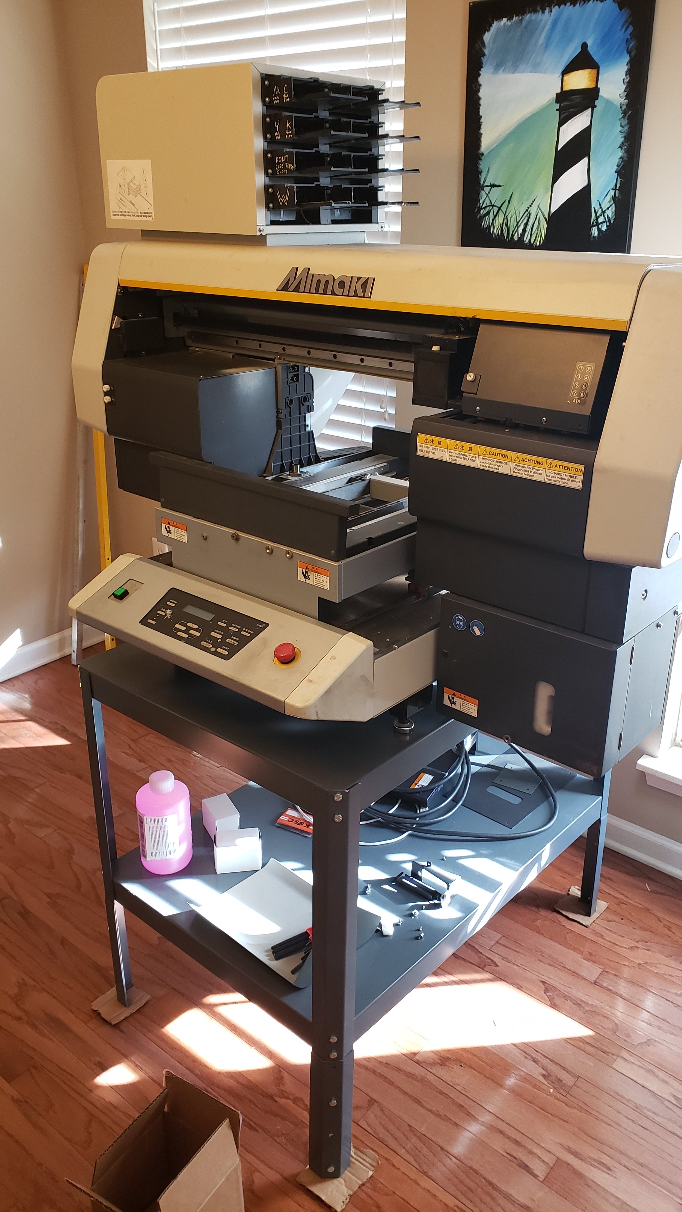

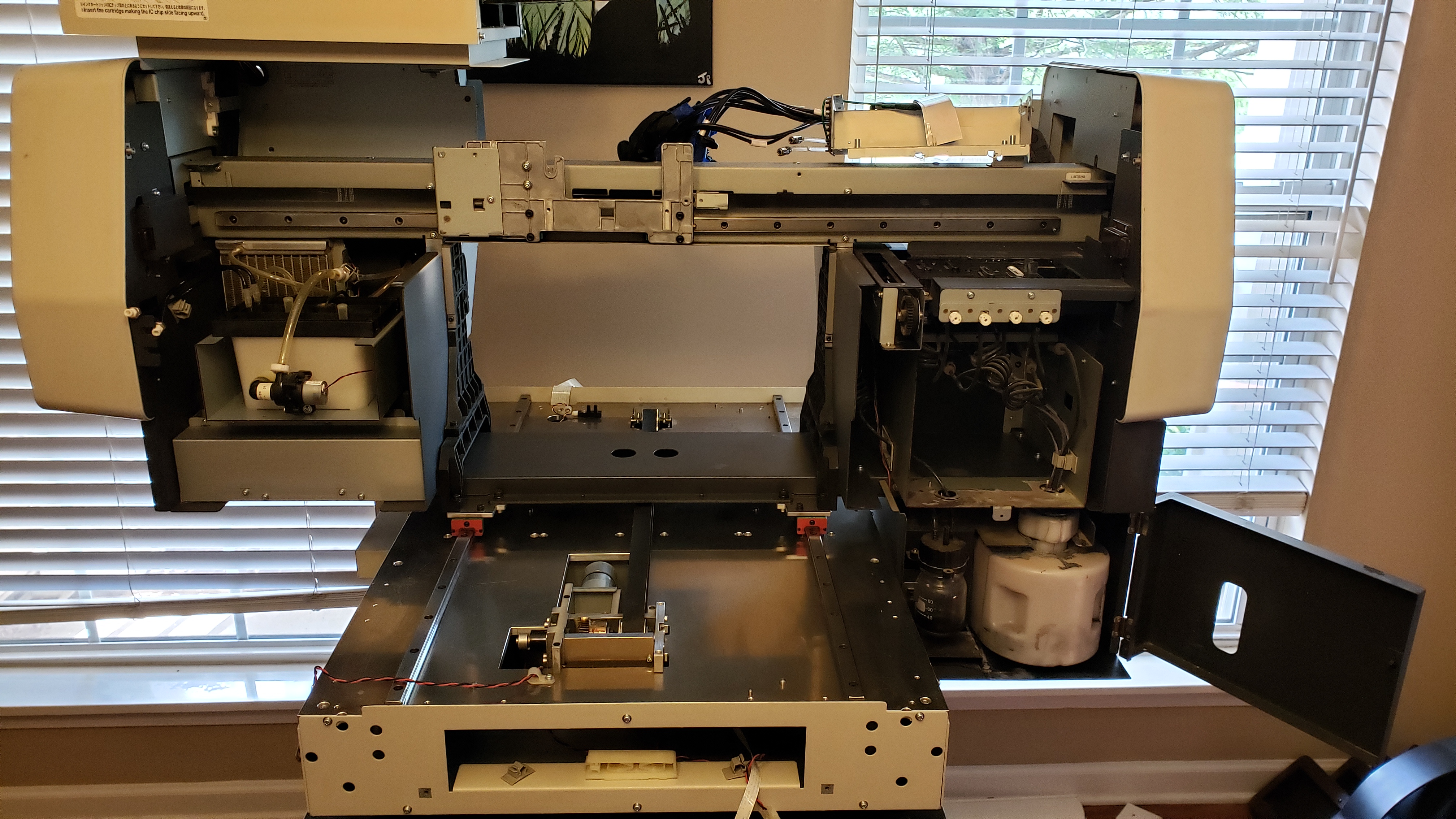

Hello Everyone,
Our new project has arrived and we are excited to share another build. This one will be headed right onto our production floor as soon as it's done.

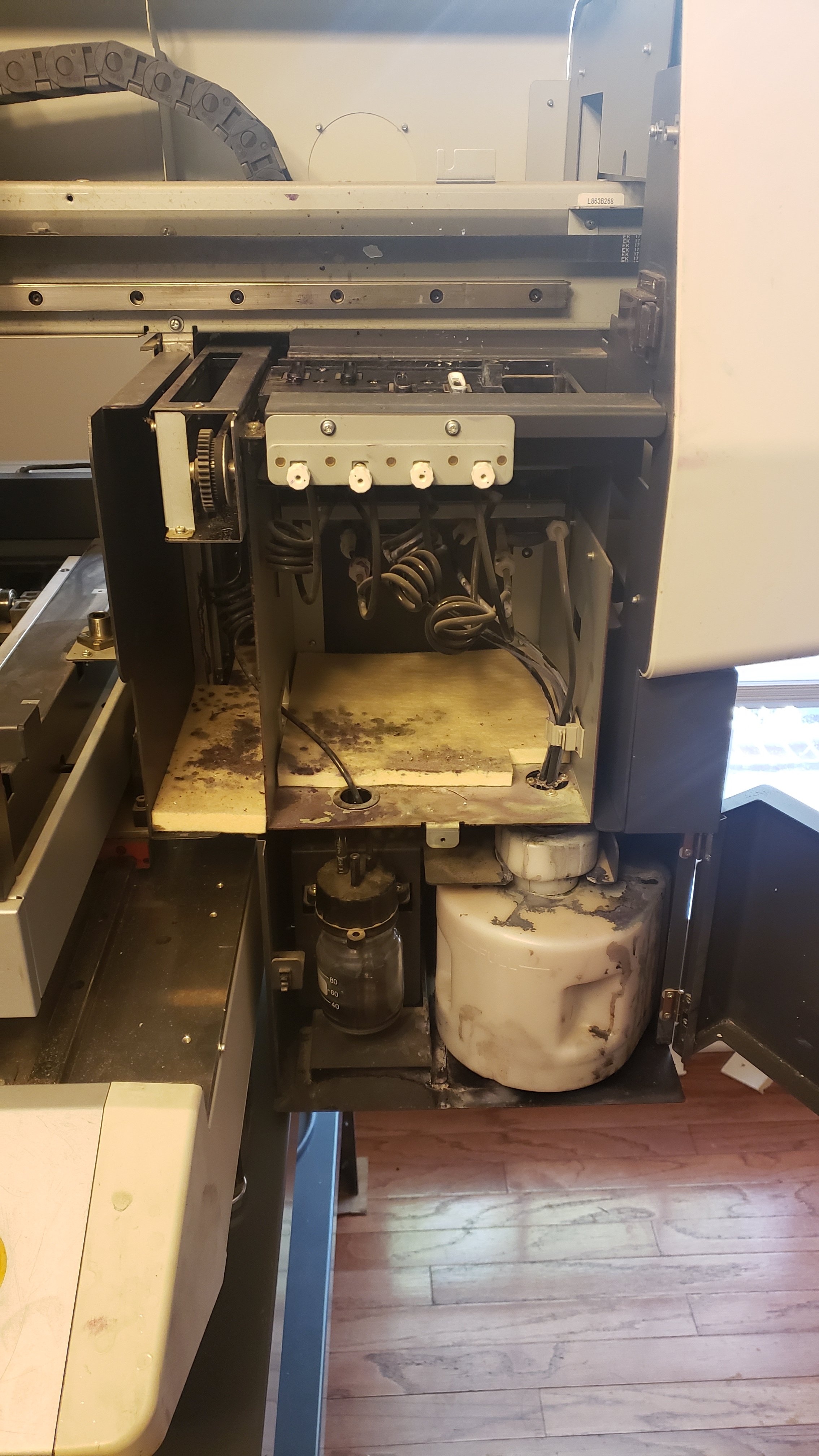

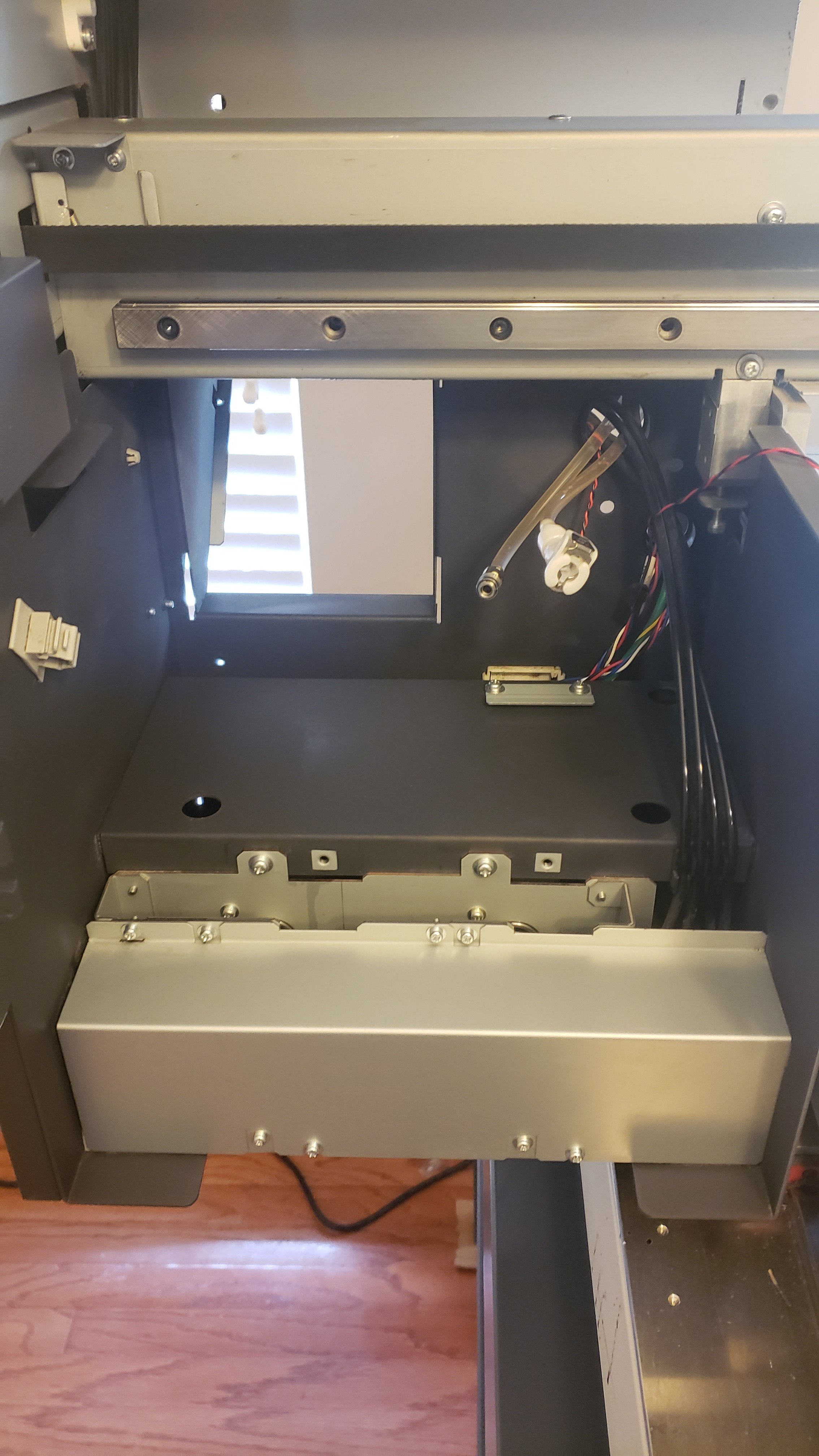

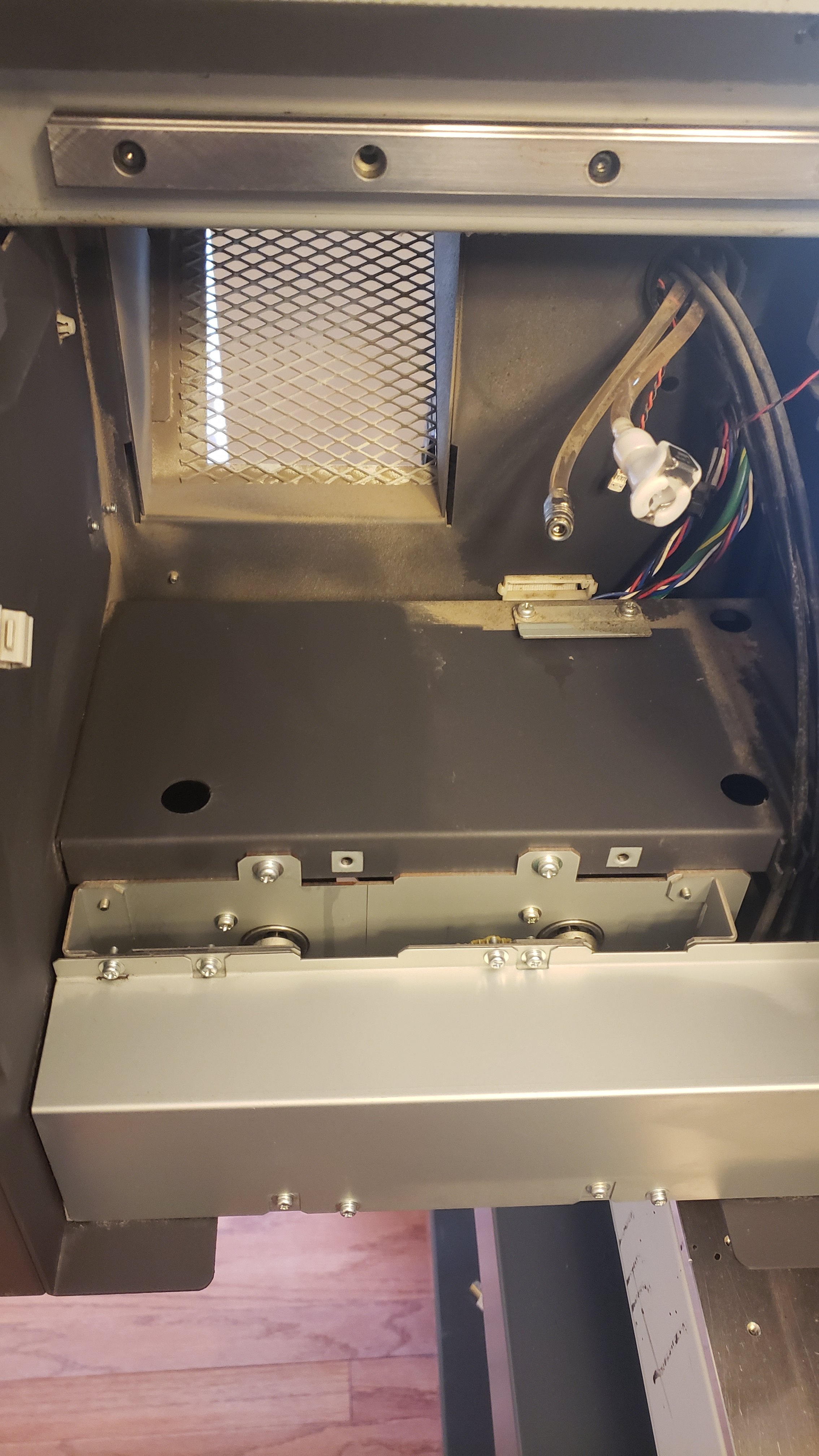

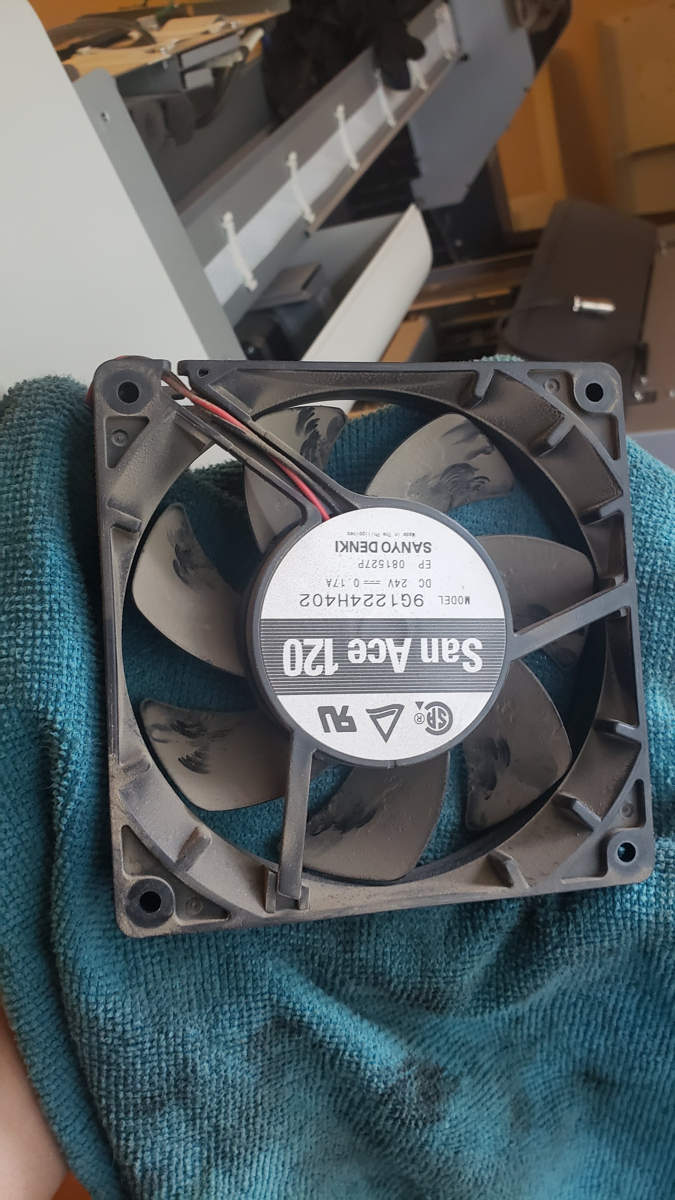

TD Digital

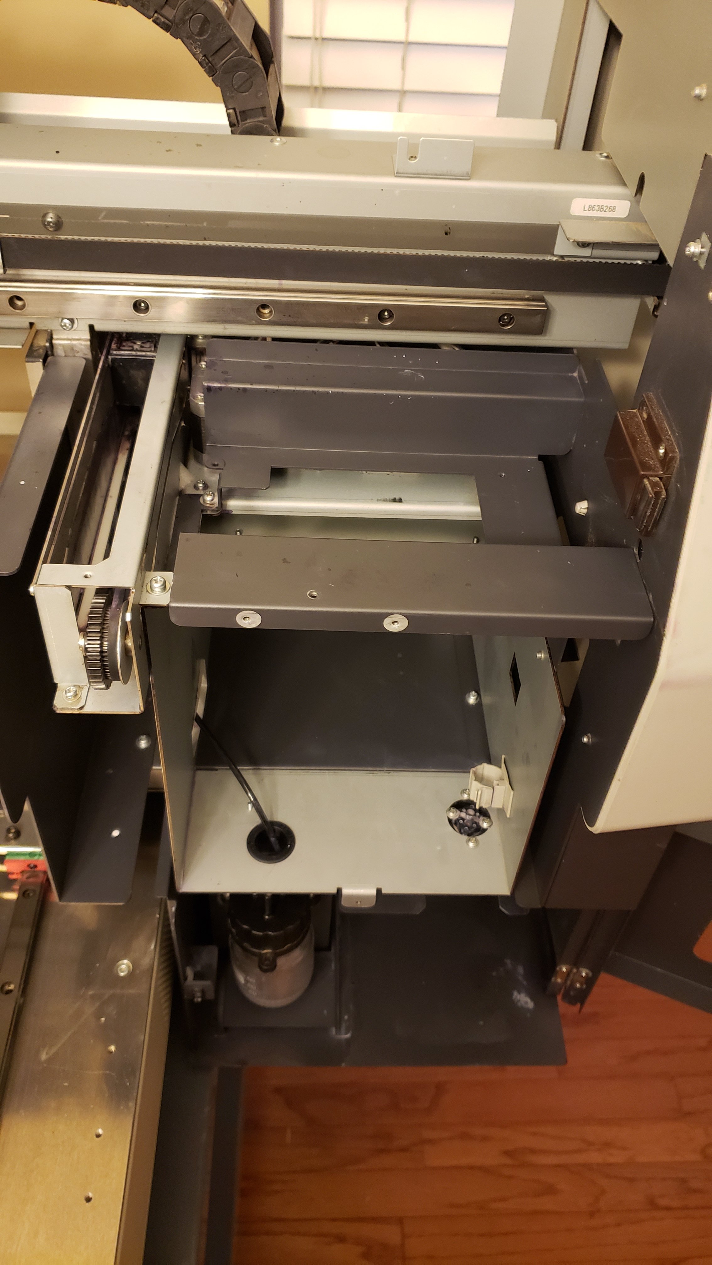

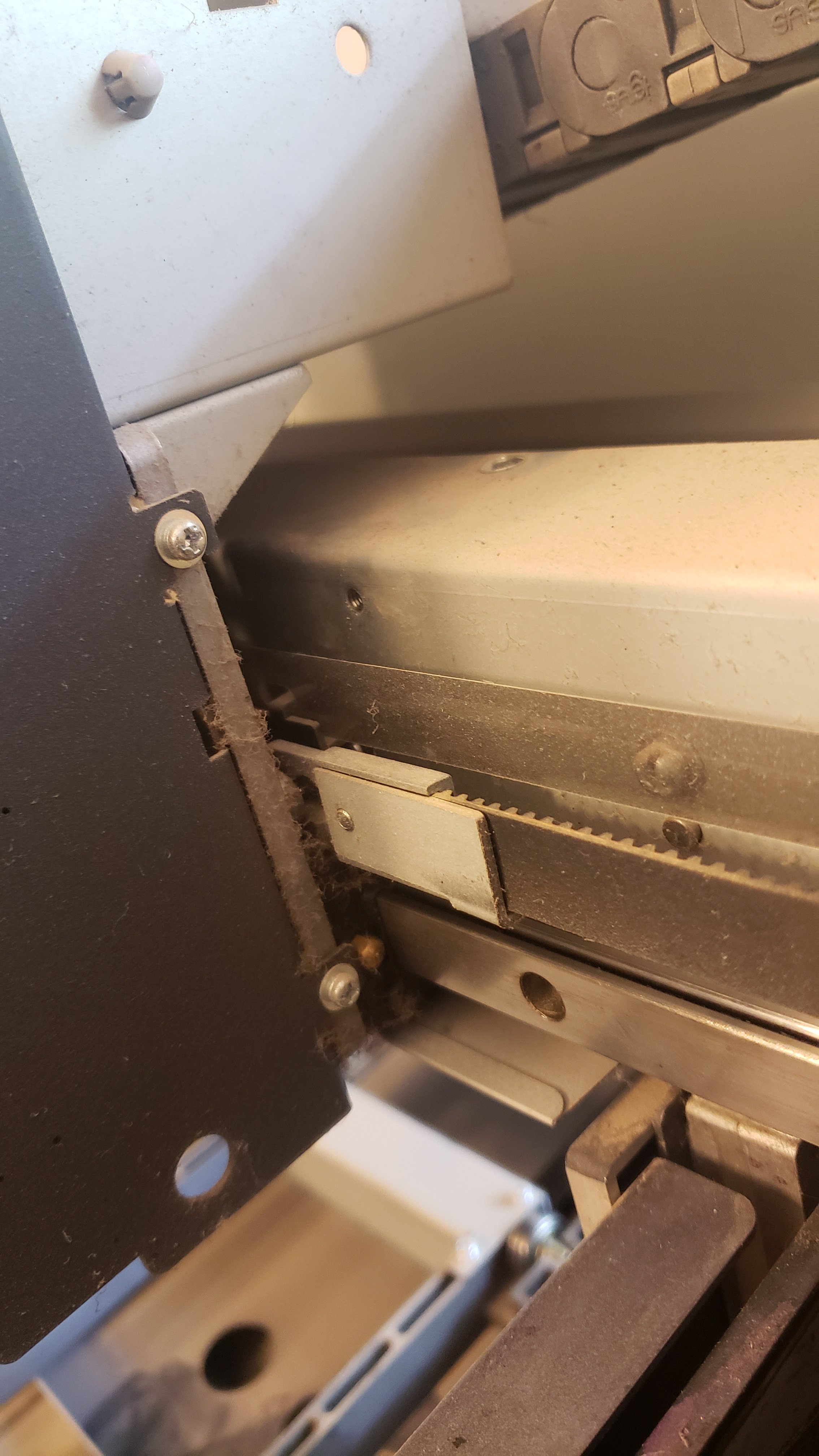

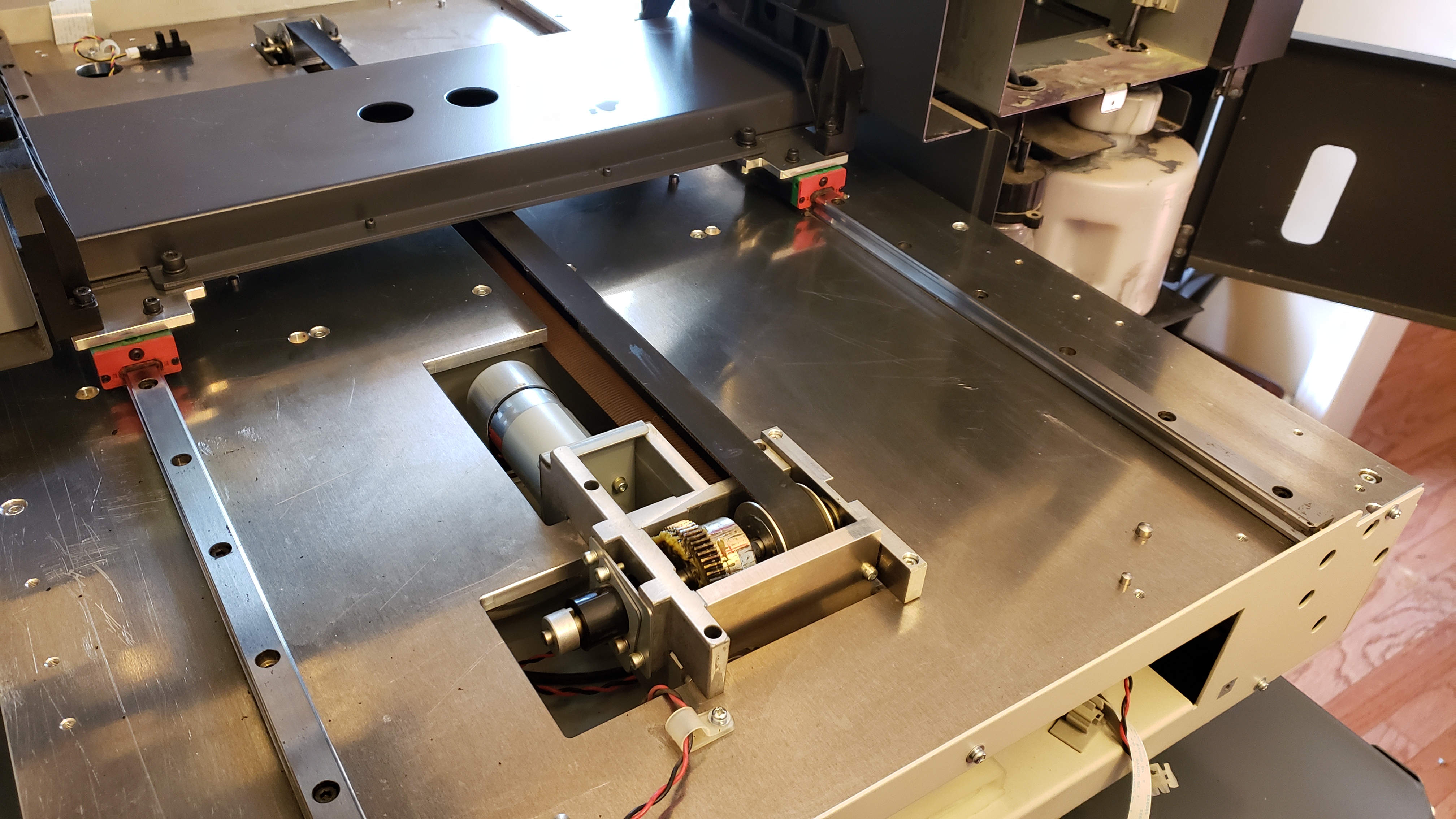

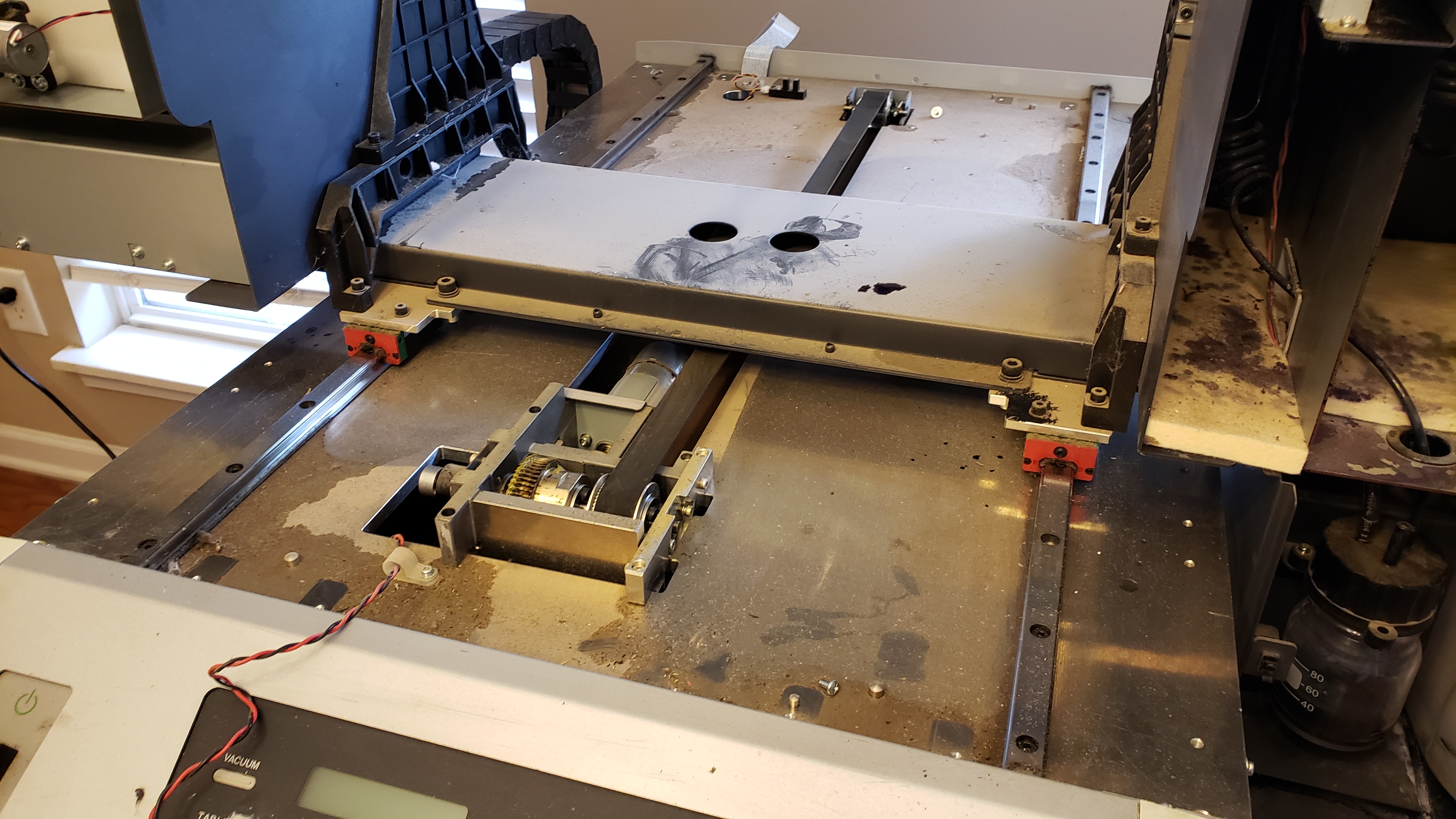

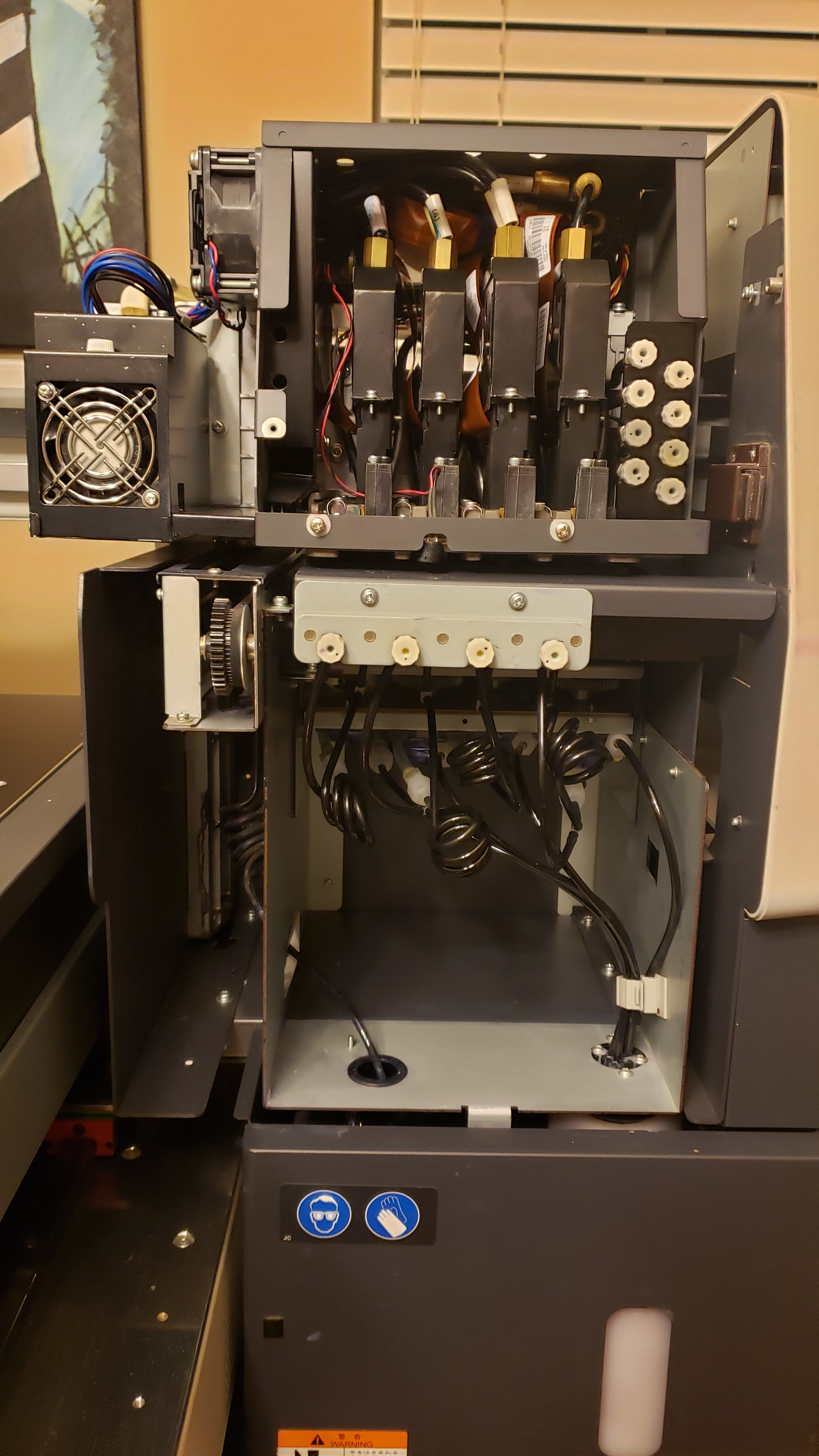

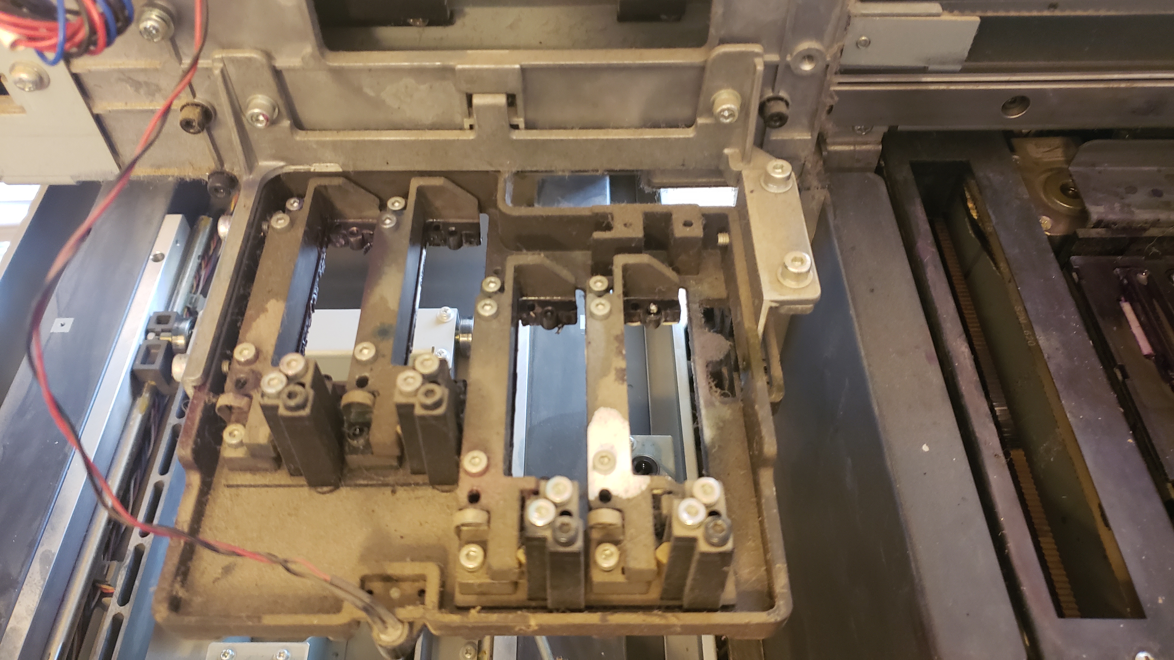

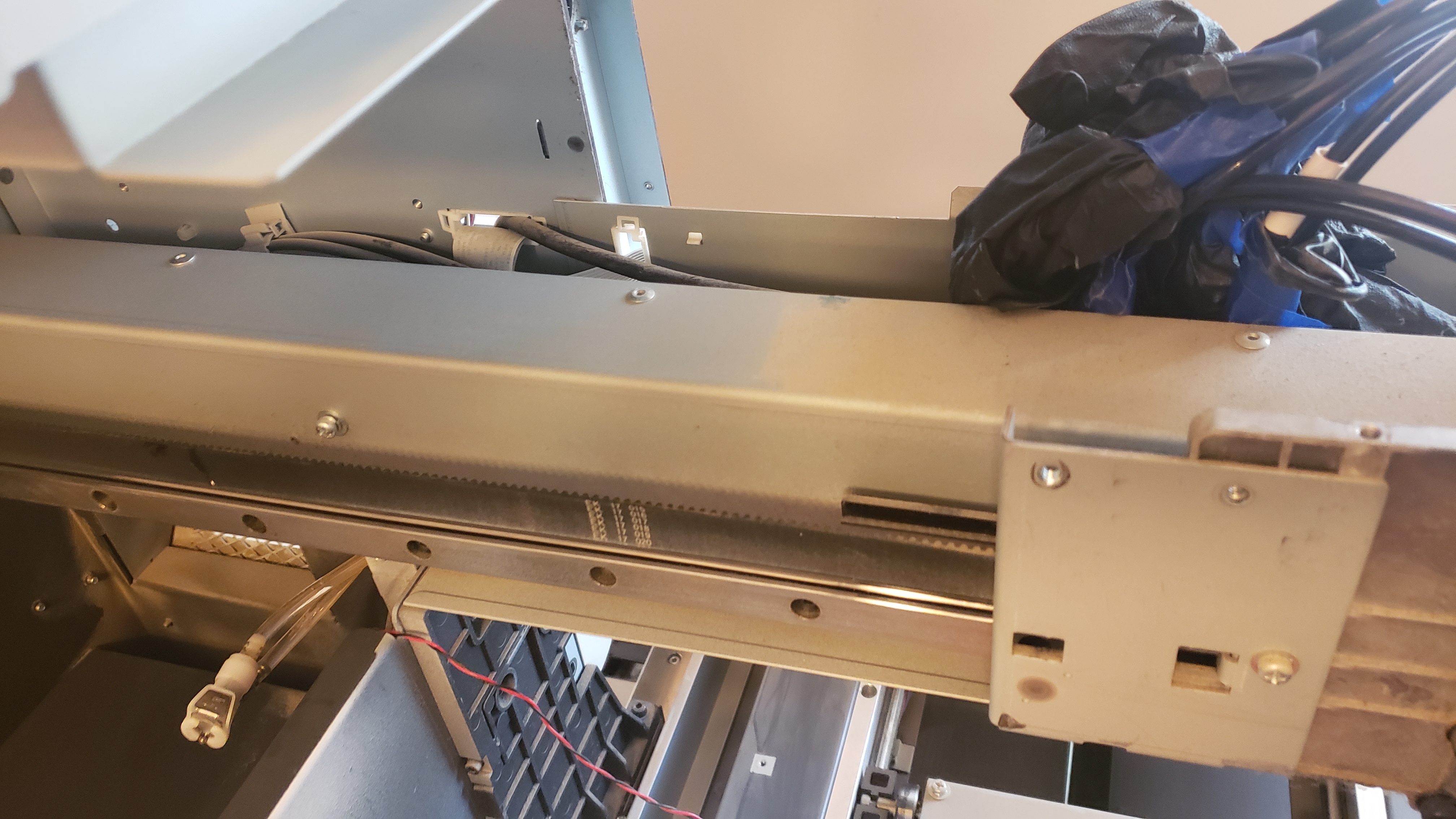

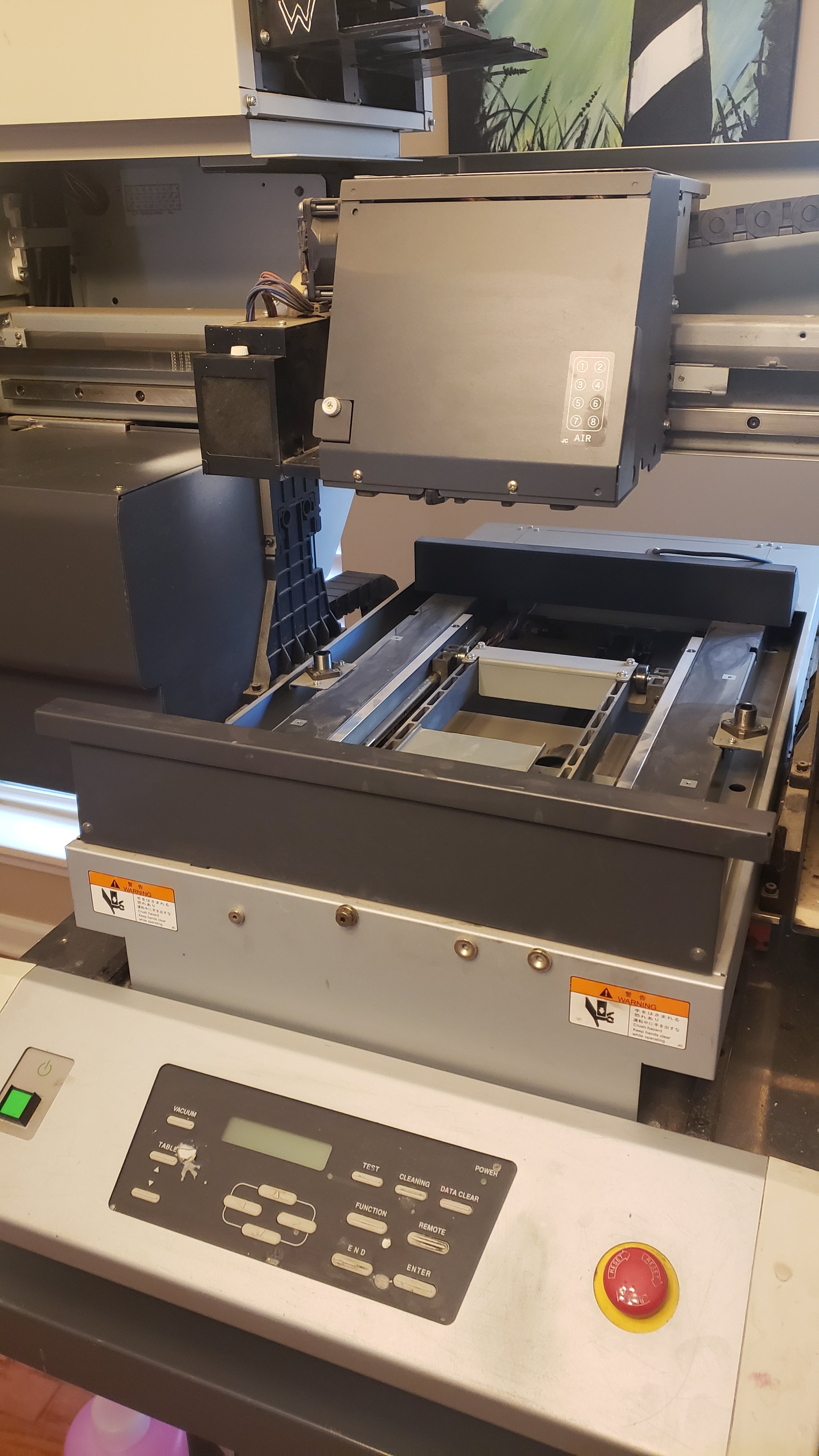

First step is a full deep cleaning. These printers are upwards of 8 years old in some instances and the dirt and dust build up is quite thick.

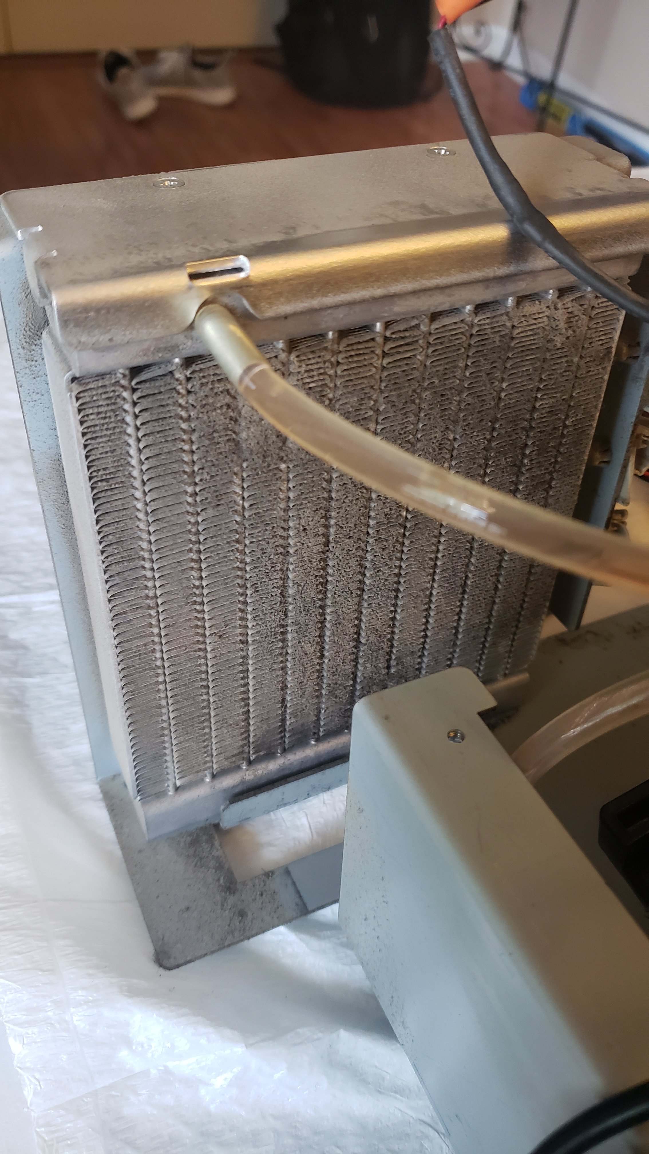

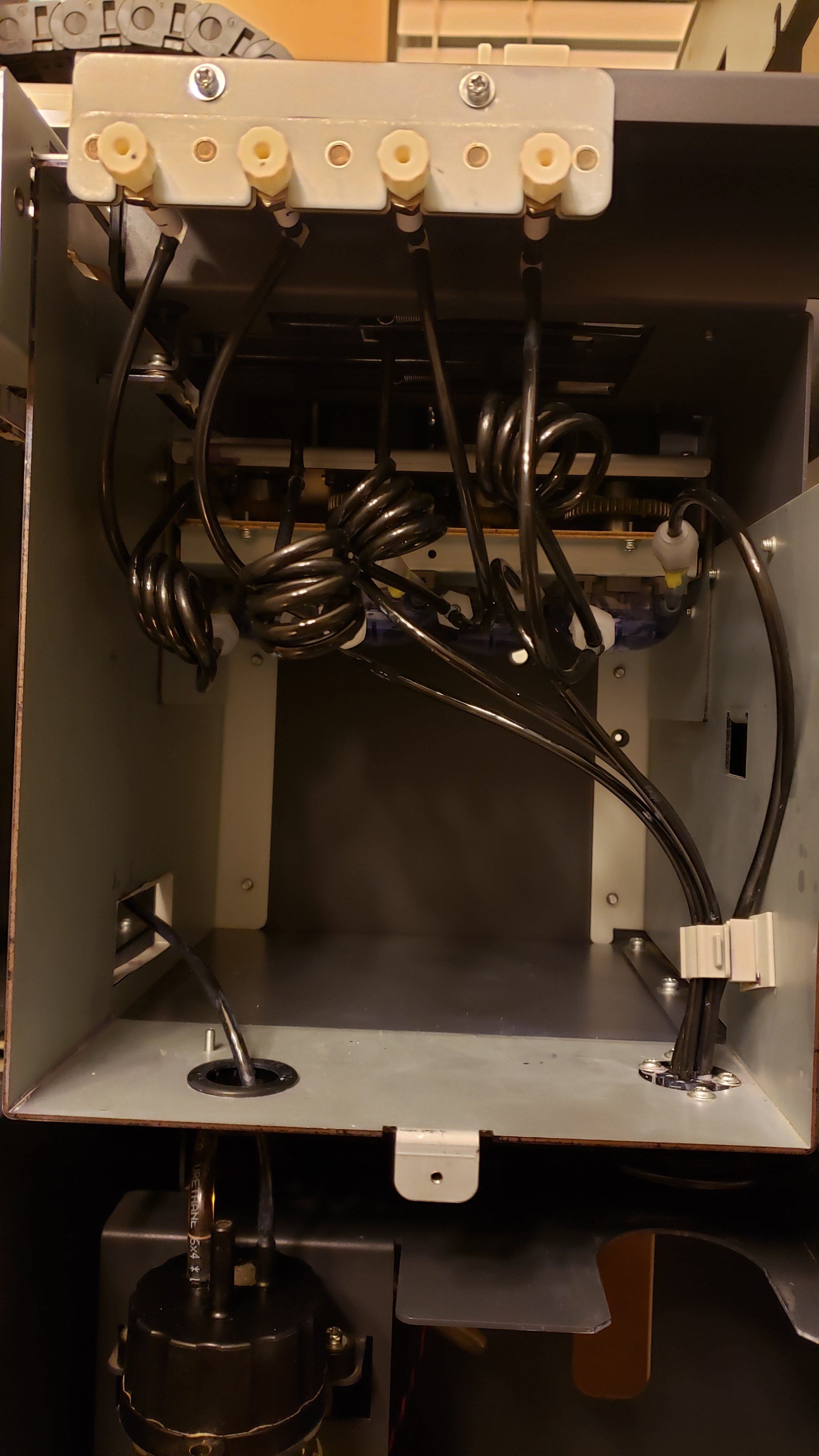

TD Digital
Full coolant station disassembly and cleaning.

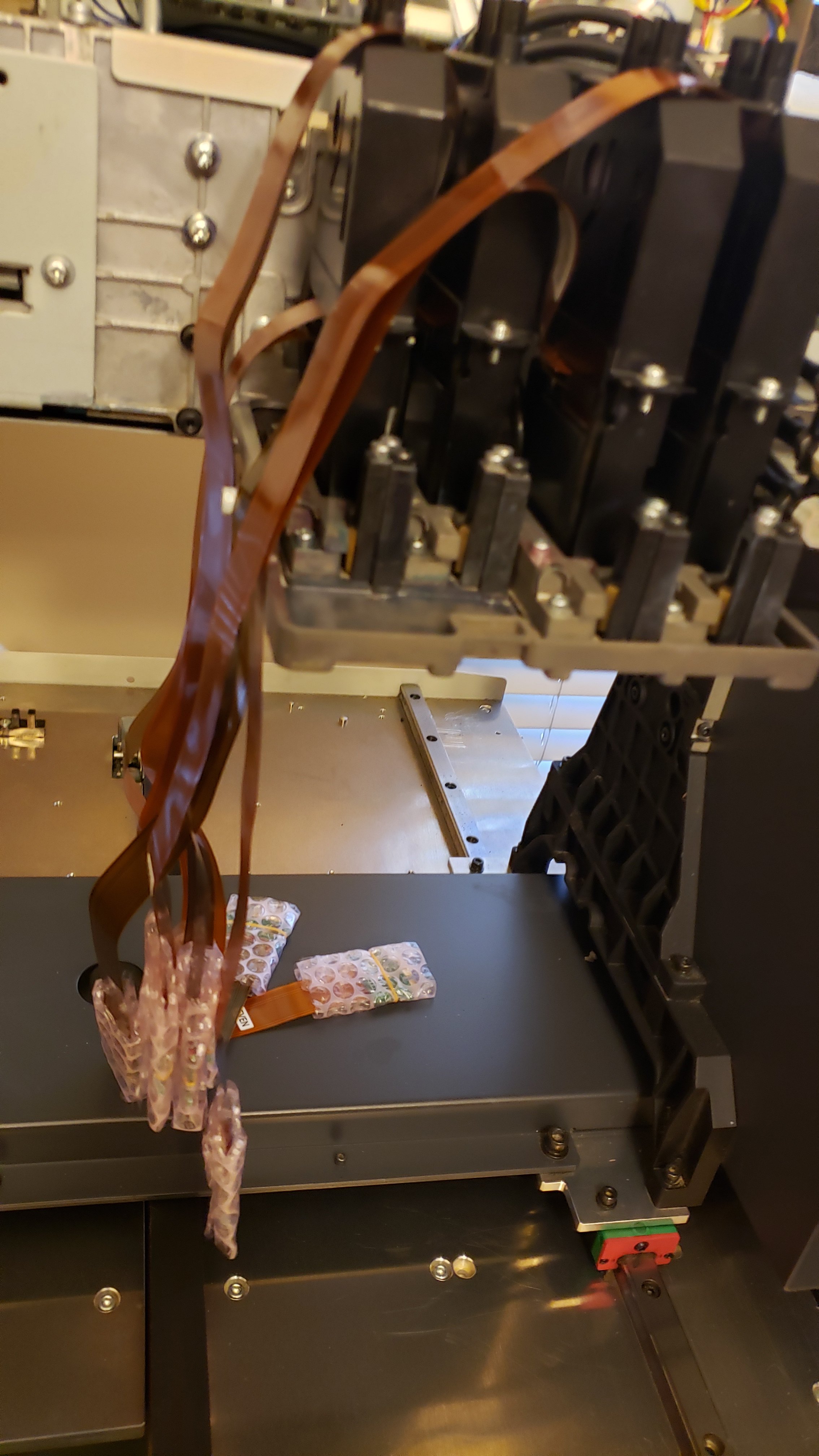

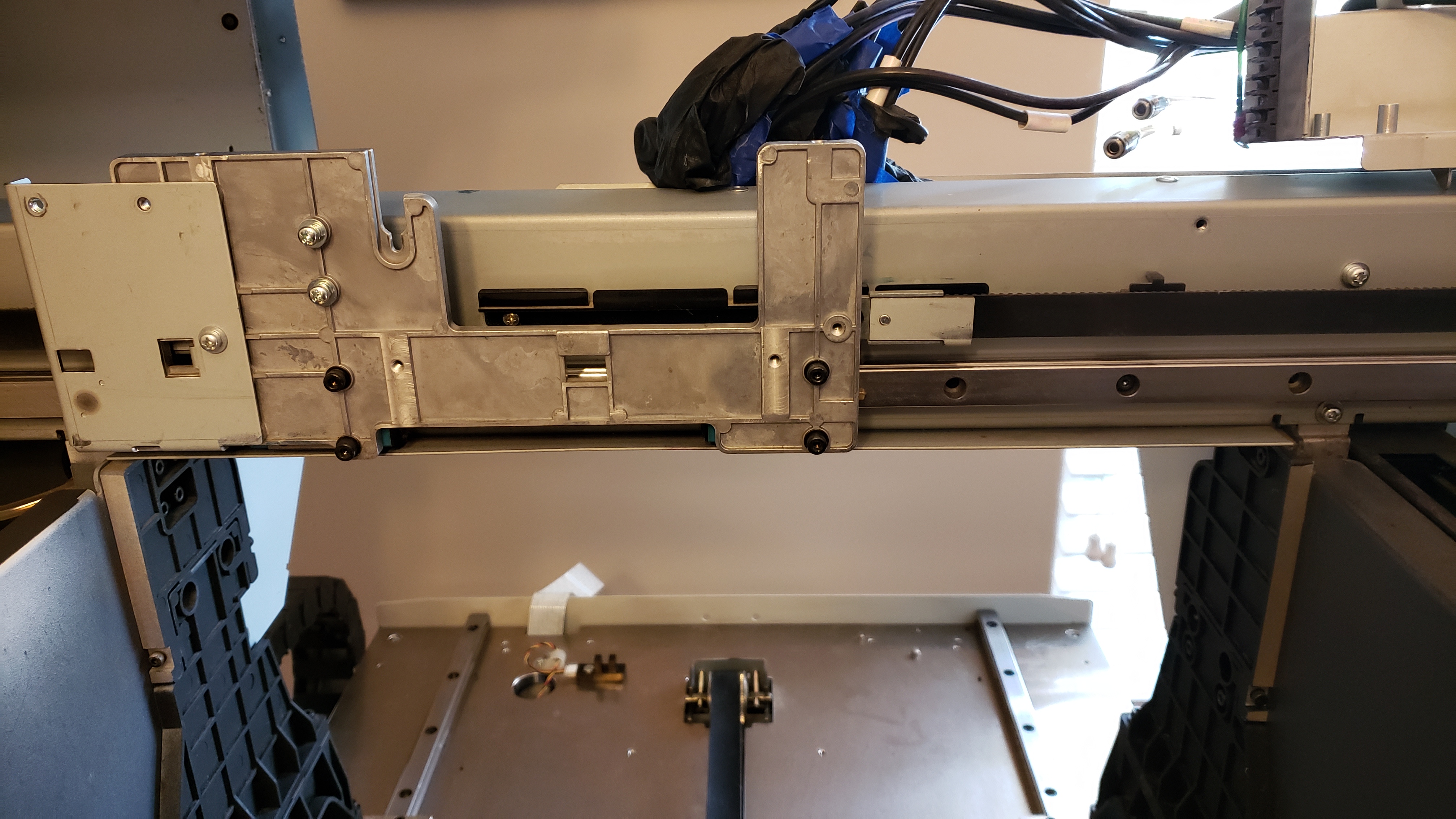

TD Digital

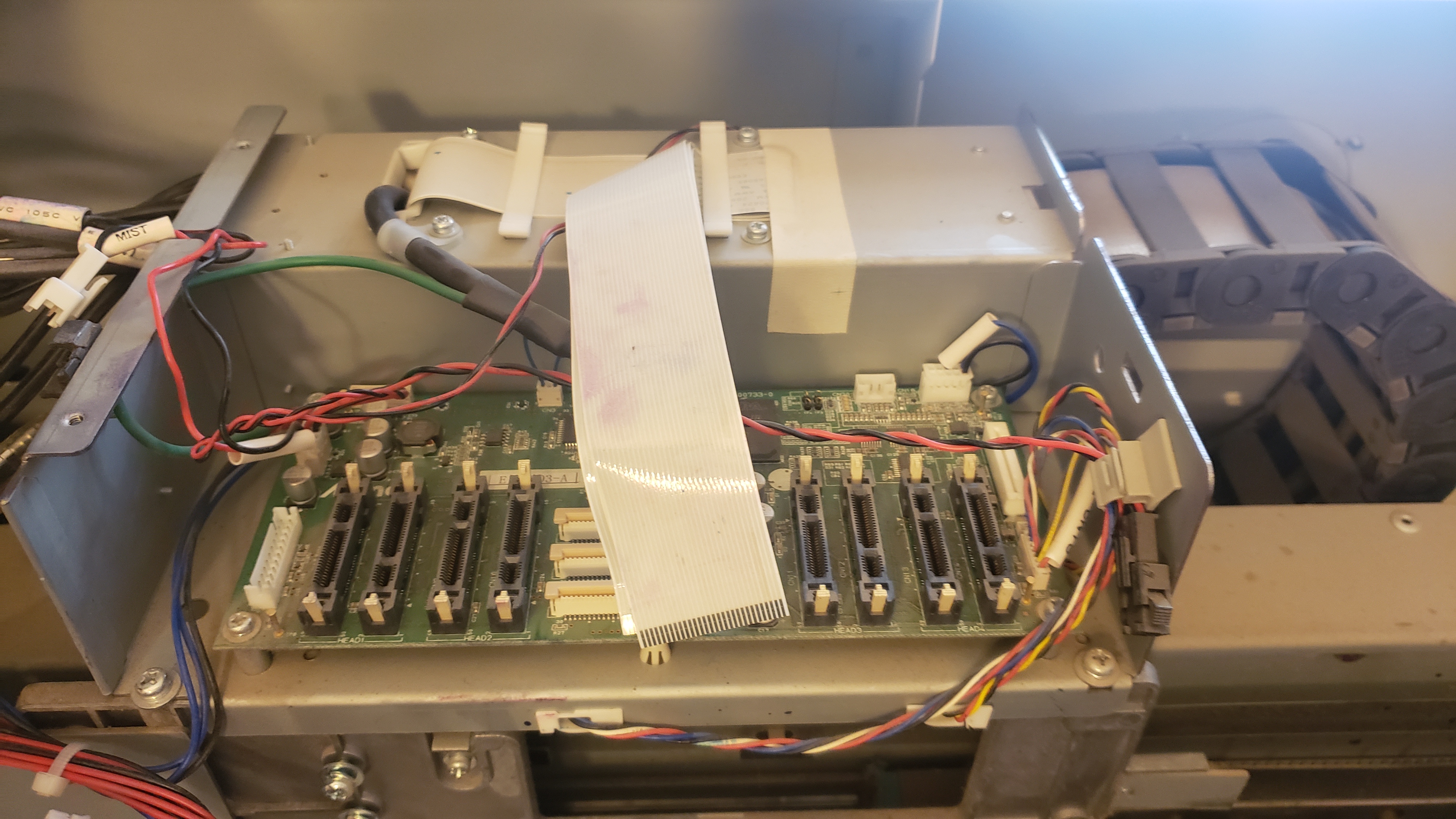

I will be replacing all 4 heads on this guy. Time to deep clean the head carriage

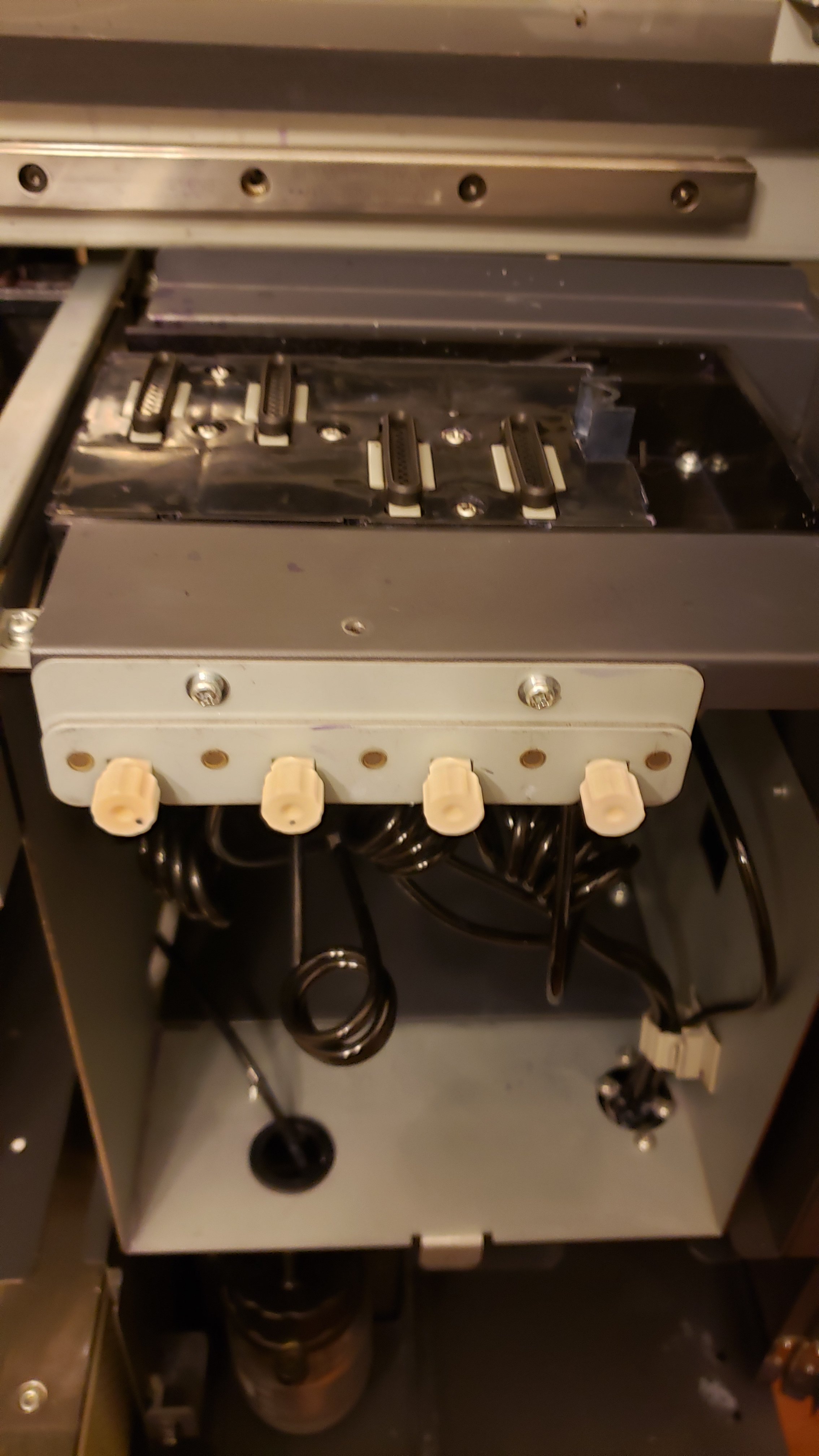

TD Digital
4 new heads, damper and damper adapters all replaced. Capping station fully stripped and cleaned.

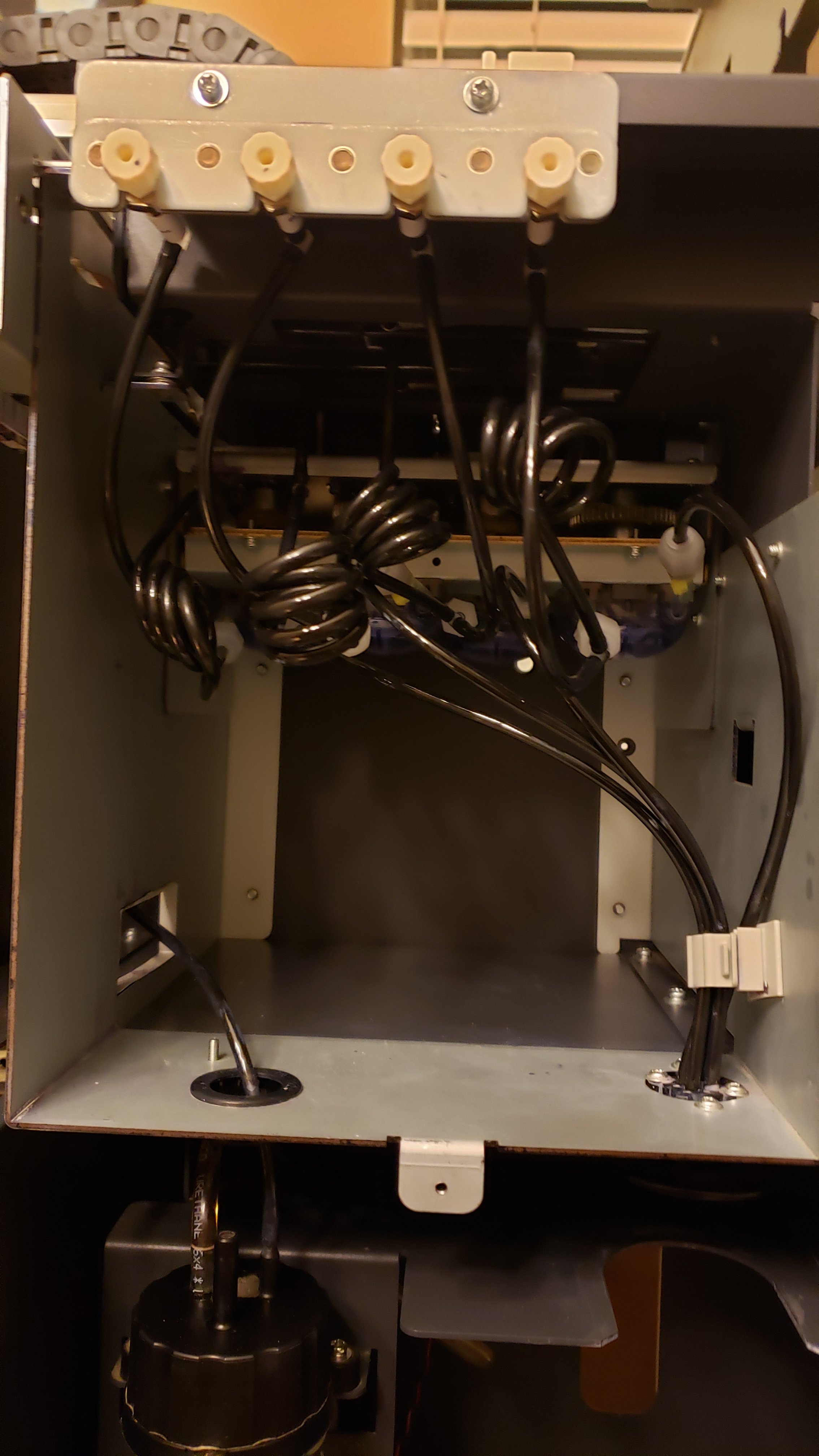

TD Digital
All new pump assemblies, caps and all coil tubes replaced with fresh new parts.

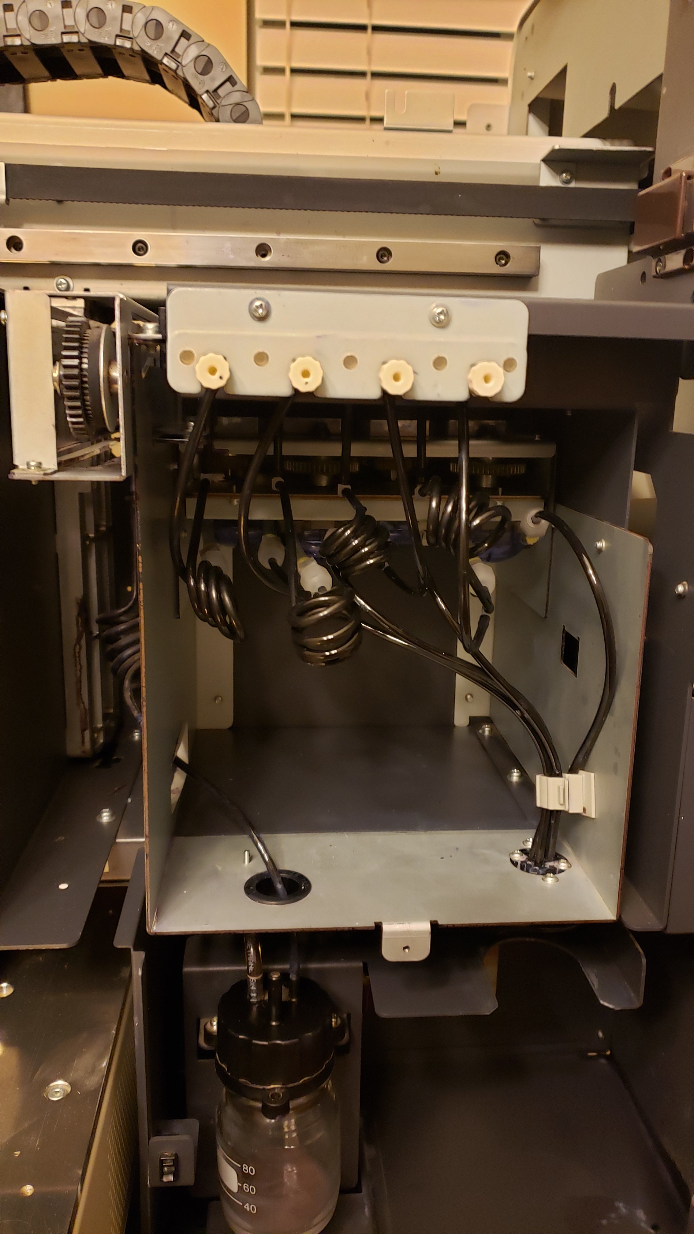

TD Digital
Head carriage all buttoned up. Damn this thing is looking clean! Control panel is the last thing to refresh. Vacation time but more updates in a few weeks.
