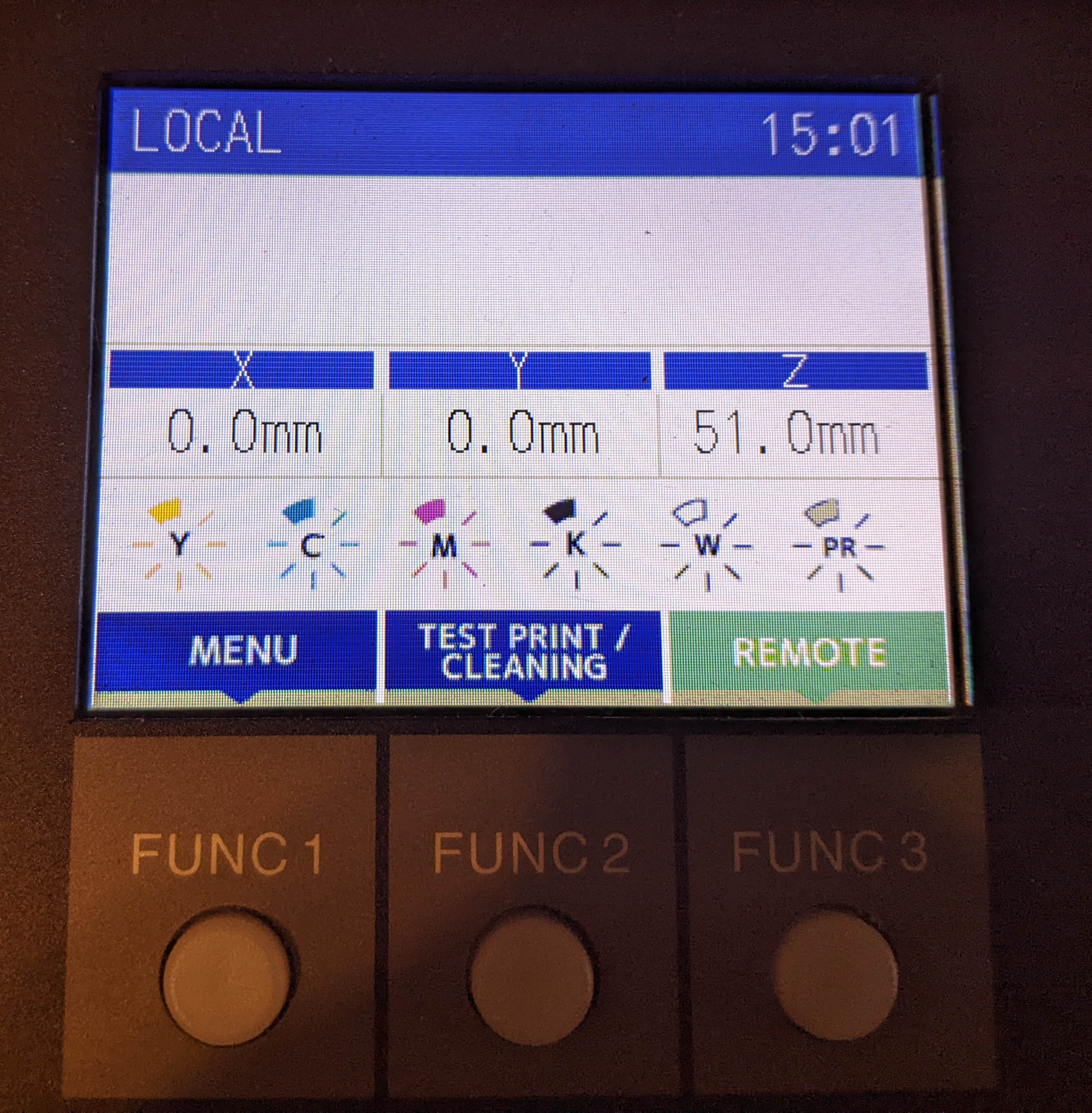

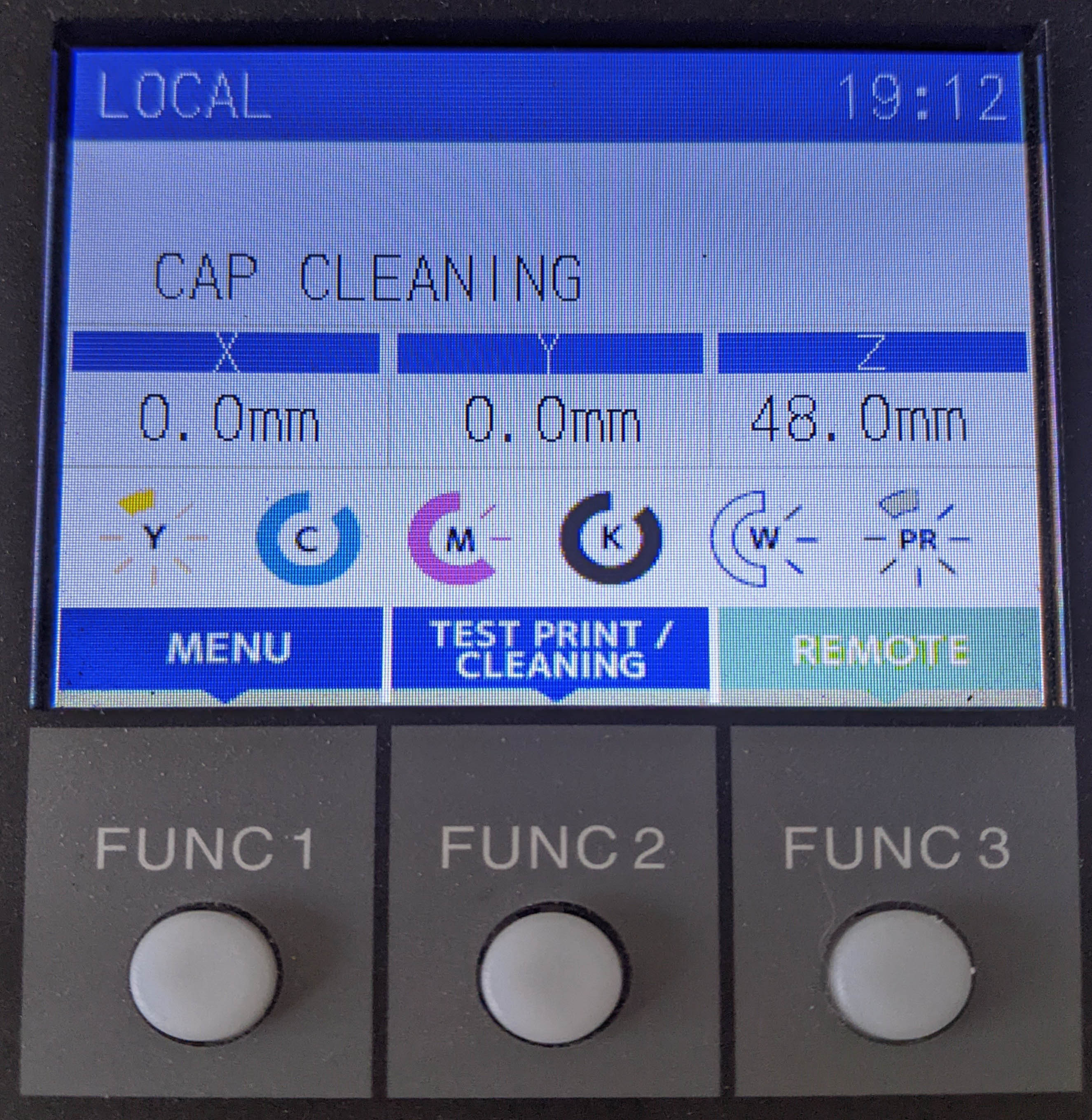

Got in touch with Mimaki and got the original parameters file. "Downloaded" the file onto the machine and went through the setup process. Didn't realize loading the parameters does a full reset of the machine. Once it was finished going through everything I made sure the auto maintenance was set correctly and then powered off. No change at all, except for the fact I have now supposedly used up a bunch of ink - which is not true. I took a picture a few days before that shows where the machine thought the ink levels were. I even weighed the ink to check and can see everything is fairly full. Hoping I can get new chips to finish using the ink I have.
New FULL Yellow (Including Ink "Cap" for putting in machine) = 380g
Primer = 253g
White = 281g
Black = 338g
Magenta - 303g
Cyan = 341g
