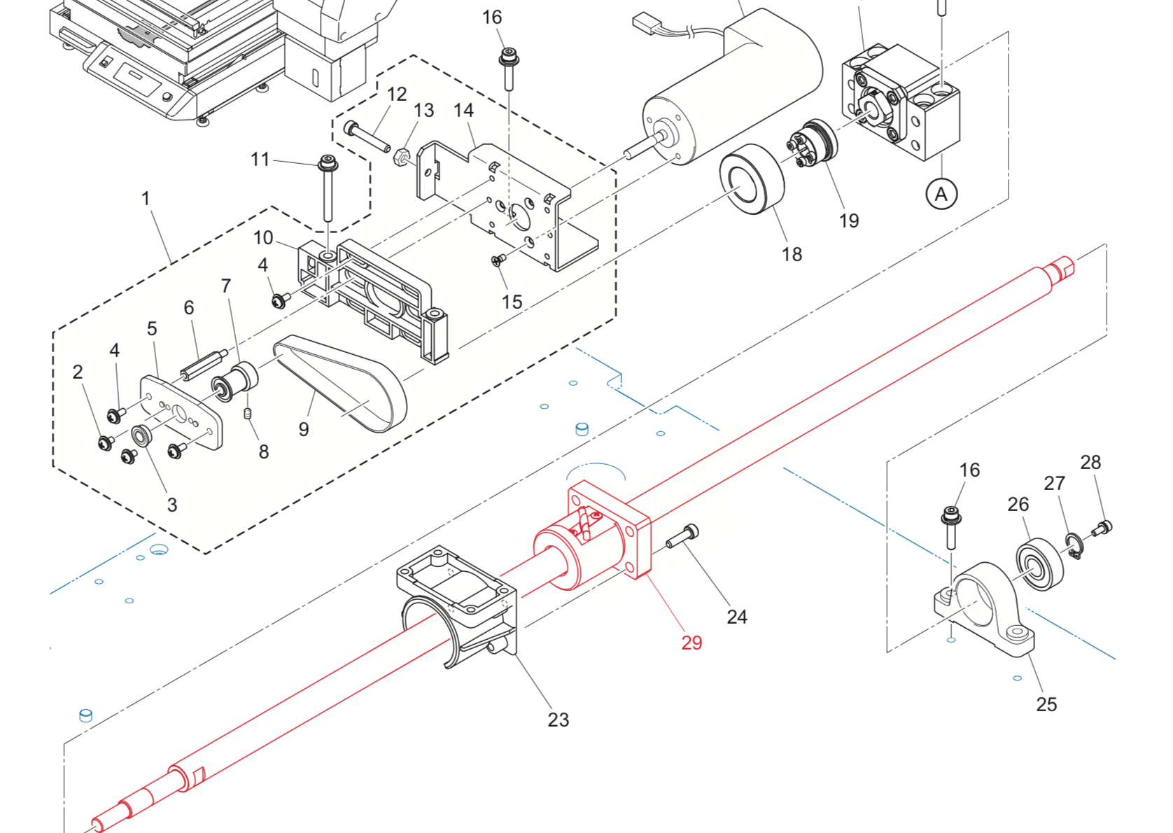

I am going to clean and oil the side rails, and also clean out all the grease on the linear bedscrew the X motor drives. Then relube it with Mobilux EP1. My thinking is as the X motor rehomes the carriage it's either hitting a tough spot or getting some resistance near the end deceleration, which is either causing it to overdrive the motor or make regenerative power. Hence the X CURRENT error only on that spot.
Additionally, I may move the origin down the bed 3 inches to prevent the carriage from having to travel on that part of the rail if there is a rough spot. Wouldn't prevent the hard deceleration though.

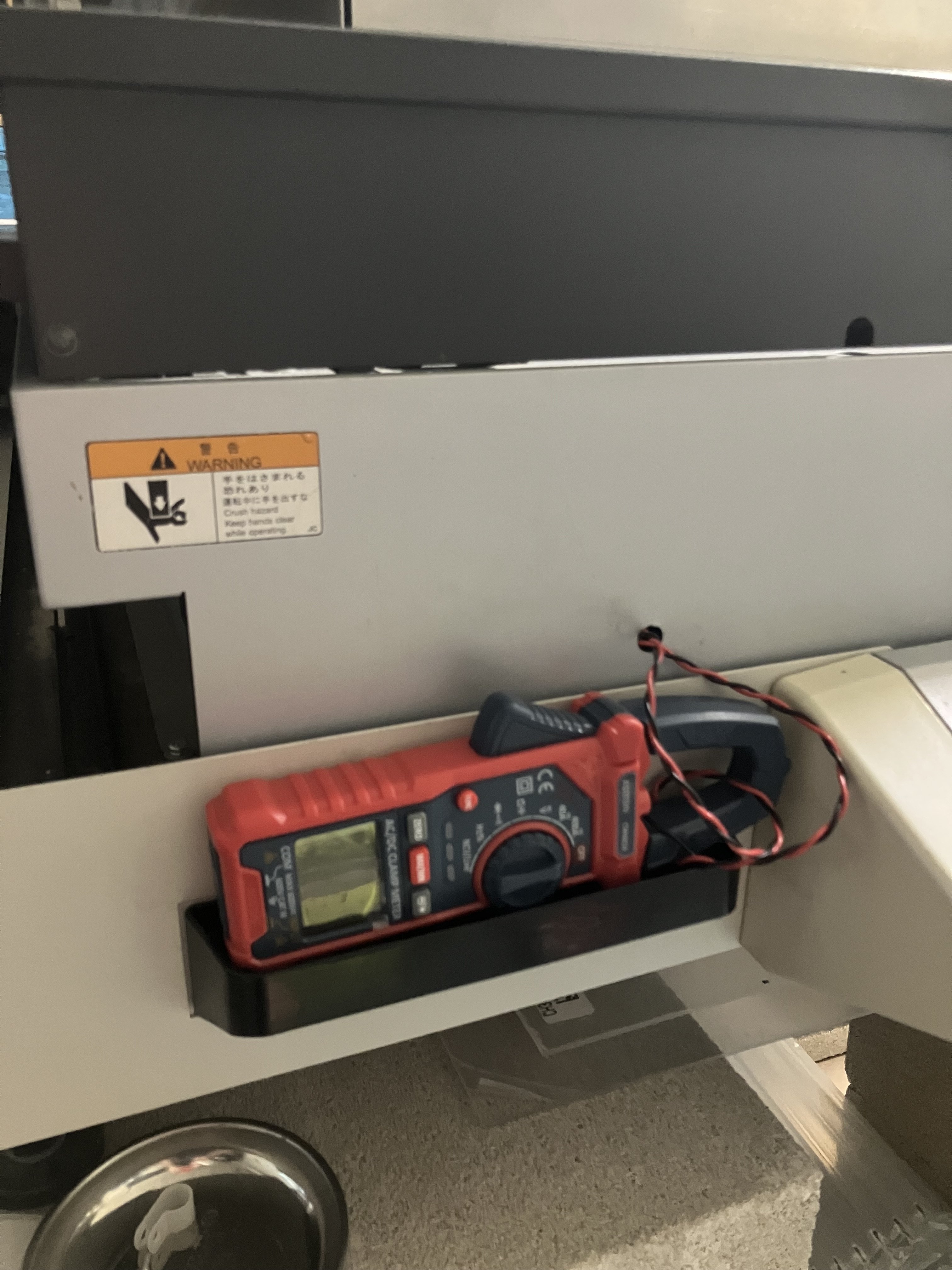

I have another spare motor, power supply, and mainboard ordered in any case. My plan is after cleaning put a new motor in and jumper the cables to a voltmeter and just leave it running to see what voltage happens. Motor is rated at 24V so anything appearing on the lines over gives a clue. If that fails again all I can think is change the mainboard/power supply.
