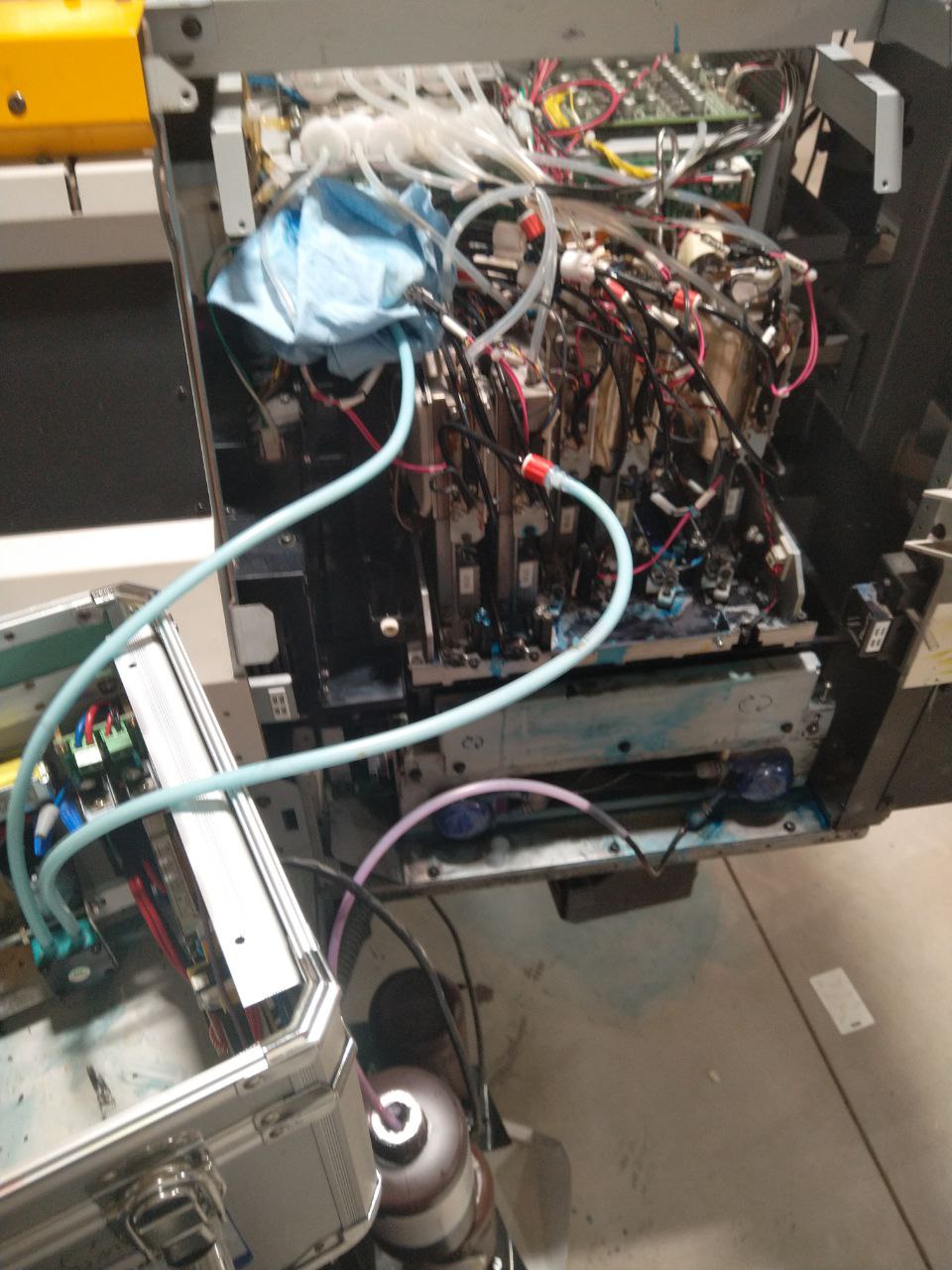

1) Capping station, just a plastic tray, caps just drain straight into a pan that then goes into the waste tank. As far as I can tell, no real point of this other than catching drips.
2) Drips, holy hell, so much dripping ink. There is ink ALL over this stupid printer and only 2-3 absorber pads to catch some of it. It drips into the frame, it drips onto the sides, it drips all over the floor. This thing craps ink all over the place. Even the 48V power supply had a nice coating of ink ($1500 to replace should it burn out, but lucky on that front so far.)
3) Ink bottle stations in the worst possible place and off the worst possible design. 2 monster umbilical lines coming off these chonky units and they're basically floor level. Definitely would benefit from a nice clean top-left mounting.
