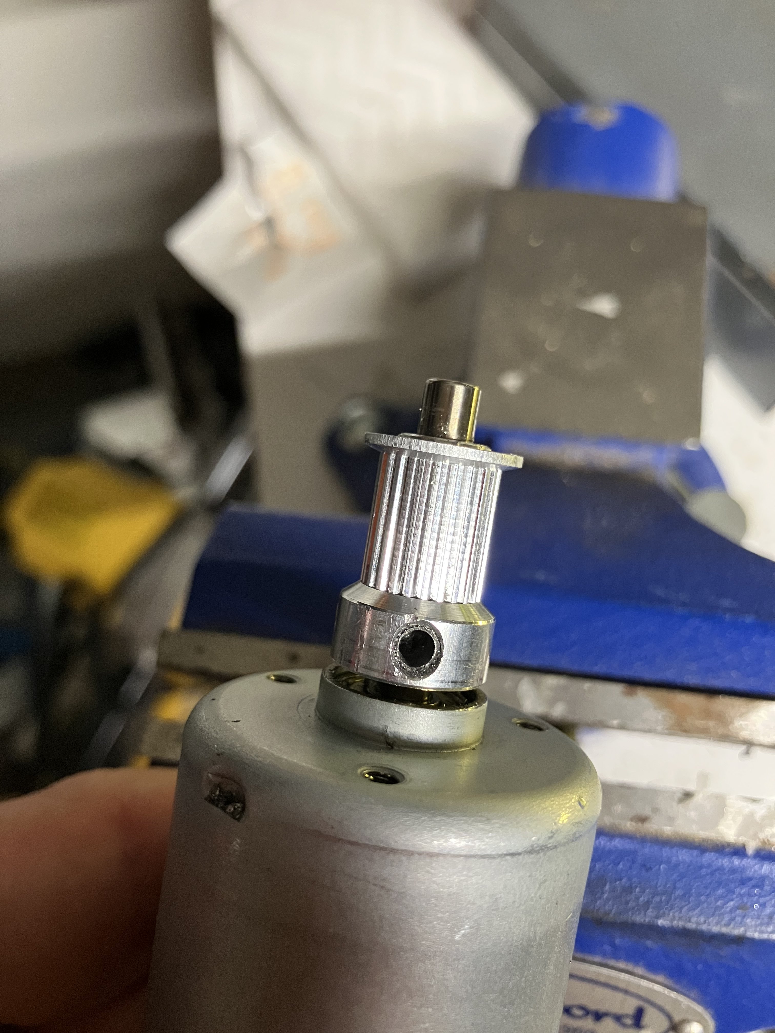

So I have a spare bare E300532 motor coming tomorrow but no way to get the drat pulley off my burned out motor.

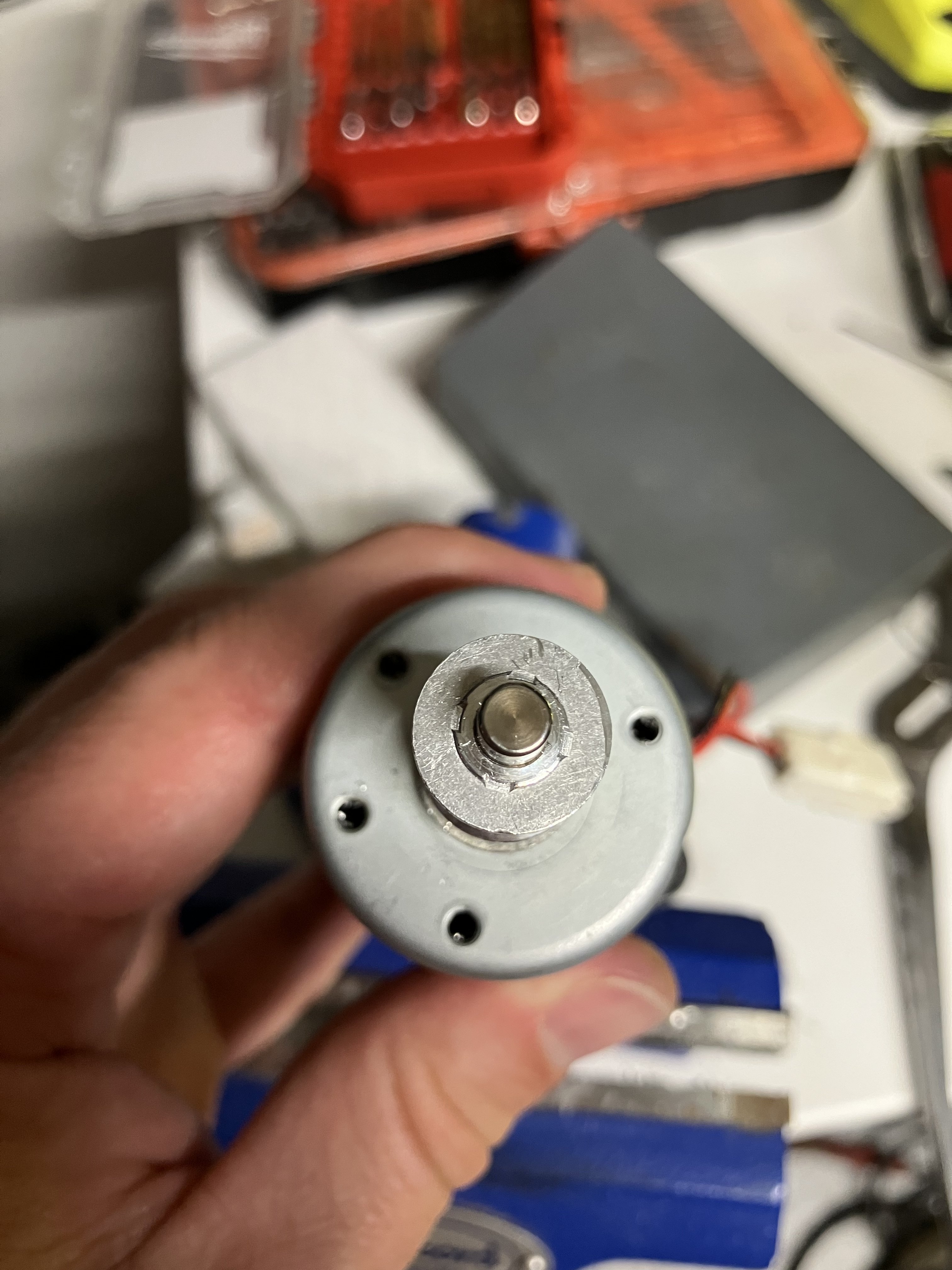

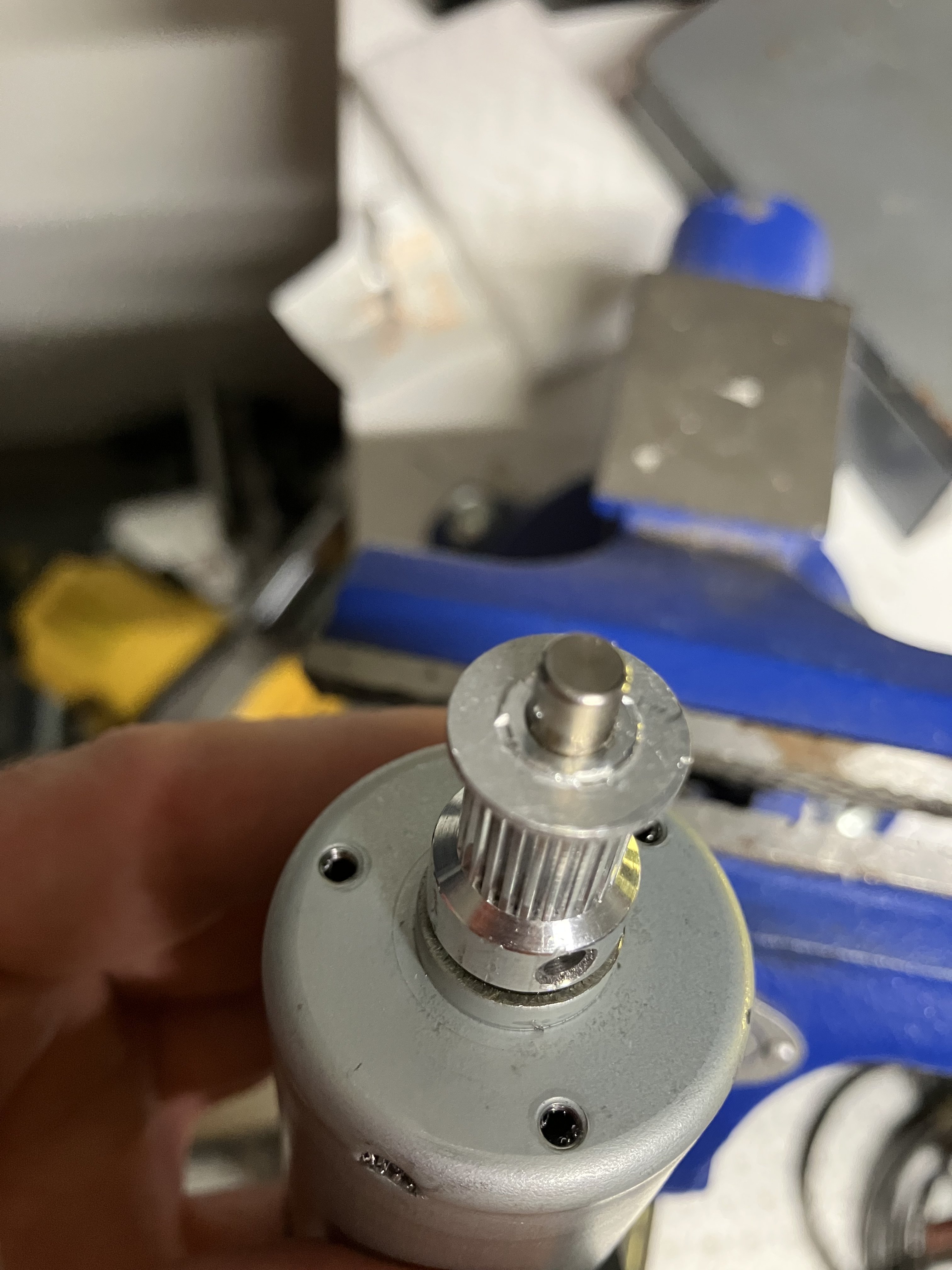

I have drilled out the set screw, and can get the shaft to spin free from the pulley - but now there is some kind of retaining clip holding the shaft in place. I think it's built into the M207793 "TN15-24 pulley" itself? Anyone know how to pull this thing off?
