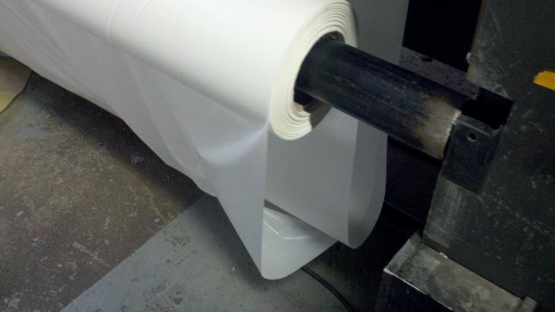

Buying my material thru N Glantz and they have been fantastic for me. They are here in Linden where my shop is and its a great thing!
Have been using Ultraflexx less and less now...and today just convinced me that they are horrible.
Been running a job of 8x20 mesh banners...using the 98in Strip Mesh on both 850 Latex and Solvent 3360. Of 8 rolls received, 4 were bad.
First roll, backer and mesh was Embossed...very bad factory roll job. Went thru 3360 ooh kaaay...not great but well enough that the job looked good and the mesh will flatten out when stretched on the fence.
2nd roll...Backer falling off the mesh on half of the roll.! pulled that off and threw it to the side.
3rd roll...Backer falling off the mesh After about 30 feet into the roll...ugggh. Used up part of the roll and threw it to the side.
4th thru 7th rolls were fine.
8th roll...same lot # as first 3. Kicked that off and had a "replacement" sent along with replacements of the other 2.
Now into replacement rolls....
2 are good. Different lots...ran thru fine.
Replacement of a replacement...same lot as first 3. :banghead:
Ultraflexx rep in just a bit ago...expressed my dismay about this roll being the same lot # and demanded a replacement immediately so I can deliver this job that just wont leave my shop!
Now, Glantz has to request an RMA...send THEIR driver to pick up the replacement...and drop it off tonite so I can print first thing in the AM tomorrow.
Apparently, we are beneath ultraflexx, which is 45 min away in North jersey to have them pickup the tab on a van and drive it down here.
Props to Glantz for helping me out :bushmill:
....a kick to the curb for ultraflexx.
