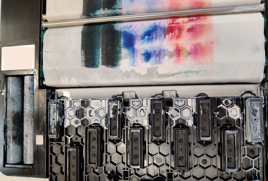

So there is a problem with my white ink recirculation. When it is going through its recirculation cycle it actually leaks white ink. The maintenance cartridge gets covered in white ink and because its so saturated it then gets all of the other printheads saturated in white ink. When I am printing throughout the day it is using white ink so it doesnt need to perform all of the maintenance it does when it is just sitting idle. Its during the maintenance cycles that all of the problems occur. So i was instructed to turn the printer off when I am done for the day, then turn it back on the next day when I am ready to use it. I almost exclusively print on substrates requiring white ink so I dont feel I need to take the white printheads out each day only to put them back in in the morning. As I mentioned before, these were the instructions given to me by HP technicians as a "make do" until my new printer comes in. I am happy to report that it arrives monday and hopefully I can get them out here to set it up during the week.
I fully expect the new printer to run with no problems. The more I use this HP latex the more I like it. It has its limitations and its issues just like any other printer but overall I'd buy another one if I had the work to justify it. I honestly think my printer was an earlier run before they got some of the problems figured out. The newer production printers are said to be significantly less troublesome.
I've seen it as well, too bad the new unit won't really fix it as it happens because of broken printhead. Well it will for the time being as it comes with brand new printheads... but I hope it fixes your other issues whatever you may have.
Next time you get it on your new unit, replace the printhead asap.

Well, our first 700w worked for a couple months until all of the ink lines leaked everywhere inside the printer. We were down for about 4 weeks. After that it was monthly, each time down for 1-2 weeks. At the 11 month mark I asked for a refund or a new printer and got a new one. It arrived new in box but did not work so we waited a couple weeks for the fix. It worked for a few weeks then started doing the same crap the original printer did.
The original purchase was through grimco and I notified them I wanted a refund. They simply asked that I put in another service ticket with HP so they could send a tech out to diagnose the problem. After giving them the opportunity to repair the printer I could decide if I wanted it or not.
I can say that the service provided by both HP and grimco were excellent up until I asked for a refund. They processed my refund but ghosted all of my calls during the refund process.
I now outsource primarily to signs365 and couldn’t be happier. They’ve been a game changer for me.
Looking back I probably would’ve spent more for a different printer…maybe a uv gel or something…idk. This was my first shot at printing and it didn’t pan out the way I wanted it to. If I get back in to in-house printing I feel like I need 2 printers so I always have a backup.
