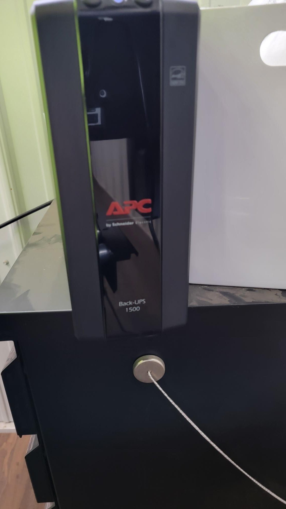

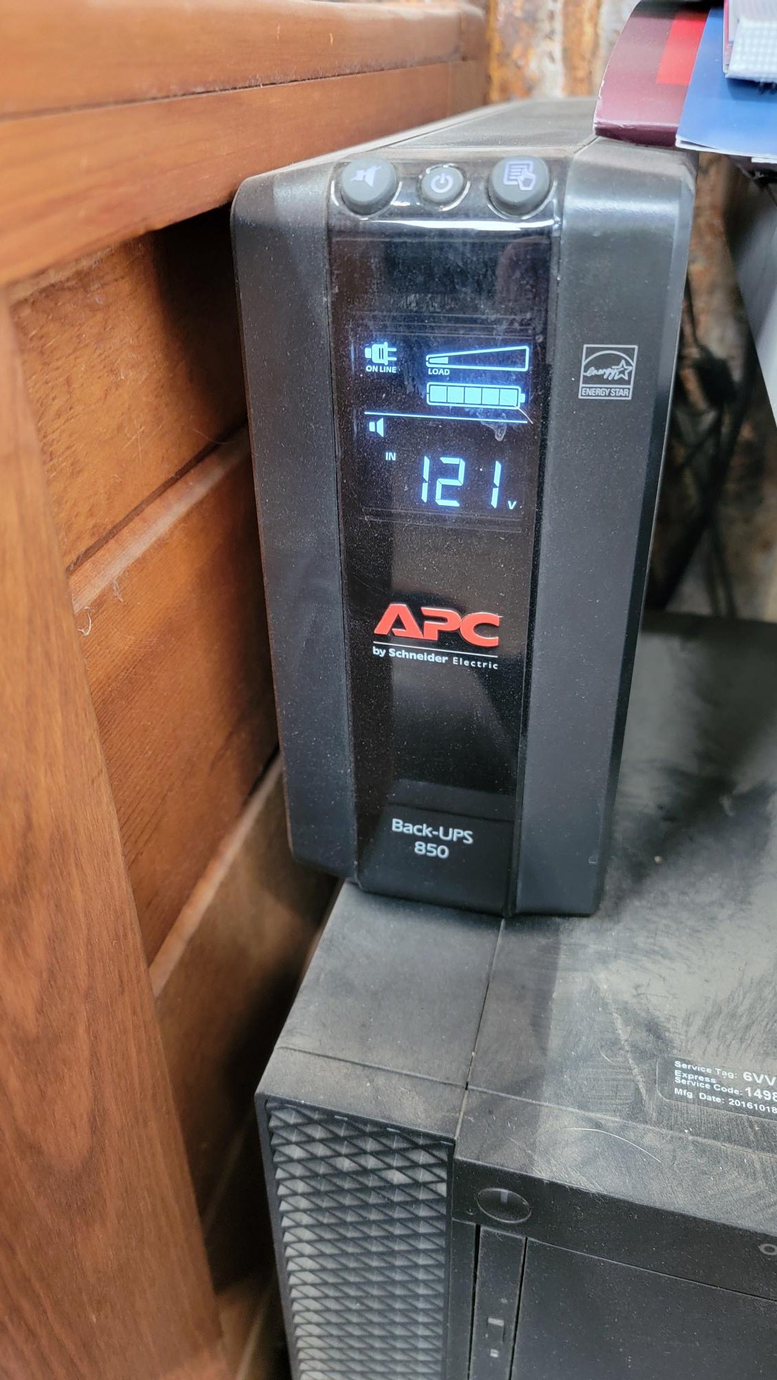

I've had good luck with these APC UPS's. I run an 850 for my server and computer and a 1500 for our Roland VG2-640. The 850 will run the computer and server for hours. The 1500 will keep the printer going for about 15 minutes while it's printing.

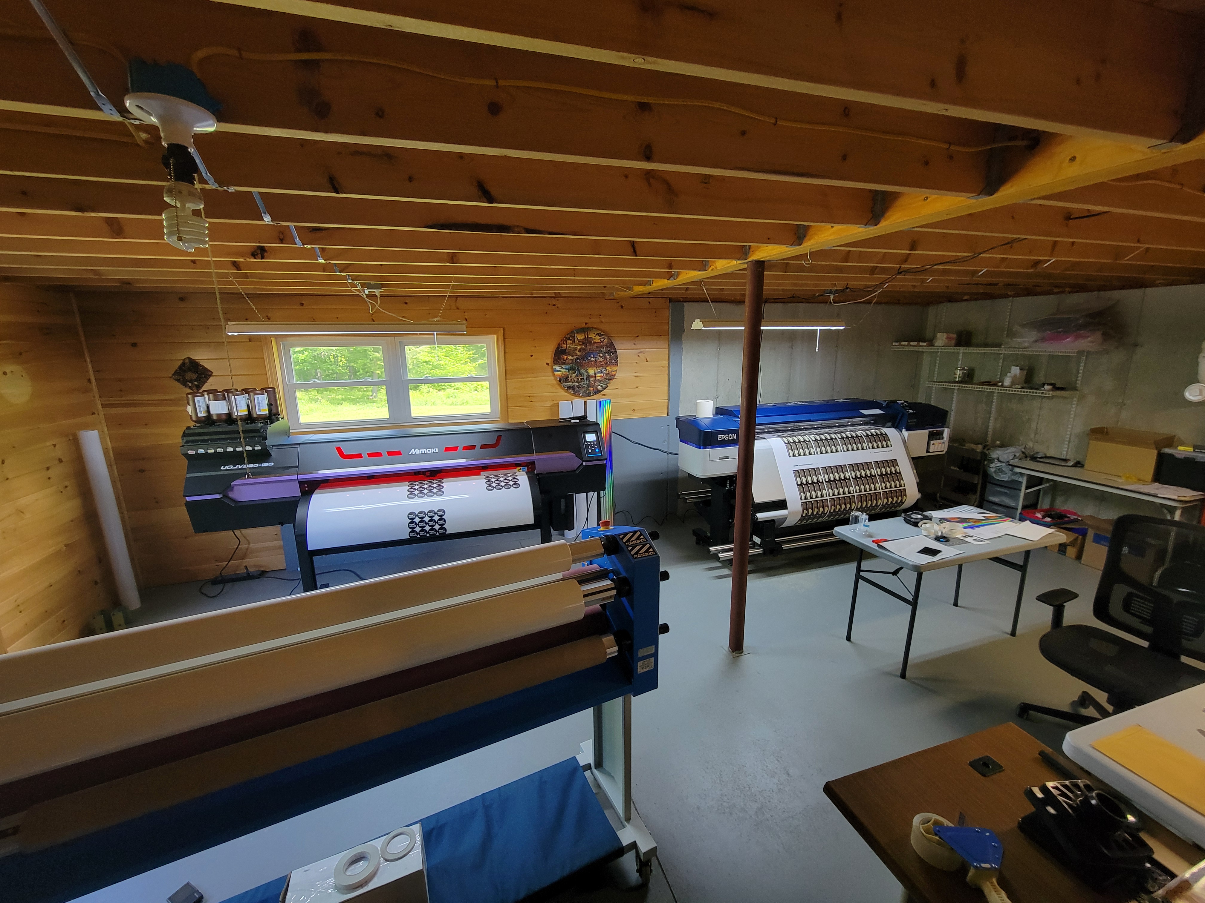

I was just looking for something that will last for about 5-10mins so it gives me time to stop prints and shut them down. I'm just a small guy here in a basement.

That's more of what I'm thinking of.
