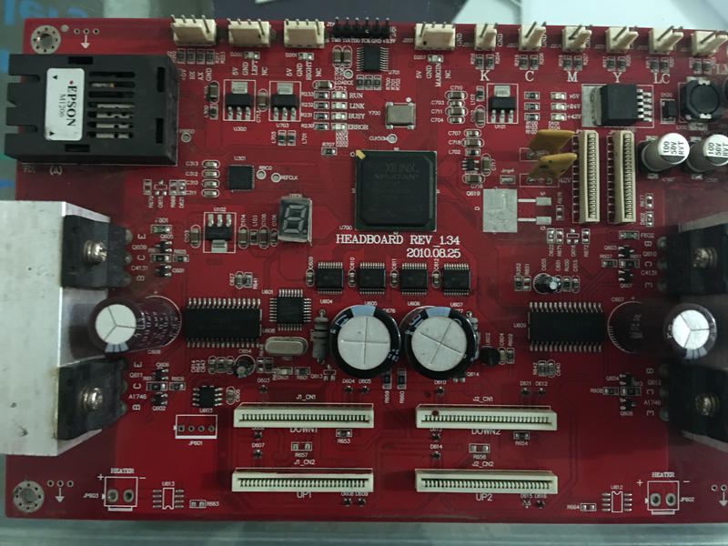

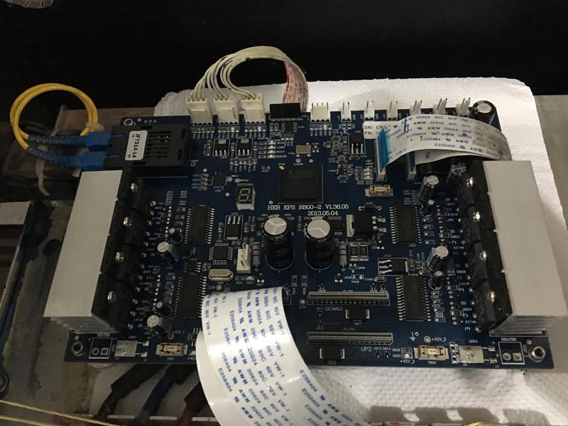

Today I changed the board to a new one. Changed all the flat (all new too) and the caps.
But the printhead still drop all colors. The 2 printhead have the same problem.
The old board
attachment.php
The new board with new flats (the model of the board is the same, changed the color but is the same board. Work perfectly except the printhead).

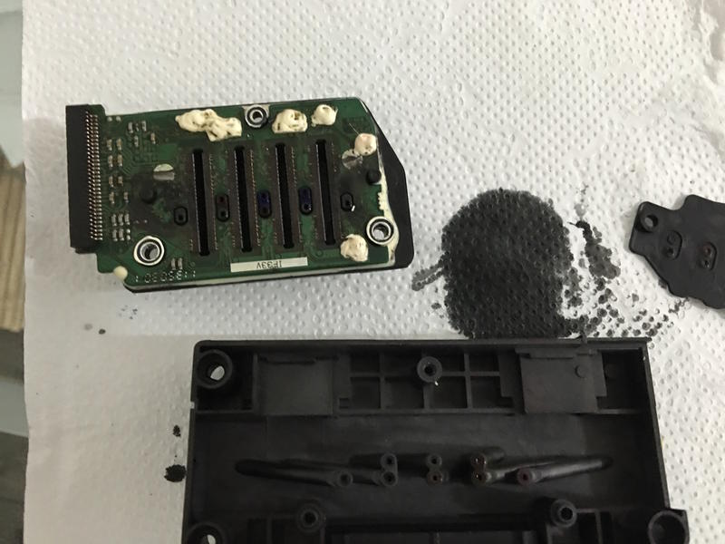

A technician told me to open de printhead to clean the little board inside the head with Isopropyl Alcohol. After i closed it, I used a cleaning solution to clean the bottom part (gold part), because the one side of the BLACK nozzle was clogged up.
So, after this the printhead works with all nozzles dropping ink. Now I changed the dampers, and the headboard. And just the YELLOW continue with the problem and on the other printhead de CIAN have this problem.
Here's the printhead.
