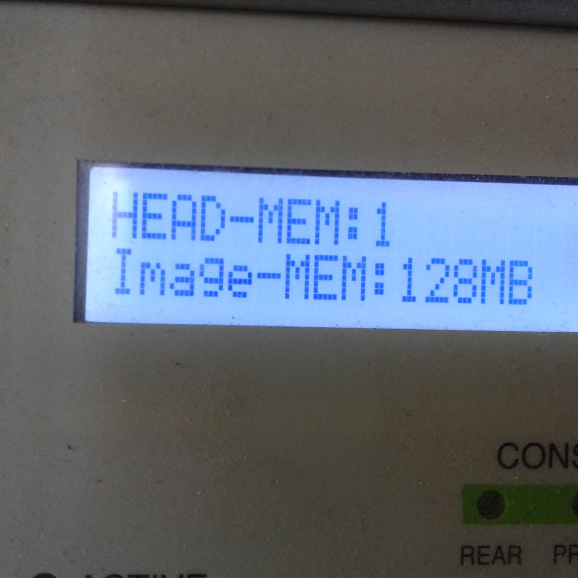

I just replaced the printhead of my JV33-130 Mimaki and I'm getting this message and dose not do anything! any help I would appreciated

Mimaki printers have memory boards on their heads. If they aren't plugged in or damaged, you get this message. I am assuming either you just forgot to plug that in or it's head that wasn't from Mimaki in which case it wouldn't have a memory board.
SALVATORE
Thank you for all your help! I really appreciated you took the time and look in, I resolved the Problem.
