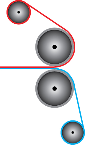

Heat is a good thing on a hign-end laminator, but I can imagine it could cause issues on some of the entry level laminators out there that have idler bars and crowned rollers.
Roll to roll is the ideal way to go for processing prints longer than 8 feet. Having the material feed directly from the supply shaft and wrap around the bottom nip roller eliminates nearly all problems with long laminations. If the material feeds from the supply shaft and around the infeed table and then travels flat to the nip, you lose most of the benefit of the direct-to-nip laminators and can have problems on long runs. I would consider the material path of the laminator as part of the decision process.

You mean it goes from roll to nips... and if the front table is a part of it forget about it?

The benefit of roll-to-nip versus roll-to-table-to-nip is that by having the media make the 1/4 turn around the lower nip roller guarantees the material is flat as the lam is applied and prevents buckling / tunneling / distortion / skewing / etc of the printed media. It is the same concept as rolling a curled and wavy print to a core and it lays flat. If the print has to travel flat for a ways as it enters the nip, it can shrink and buckle and get weird before it gets laminated and the problem can manifest as a ruined job. Roll to roll is fantastic because the print is then wound up on a core and ready for further processing.
