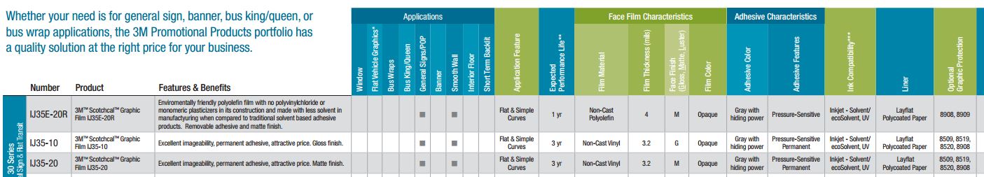

That is a chart referencing PROMOTIONAL vinyls. Next.
Did you notice where it says IJ35 and how it has ZERO check marks next to Vehicle Graphics? I understand you have success with it, I am just telling the client it's not made for that application, which it totally is not. If you call 3M, that is what THEY will tell you about their material, that was my point.

I have seen issues! I have a trailer company that puts advertising decals on the horse trailers they build. Each trailer gets a package of approx 8" x 8" decals. Years back I explained the difference between cast vs calendared etc... They decide to go with calendared obviously from a budget standpoint. IJ 35 and 8508 combo was used. I have other customers that we do similar decal sets for in cast materials (either IJ180 of avery 1105 with their corresponding laminates). After a couple of years the IJ35 decals showed a little shrinkage and looked less than perfect. This has never been an issue with any of the cast decals. I had a discussion with the customer, quoted him the cast price and as of the last year he has switched. I feel better about it and so does he.
Its all about expectations, and if you have been around a while, longevity becomes more important when you see the work you produced holding up.
"Zero Issues" can mean a lot of things. Just because nobody came back with an issue doesn't mean there were none. I have unhappy people walk in our door all the time and not the place they are unhappy with.
Like most here just use the right stuff.
