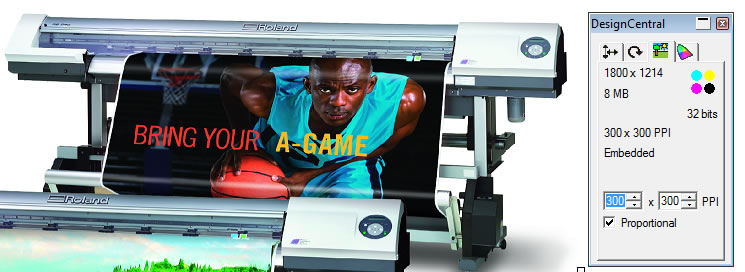

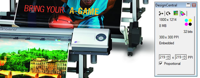

I am trying to create basically a wrap for a 13.5' X 7' trailer which is involving using graphics downloaded from the net. While I realize that there is nothing I can do to really clean up some of the graphics I have managed to find and use a lot of acceptable graphics. Now my biggest problem is a background picture which measures 166.0" X 87.0". This picture was downloaded from the net in .jpg and .bmp formats and it's original resolution was 1900X1200 ppi. when saved to my PC but when I import it into Flexi 10, it reduces it to 96X96 ppi which makes it mostly useless when enlarged to the 166" X 87" as far as printing goes. Could someone please tell me how to work around this as I really would like to assemble this large print in Flexi if at all possible. Thanks!!!
CS-SignSupply
If you import the file and then resize it to 166"x87", your image settings will change. Image 1
If imported and left at original size, the ppi should remain as designed. image 2

Thanks Bobby for the information. I guess that what I need then is a background picture with high enough original resolution to print the large picture without any pixelation or jpeg artifacts in the first place. I had enlarged the picture in Photoshop but then it seemed that the file was too large for Flexi to work with or even save. I also realized that I was mistaking the original size ppi for the resolution or actual printing size which was importing into Flexi at 20.0" X 12.5" at the ppi of 96 X 96. I was just thinking that Flexi was changing something in the files attributes when I imported the files. Well, back to the Google image search pages.
