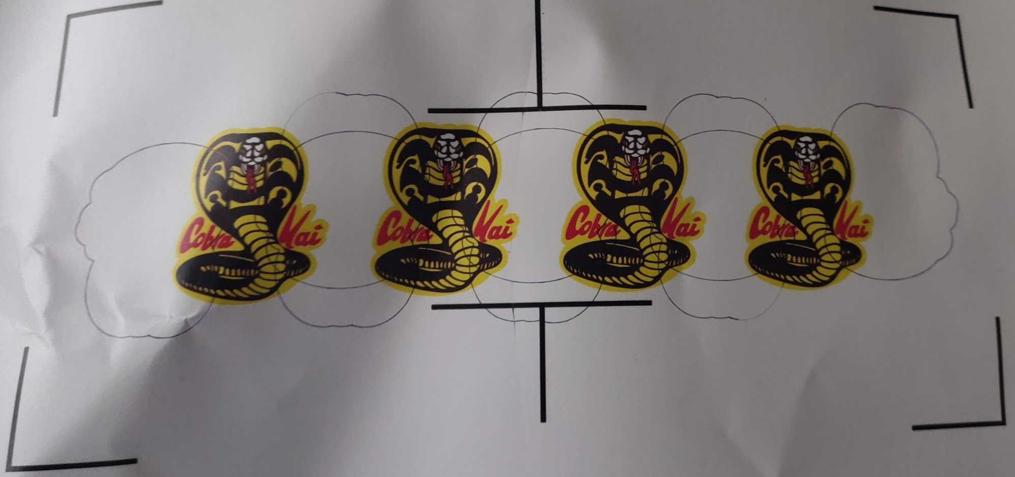

I'm having some trouble with a print and cut setup with my printer and cutter using Flexi. Not sure if its a configuration issue with Flexi or Saga or something else. The Saga 720p is brand new and I've got some stuff to cut fine with signcut and just cut-only stuff with Flexi. But printing with registration marks seems to be cutting outside where it should be.
Basically I just setup 4 small stickers to be printed.
I print on the printer and set the registration marks to be used to the "ARMS Plus" which is what the Saga uses for ARMS tracking. The printer prints it as expected.
Then I put the sheet into the cutter and follow the steps for the laser setup. I see the Saga scans all the registration marks successfully and right on the lines.
But when it starts to cut, it cuts the right shapes, but its offset by about 70% right of the first shape.
Seems like its not getting or abiding by one of the margins after it does the scan of the registration marks.
So I'm not sure if its a bug or config issue in Flexi... or something with Flexi and Saga... but Saga 720p is a supported cutter.
Any ideas or anyone with similar issues?
I could see if it was off by like a few millimeters then I could adjust the offset and calibrate, but this is a huge offset and seems like its something more than a calibration issue.

I wish mine was only 3mm. You can see here I used the pen to do the trace and its off by almost an entire image. Then I tried doing it upside down which was not right either

So I spent the afternoon chasing down offsets and such and was able to get the cutter aligned correctly at least for the one 4 sticker print above. Now trying with another sample to see if it holds for that as well. I basically just kept playing with the X,Y default offsets until I got it right
dsstrainer
Update.. so far I think its all working well now. I've learned that Flexi 19 or Saga doesn't seem to work with the "ARMS Plus" registration marks as Flexi prompts to hit ok after the cutter does the registration mark check, but the cutter seems to not do much during that time. But when I use "ARMS New Plus" it works great. The prompt from Flexi is clearer, tells you where to move the laser as the starting point, then hit ok and the cutter does its registration alignment and does the cuts. Tried a few different images and so far so good. I'm hesitant to upgrade to Flexi 21 now that i've got this working.

Changing default Offset worked for me. Had to keep doing test prints and manually guessing the x and y values and testing with the pen insert instead of the blade until I finally found one that looked good. Then I saved those defaults and it's been working great now
