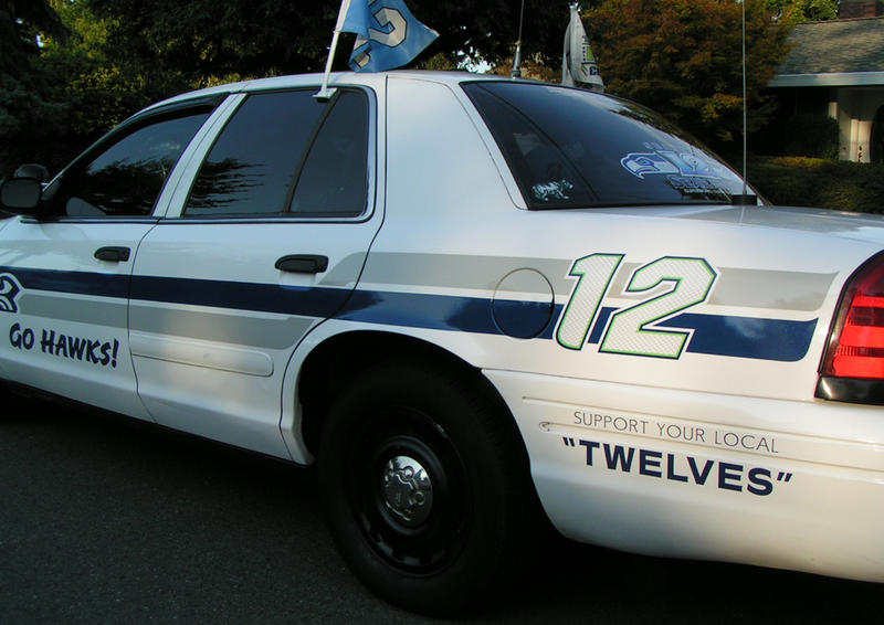

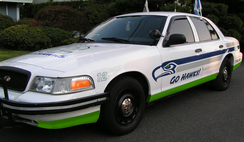

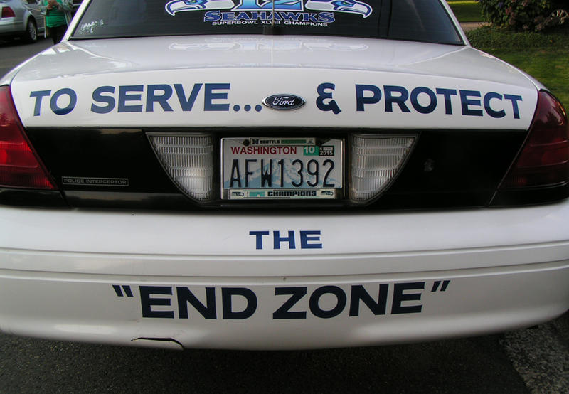

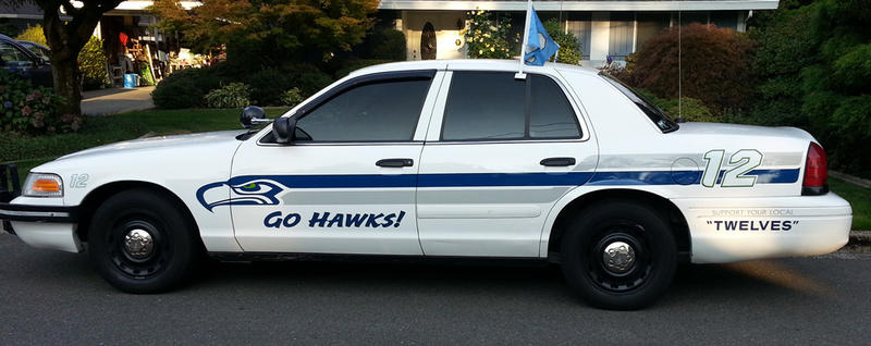

Hand Painted... Print.... Cut Vinyl... Here's one using it all.
The 12's are printed and cut, the "SUPPORT ...." line is cut vinyl and the rest is hand painted with 1Shot lettering enamel and 3 brushes (one coat for you 1Shot haters).
Stripes were taped off and painted after the 12's were applied.
One for the local "Hawk Patrol"... just in time for first regular season game.
I utilized printing because of complexities in the 12"s ... paint, for the purpose of staying in shape with the paint and brush work, and Cut vinyl because I was running out of time and patience before having to meet delivery time to customer at place of biz.
