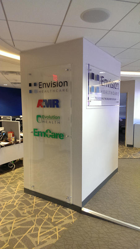

Acrylic panels, single panel, using standoffs, and almost always apply graphics to back side. We make hundreds of them each year.
