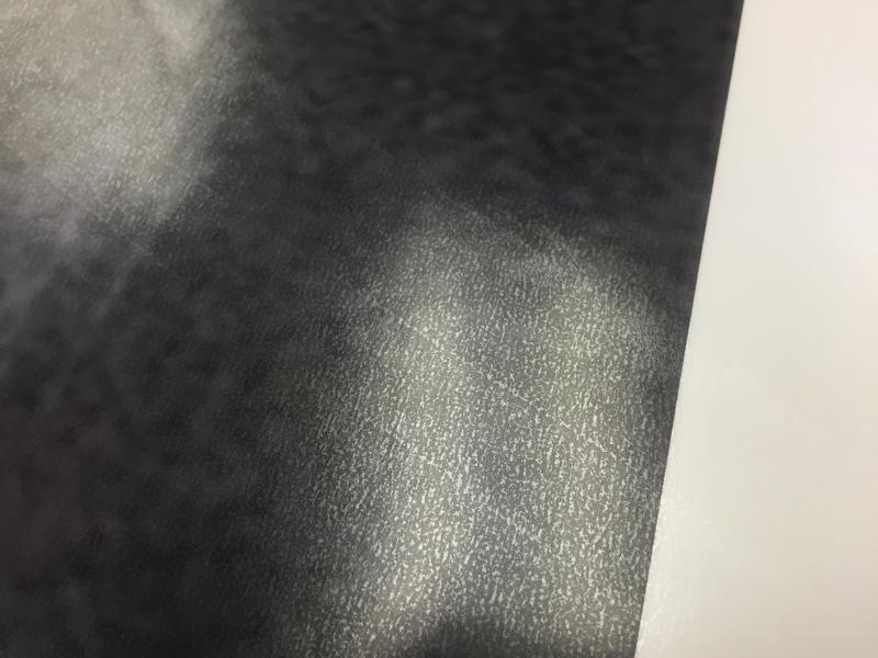

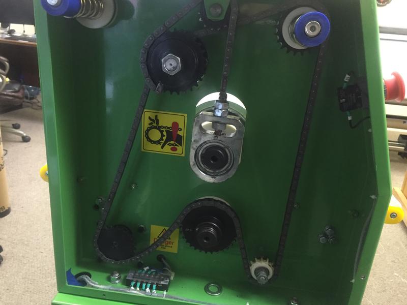

I am 5 days into this Ustech Laminator and I almost have it running right. It showed up with the chain off it's sprockets. I think I got the chain too tight. With the laminator loaded, the roller all the way down, there is still a slight space between the rollers (they don't touch).
I have never used a laminator so I don't know what is right and wrong. When I laminate it is silvering.
-Could be the Grimco Brite-line laminator on the brite-line vinyl.
-Could be because not enough pressure due to above issue.
I spoke with Dave at Ustech and said the silvering is normal and will go away.
This just doesn't seem right. I will add pics of the situation. (Roller are let all the way down)
If you own one of these and can let me know if this is right or not. Thanks!

This is the adjustment that was made after speaking with Dave.... When it showed up the chain was off the sprocket on the right side and just hanging on the left.
He told us how it was suppose to go over the phone. We took a sprocket off on the left side and got everything the way it was suppose to go (the left side wasn't even lifting up at first)
He sent a video on how to load the laminate...but it was throwing bubbles and wrinkles in it. Finally we leveled it. So,...now ....If you look at my pics....when loaded with material and down all the way
the chain is tight and there is a gap...the gap could be from the laminate. I just thought since the roller was so heavy that there would not be a space.
Dave said at first that there should be some slack...but then he said if the only thing is the silvering then it is ok.
So, by looking at the picture...With the roller all the way down, should there still be a gap on either side? Should there be slack in the chain?

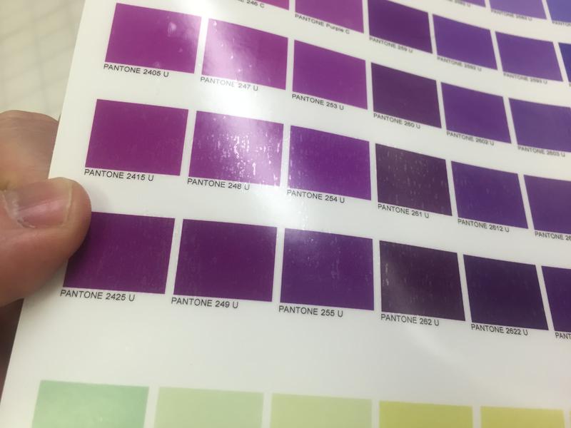

This was laminated 5 days ago. It is not going away.
Is it the Brite-line laminate from Grimco or is it a pressure issue?

I think the silvering is a pressure issue. If you run your fingernail across the affected area, you'll find it probably comes out.
It usually comes out on it's own overnight, so if it's 5 days then I don't know. I don't have this machine but, I don't think there should be a space. If the chain lowers the roller, and it's loose, then the the rollers should have maximum pressure. There must be something else holding the rollers apart.

By the looks of your picture it's not adjusted correctly. You need to get the roller level and there can't be any space. The weight of the roller will laminate your prints evenly. When the roller meets the bottom roller there should be just enough play in the chain to allow all the weight to be distributed evenly. Don't give up. I laminated over 200ft a couple days after I received and adjusted mine. It works well when it's adjusted correctly. John

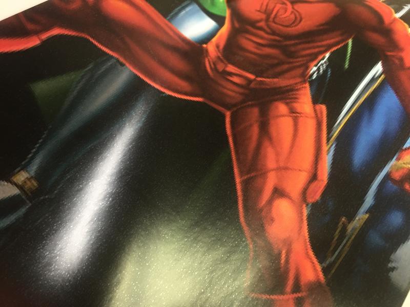

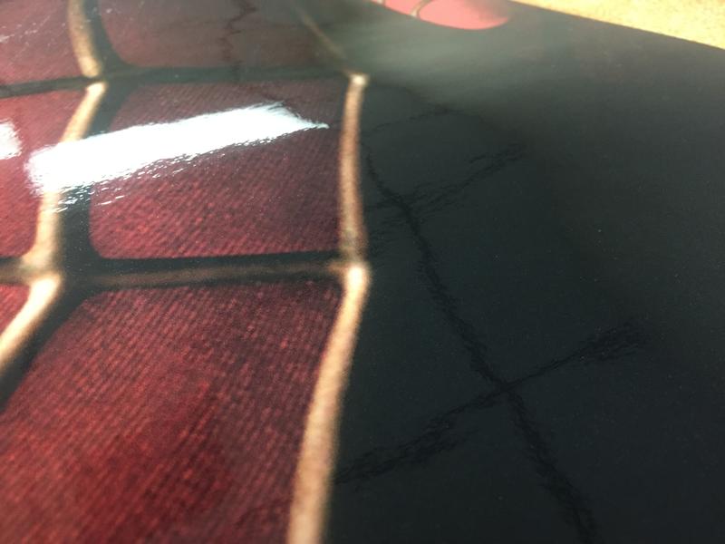

Alright kids..... here is what happened,
I went back in and put some slack on the chains to allow more pressure. I ran the laminate (BriteLine UV shield Intermediate) through and...same thing!
So, I used sample laminate that came with the printer (3M 8518 performance) almost no silvering! I am pretty sure what little silvering there is will disappear.
I have attached a pic of the 2. Spidey is the performance and Daredevil's crotch is the intermediate.
So, I am going to purchase ad different laminate.

Bubbles won't go away. Silvering will eventually but is usually an indicator of problems with material, tooling or technique. Roll the silvered print tightly on a core for a few hours to speed up the process. Heat assist makes a huge difference. With heat you can deliver on the spot, without heat you will have to wait for the silvering to fade. Shame the laminator needed a rebuild out of the box. Calibration can change if you move the unit around so be prepared to recalibrate periodically.

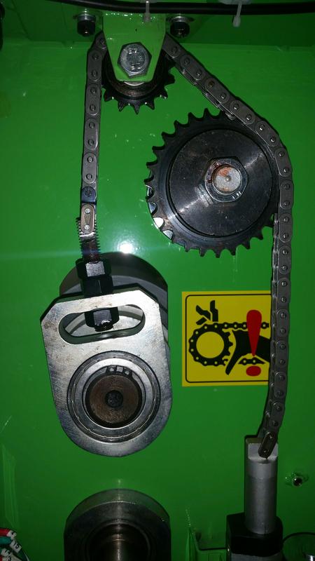

There should not be any space between ur rollers when they are fully lowered.

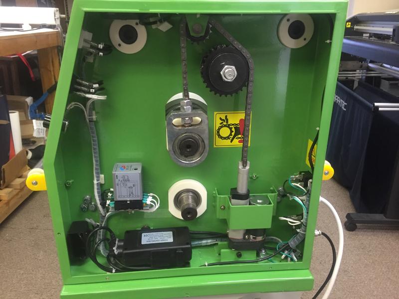

Below is a photo I just took of ours with the rollers lowered. You can see a little slack on both sides of the chain. Our chain had jumped off the sprocket when it arrived as well.
We typically use 3M 8508 for everyday stuff. Never had silvering. Shop kept at 70 most of the time. Also used a roll of cheap calendered Lamex that came with the printer. No silvering there either.

I typically use oracal 210g for standard stuff. But I haven't had any problems with the briteline products, general formulations dry erase, Avery 1060, etc etc etc.
I'm almost wondering if your problem is tension on the lam before it goes in the nip. Since 8518 is softer/stretchier maybe there's enough tension, but the thicker calendered stuff needs a little more.
ABOVE AND BEYOND!! Thanks! Removing the cover and taking a pic!!..THANKS!
