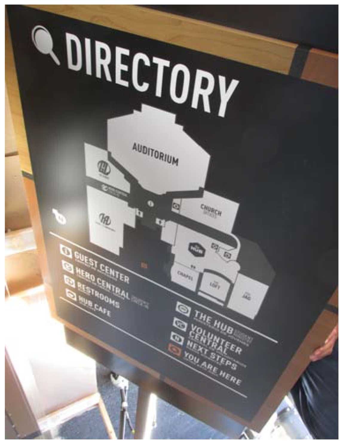

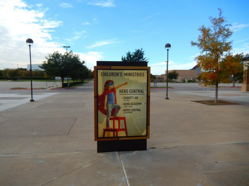

I think if you route the panels you should clear coat them, the print does tend to chip at least from what I noticed. We did these panels and printed on ACM turned out nice after we applied a satin clear coat they were broken into pan faces.
