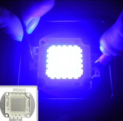

My 100W UV LED Chip should be here this week as well. Came with a power supply too. All I gotta do is screw it to a heat sink, and maybe add a fan on the top to insure the LED's have a long life and don't overheat. The chip and power supply only cost me $157, that's with shipping. I ordered direct from the manufacturer, rather than be raped by some re-seller. The chips by themselves usually range between $300 - $900 a pop on eBay... so yeah... for an experiment... not going to drop $900 on a UV LED Chip, without a power supply.

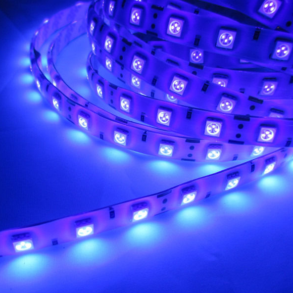

I did however pull the trigger on a 5m roll of UV LEDs. I got the SMD5050s, they will be much brighter than the usual 3528s that are usually sold. However, they are still only 60W, running off 12V power supply. I plan on running 3 rows along the face of the heater fan that points directly at the prints as it exits the printer, sorta as a "Full Width Curing Back-Up) They also are listed as a wavelength of 395nm. I should be good with the ink curing even at full speed printing. But I'll know more when the ink get here.

"chip and power supply only cost me $157, that's with shipping. I ordered direct from the manufacturer, " Can you provide a link for that purchase or the website? I have a spare jv33-160 I may attempt to convert to UV
