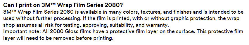

From the 2080 bulletin:
It's not designed to be a printable film... however we have successfully printed on 1080 for a custom wrap in the past with a solvent machine.
I just checked and technically Gloss Blue Fire is a 1080 film, but I was wondering if maybe the film might be the issue.

3M 2080 Gloss Fire Blue film is not a printable film - Any type of printing on 2080 will fail because its not intended for printing. 3M offers several Films and Vinyl's that are UV printable.

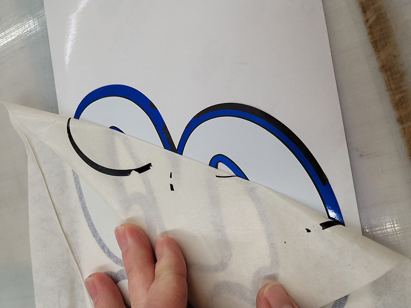

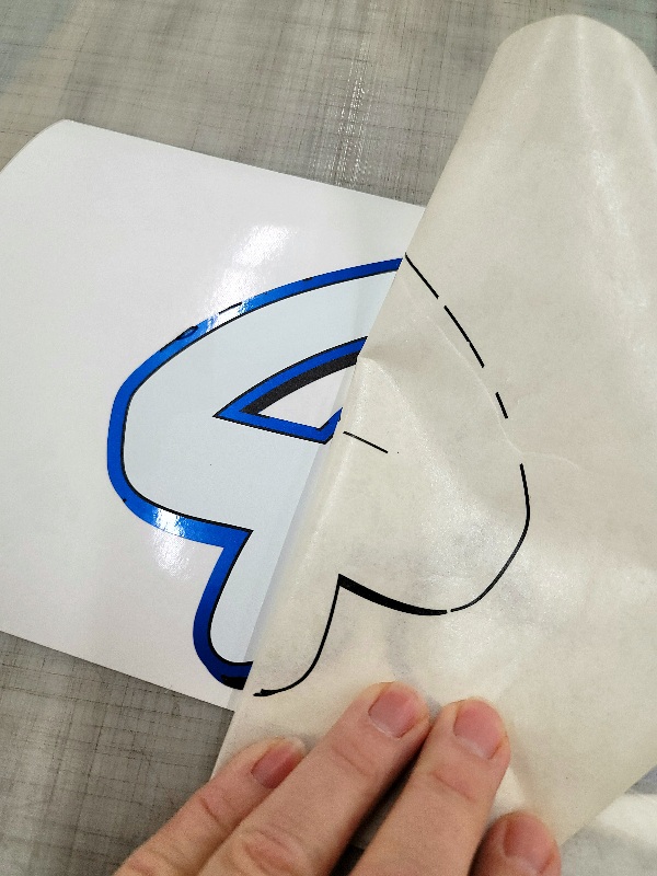

This particular print has white and black print. It's only the black that is peeling off, the white stuck down fine. In the pictures below, you can see not all of the black is coming off. It might be more due to how thin the black print is that's peeling off.

I doubt laminating would be a good idea in this case. The black ink will probably come off anyway and the black and laminate lift from the blue on the edges.
Maybe the cutting line is creating some tension to the edge, just enough to make the black start lifting, and then the tape is doing the rest?
Like I said, UV inks normally adhere well to vinyls and even though I haven't tried 3M 1080 or 2080, I believe it should work even though they don't recommend it.
The fact that some parts stick while others loosen indicates that there might be something on the vinyl, so I suggest wiping it off with alcohol or similar before printing.
Must say I'm a bit surprised the white sticks while black doesn't.
What happens if you switch black and white, I mean to get thin white lines and solid black areas.

The black is a thicker layer than the white, so it peels off easier - it takes longer to "Cure".
And just so people dont understand... UV ink Dries instantly, it does not cure instantly.
https://www.nazdar.com/en-us/News-Articles/ArtMID/4197/ArticleID/567 Read this article by nazdar - They're a ink supplier for UV, Screen printing, solvent printers, and a few others... So they should know what theyre talking about.
I'm sure if you dig up the manuals on your flatbed printer it'll say the same thing - Dry to the touch, cures fully in a few days. It doesnt have its strongest bond initially... So yes, waiting a few days, or however long a full cure for your inkset takes, will make it adhere better and you'll have a less likely chance of it pulling the ink off.
Theres no harm in shipping a sign off minutes after its printed - But on some materials... like acyrlics and certain plastics (Like vinyls) A few days will give it more time to bond, and make it less scratchable.
Print something on acyrlic, or something you normally get scratches on if you're not super careful - let it sit for a couple days, then reprint it...and do a scratch test. you'll be amazed at how much that bit of extra time allowed it to bond better, and how much more scratch resistant it is.

I did reprint a couple of days ago and waited to put tape on it until today and I could peel the tape off without losing any black.
