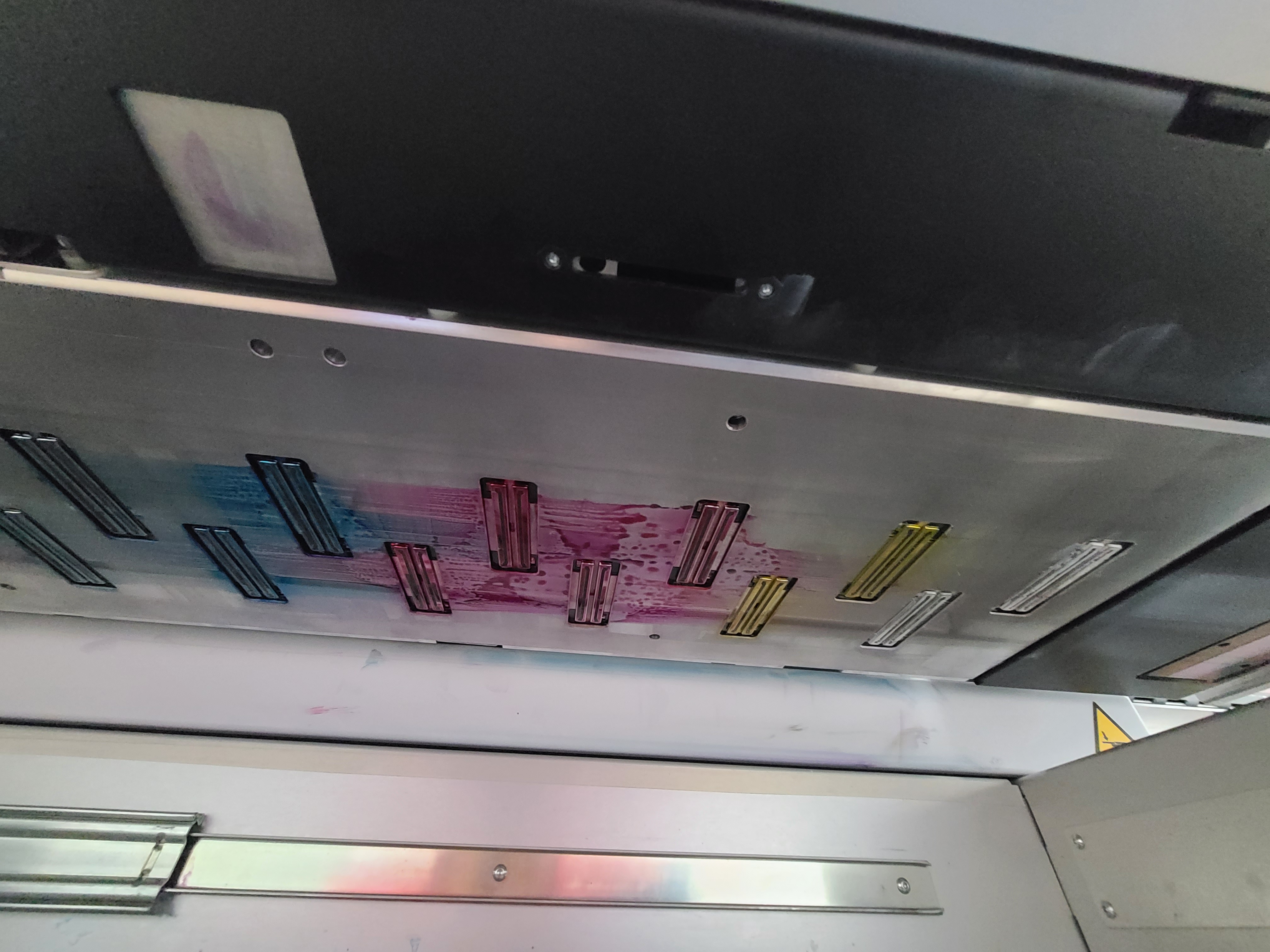

We had a problem similar to this and ended up swapping out the machine. Cyan was spraying all over the place. How much printing did you do to get that much ink on the carriage?
After printing less than a hour it looked like this, when did you get your printer installed? what was different about the new one?

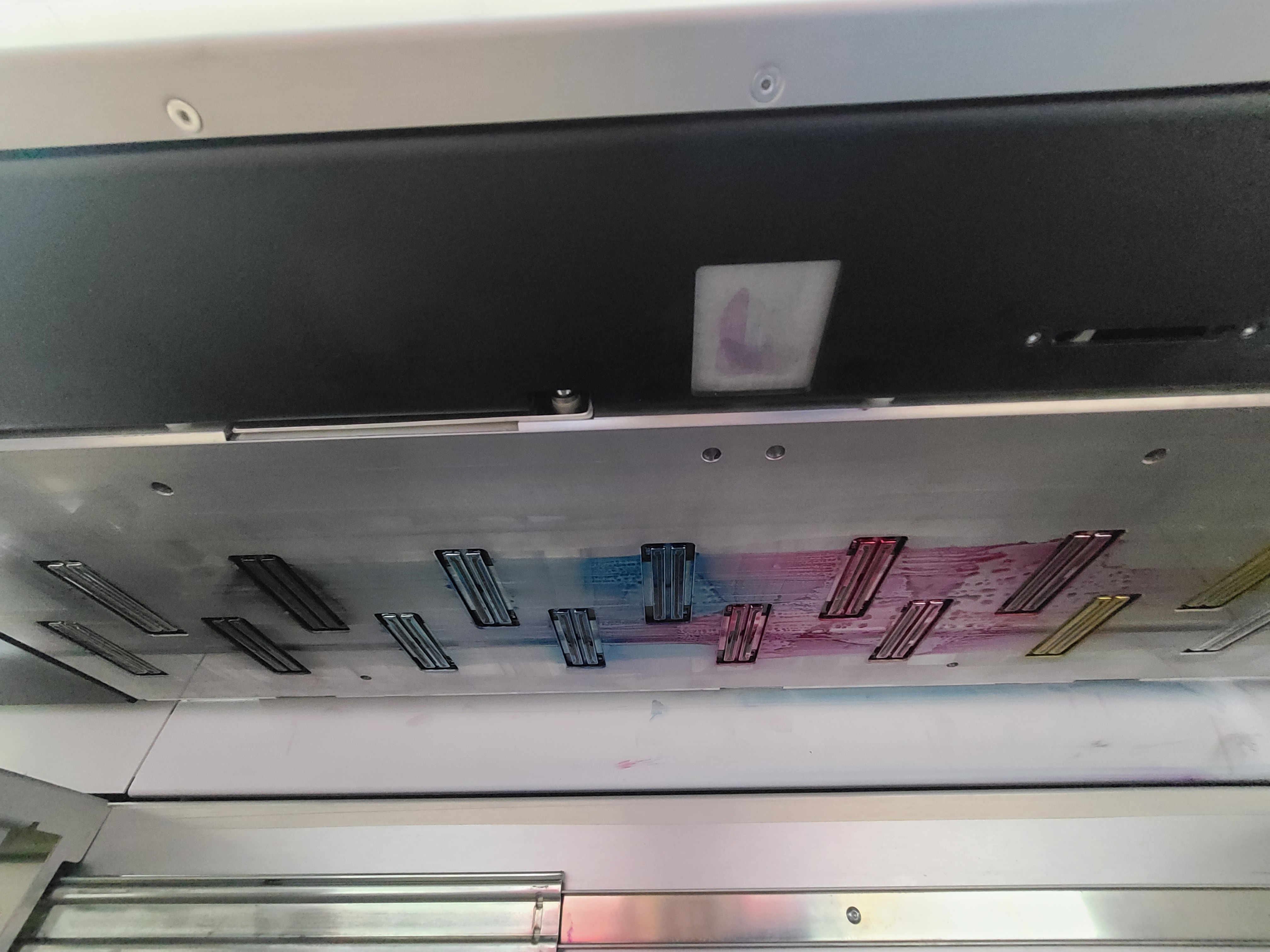

Hi Simon, unfortunately yes these issues are still ongoing for us. We can only run around 5 to 7 beds before having to clean the carriage again. We've had the machine for almost 3 months it's been down for about half that time due to various parts failing and other issues. We've had all ink pumps go bad, our auto cleaning system break, a leak in the coolant line, etc. Attached is a picture from last week. This is after running four beds. 20220624_150503.jpg
Fahrenheit731
We have been told by our technician that the overspray issue is caused by the high flow vacuum table which is on all 2300 series printers. Basically the when the print moves past the substrate, the vacuum pulls the ink from the head and leaves it on the carriage potentially causing ink drops. Which we have had issues with. We want to love the machine because when it is working right, it prints wonderfully.
