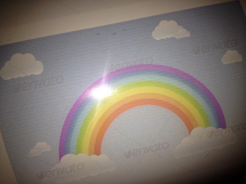

I was wondering if anyone knew what the best settings to print on vinyl for like race car wraps? Im having trouble with it because there are small lines you can barely see and would like to get these out of here. A friend gave me the machine and didn't know much about it. Here is a image of what it currently looks like..

Looks like you need to change the feed adjust. With a Mutoh you should not be getting straight lines like that . Do you have the wave effect turned on?
Wave effect and Fine and S. FIne is on.
