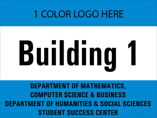

We are making 10 exterior signs - 3 ft x 4 ft / 6 mil polymetal / oracal cast vinyl. The customer also wants vandal guard lamination. At the top and bottom of each sign there is a band of vinyl that bleeds to the edges (see attached). My tubelite sales rep says that we should apply the vandal guard so that it wraps around the sign and actually ends a few inches on the other side. The lam would go over the top edge of the sign by an inch and over the bottom edge by an inch. The rep also suggested then applying an edge sealing tape to the edges of the lam on the back side of the sign. The reasoning is in case the vandal guard lamination shrinks at a different rate than the oracal, it will still look good on the front.
Any thoughts on this?? Will the vandal guard shrink that much? Will wrapping the lam around the edges of the sign make more problems than it solves? THANKS!

Here is the draft of the typical sign. Has anyone else had a bad experience trying to remove graffiti from vandal guard? THANKS!
