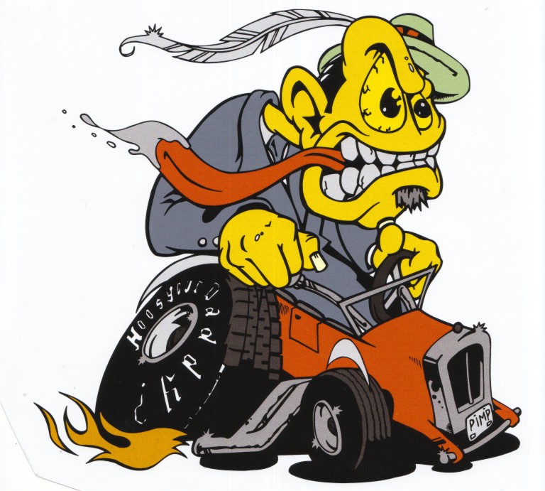

Here's a scan
Out There
Looks about the same.
I am a bit curious, though.
Maybe feedback from customers would be ideal?
So far everyone has been very happy. Although most of my printing has been on banners :rolleyes:. It's when I see it up close it's hard for me to just accept it is, what it is.

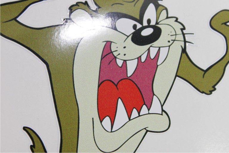

Here's some different pics and then I promise I'll stop.
  • Graphic111111111.pdf
