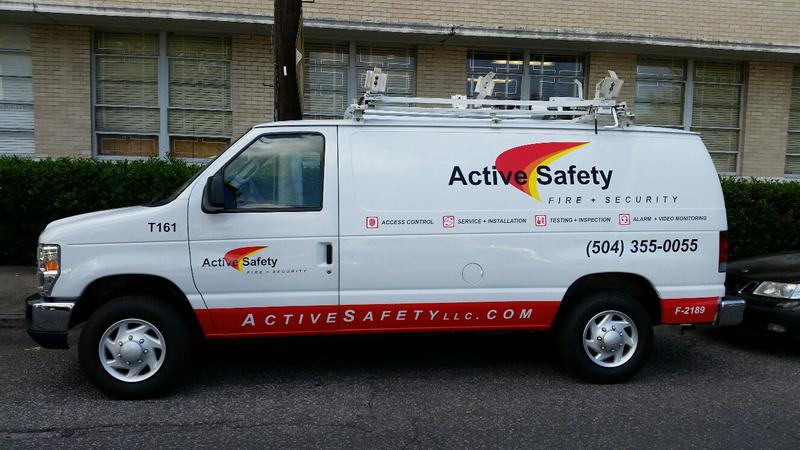

Hello.
We have a job to put some vinyl decals on a van.
Normally I would make it with Oracal 751, but in this case the customer wants it to be done the same way as their other van: all decals were "printed with latex on 3M 180C".
So, offered them to print the logo on 3M 180C and use Oracal 751 for black, white and red decals.
Now they worry that the different vinyls will fade at a different rate. Also, i am pretty sure that the black color printed on vinyl will look different than the black vinyl.
I have seen signmakers printing decals instead of cutting them of solid color vinyl before and I am not sure what I think about it.
What is your opinion?

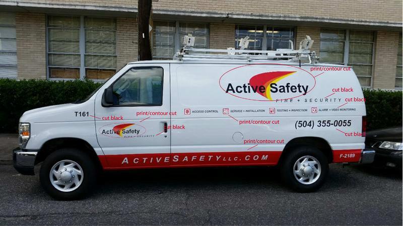

I would do like this.... You won't notice much difference in the blacks of print vs cut vinyl. We mix all the time, customer usually has no clue.
rdm01
I'd most likely offer two options, perhaps two quotes. All cut vinyl (longer lasting, more fade resistant), or printed and cut (more economical). For the printed and cut version, I would do whatever is quickest and cheapest since that is the route they chose. On the one imaged, it would be printed logos/bottom band, all black cut vinyl over that.
