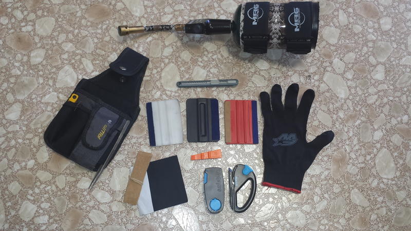

Here is what is ALWAYS in my pouch. I make my own micro-suede buffer strips but they are pretty much identical to the "Monkey Strips" available.
I found felt wears down too fast, velcro ...nope, and the suede those expensive ones use gloss over & get sticky spots.
Black (Magnetic) OR (3M PA-1 Gold) (if you don't want magnetic)
Red Pro Flex (Avery)
Teflon (Lidco)
Mini Hang Loose (Yello Tools)
Wrap Glove (Edge Wraps)
Monkey Strips & sometimes Nylon strips (Walmart...shhh it's a secret)

The expensive brand mentioned have a really thick buffer that tends to lose it's softness within a few wraps. It also cannot bend since it's teflon.
Teflon (Lidco)
