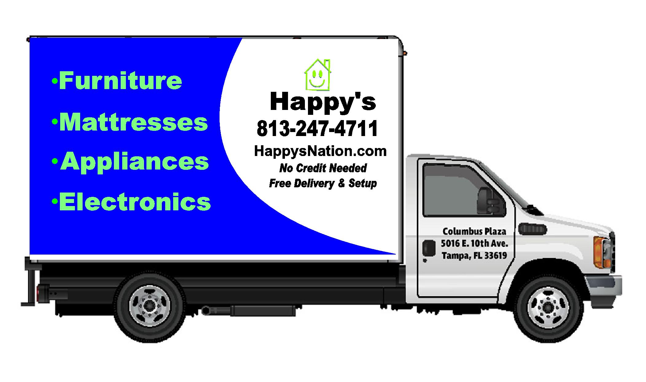

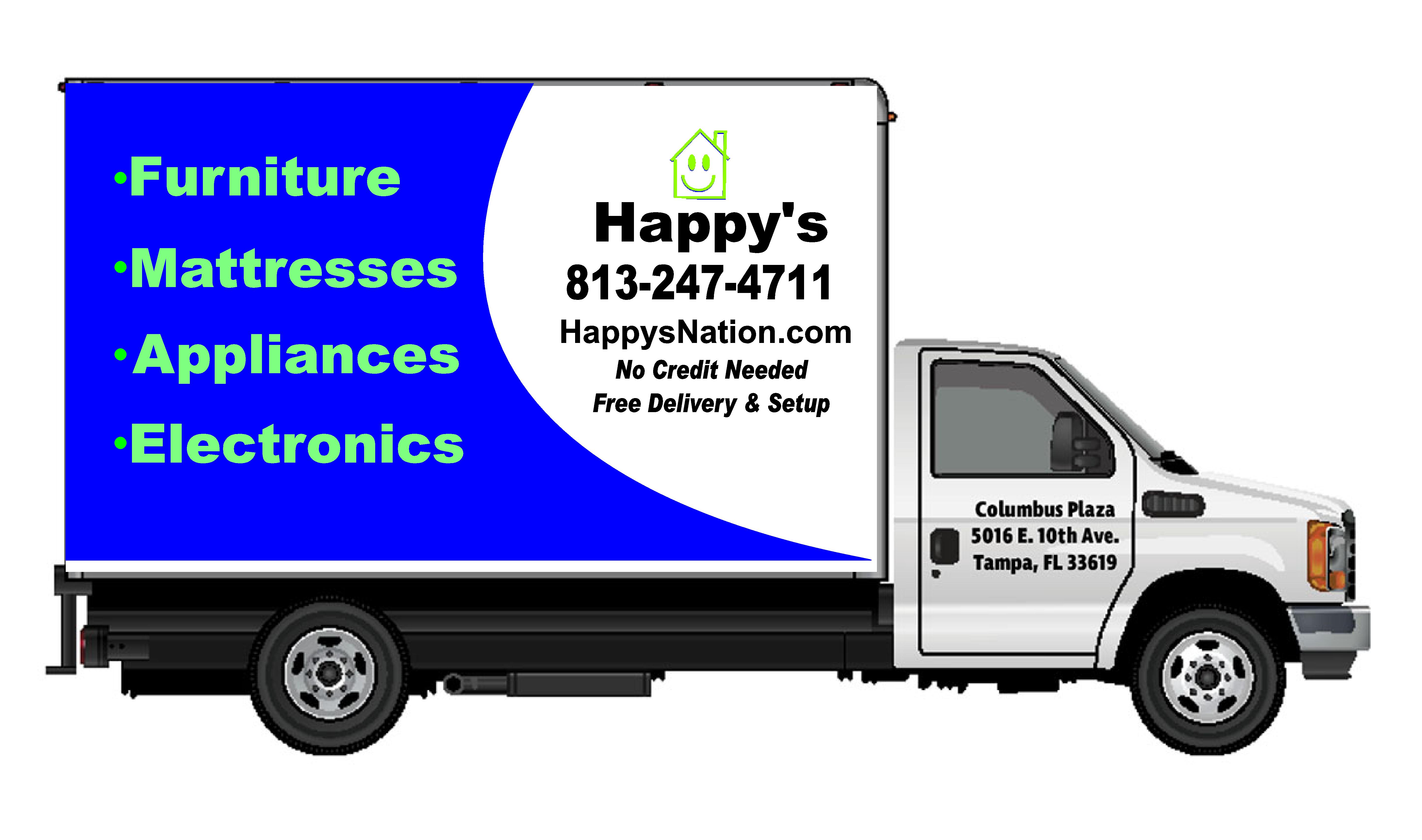

That said, it looks like the OP used pure RGB green to design his layout. On the screen, pure RGB green does look almost fluorescent. But it doesn't print that way. Actually, it prints quite dark. But you CAN print pretty bright greens with your printer if you specify a good color.

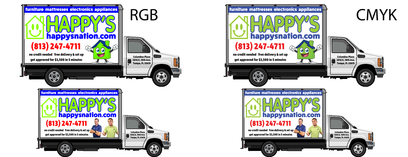

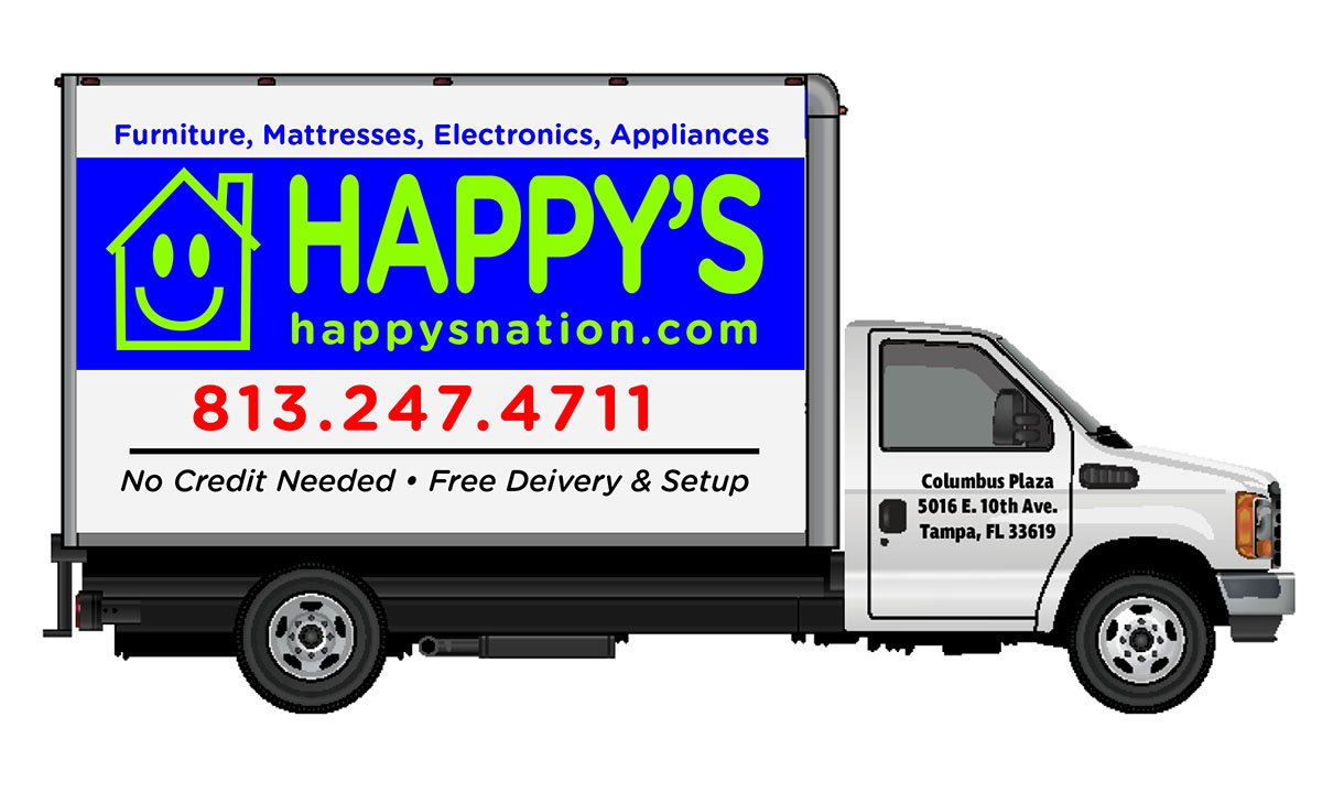

One thing no one is mentioning is that most of the colors in the file are outside the CMYK gamut and will look much more washed out than they appear on your screen. You should get in the habit of designing print jobs in CMYK mode rather than RGB. The discussion you are going to have with the customer when it doesn't print nearly as bright as this image is not a fun one to have after you have already printed it. Take a look at Myront's post above with his alterations. The reason his colors look relatively washed out is because he worked in the CMYK color space which converted the RGB colors in the original file to a color within the CMYK color space.

In this particular case posted by the OP, it seems the customer’s corporate colors are in fact, “out there.” (From looking at the website.) So, the OP will need to keep the file in RGB and reach for those colors from the printer and also utilize the printer’s ICC output profile to preview the limits of the process and adjust accordingly.

Here's an example of how much the design might change from what you're showing the client vs. what your printer will output. If you're going to design in RGB, you need to at least inform them about how the colours will change when printed.
