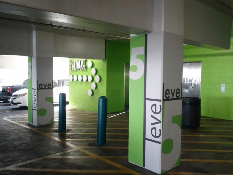

I ended up using a liquid laminate that worked well. Though we were wrapping concrete pillars in a parking garage.

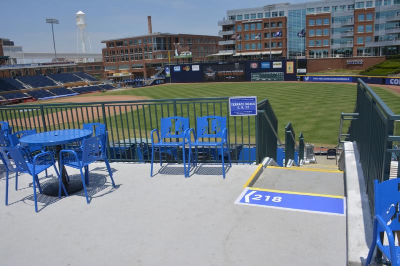

I've been having good success with a metal foil media applied with just roller pressure to conform to brick or other masonry, even concrete and asphalt.
The he attached pic shows a floor graphic on coated concrete. No special prep other than brushing off loose particles.
