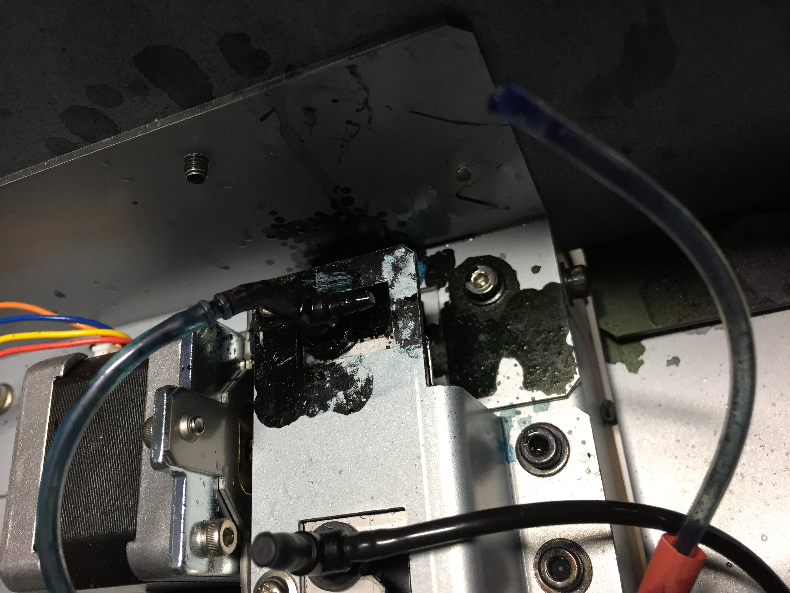

Right so, as it happens, one of the pipes going In to the top cap had snapped off
We've managed to put it on with some heat shrink and it works for now.

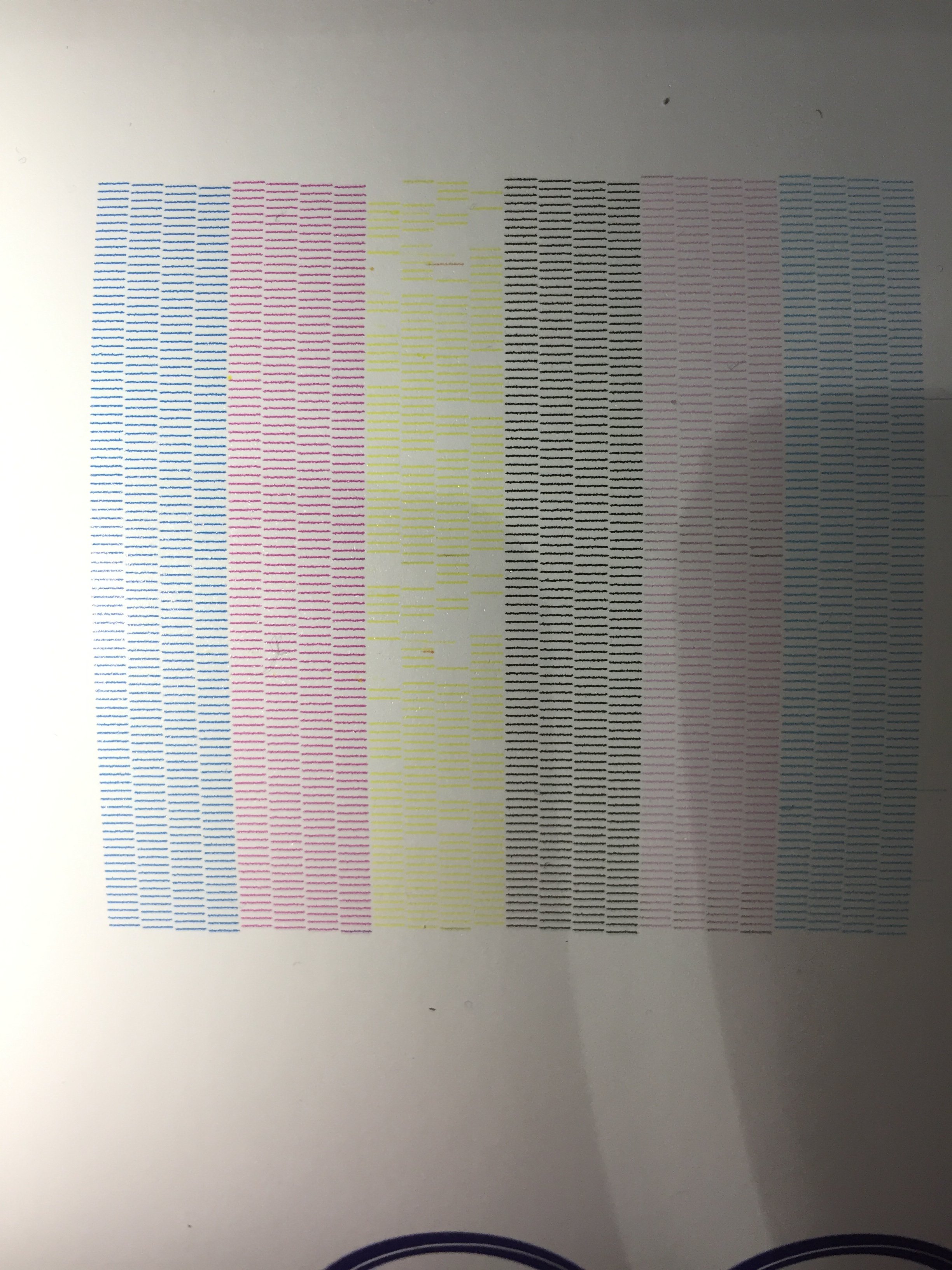

This is the original problem we were having, the yellow was just really weak and wasn't printing 100% so we can't get a really nice red or green at the moment.
I've attached a nozzle check aswell... any ideas what this could be?

The print head is back to printing all the nozzles as it should, but when ever we print a longer run, the yellow starts to fade out...
What's next? Is it worth replacing the dampener? Or is there any other things I can do to locate were the problem is?
