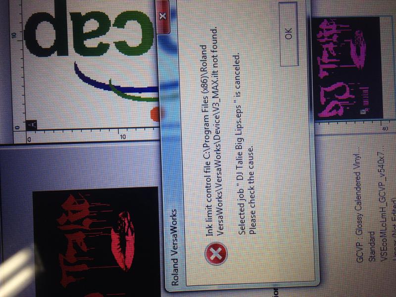

We had to add a new laptop to our production line this week. We got Versa installed on new computer, it sees the printer fine but when we send a file we get this error...
Ink limit control file C;\Program Files (x86)\Roland VersaWorks\VersaWorks\Device\V3_Max.ilt not found.
Any help would be appreciated.. Thanks in advance!

It sounds like not all the device descriptions are in the device folder. I did a quick search on my computer and found that file here:
C:\Program Files (x86)\Roland VersaWorks\VersaWorks\Device
Sounds like you just need to copy it over?
