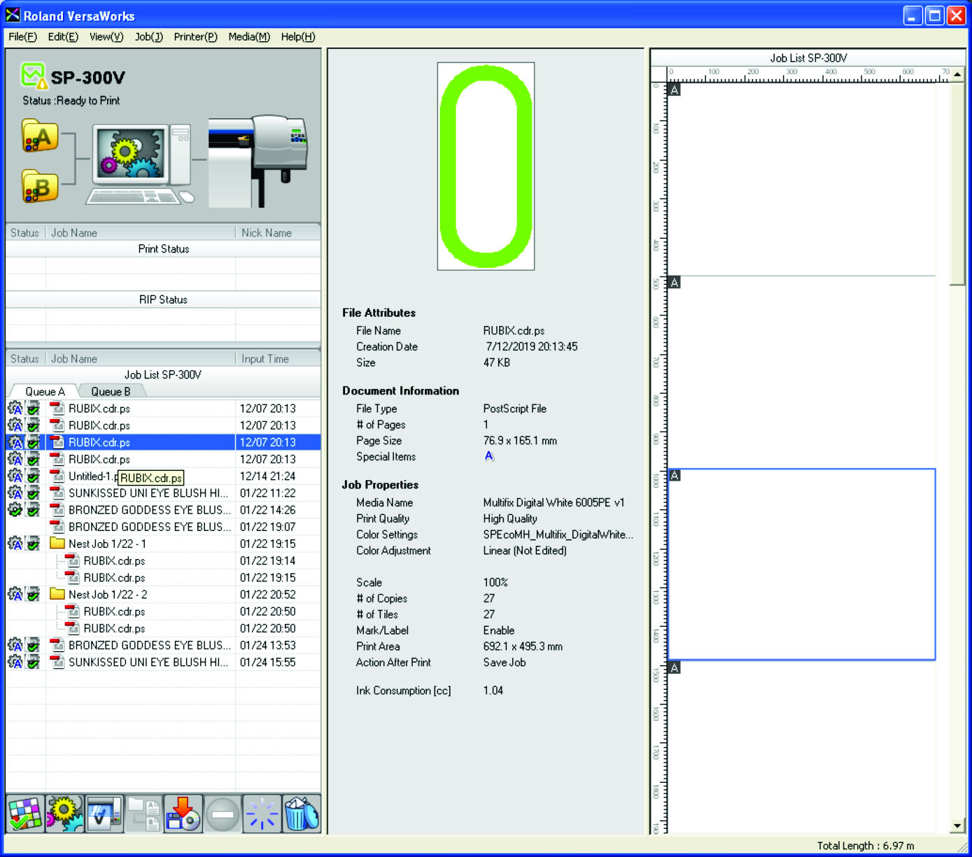

I have been using Versa Works for several years with no problems but all of a sudden the images don't show up in the Layout screen. All I get is a blank box with the queue number in the corner. If I click on the box it takes me to the correct design so I'm thinking it must be a memory issue. Nothing has changed on the computer - no new hardware or programs have been added. Also, Versa Works is taking a huge time to load.

I've had this happen. I usually dump the job and pull it back in - after clearing out the queue of anything that's gone out the door. I think it's a memory glitch like Joe said. If memory serves me correctly - I've had this happen and printed it anyway - and it was fine. Similar to how you can't trust the image quality in the VW display - it looks like junk but prints beautifully.

Off topic question; is she able to print CDR files because she has a newer version of Versaworks?
CDR files don't even show up in my Versaworks window when adding jobs.
Andy, to my knowledge Versaworks has never suppported CDR files. My understanding (I'm not a Corel guy so I may be wrong) is that the CDR format is highly proprietary and only works well with Corel. I do see that Flexi has a CDR 8 import filter, so I may be wrong.
Boudica
Interesting - I don't have Corel, I have Adobe products. I cannot pull an ai file into VW Dual or v5.5.1. I do see that there is a .ps after the.cdr in the file name.... could be saved as a cdr post script file. It's been years (over 10) since I've used Corel

I see where the question comes from - the center panel shows that it's a postscript file. I wonder if you tried importing a PDF file if the preview would work.
