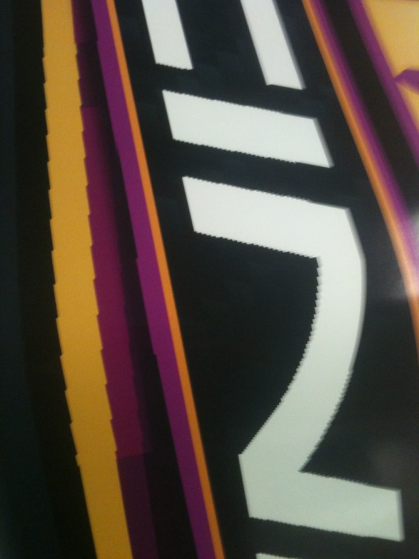

Thank you for your reply. My problem though is when I put a drop shadow on some art work, its pixelating stuff around it thats not supposed to be. I've had this problem forever now. I've been making my drop shadows in photoshop and bringing them in illustrator. Thats been working, but i was trying to save my self about 5 or 6 steps and just do it in illustrator. In the picture you can see the bottom of the box is pixeled and the bottom of the words above arent. Any suggestions?

If I have any photo effects at all, I import my file in to PhotoShop apply the effects, flatten then save as RGB Tiff and use that as the print file. always play to the strengths of the programs. Illustrator is great for vector, terrible for photo effects. Just get used to it.

Is it something with a cutline? I know you must flatten transparency before saving file to be pront/cut and eveytime i do that the shadows look like crap. I do like the others suggest and use photochop

It could be one or several of many things.
Read up on;
1) Raster effects resolution
2a) Transparency settings
2b) Overprint settings
3) Colour modes
4) General information on resolution settings
There may be others however reading up on all the above is a good long term solution for people in our industry.
