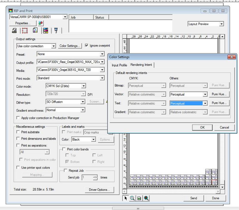

CS-SignSupply
SO Difussion is recommended normally, but will depend on maker of the profile.
What are your "Color Settings" -> Rendering Intent Tab settings?
Where did you get the Oracal Profile?
DZineGraphX
heres screen grabs of what i have
