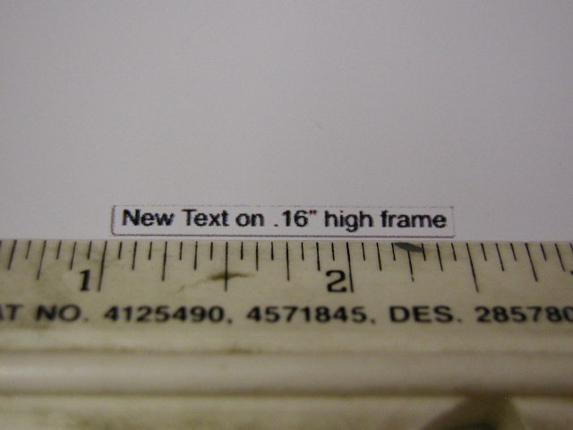

Small text with VCamm...
The VCamms can print incredibly small text. If you have ever done a calibration test you will see what I mean. I dont use Versaworks..the Colorip 2.2 on my SP300( not V).
When you get to the RIP is there a function to "SIZE" the output? ( %)
I'm wondering how you are exporting this and from which program?
This is the type of info that should be included in a post about a specific machine/application when you start a thread. What media are you printing to?
I just did a quickie here..didnt wait for the heater..printed to Oracal 3651.
Photo taken at 640 x 480. Saved as a tiff file in Corel. Then down-sized to make it postable here. So what you see here is not as sharp as it really is.
The dimensions as defined by the ruler..the text is actually smaller than .15" . I didnt play with the settings at all, this is just on 720 x 720 res. Going to 1400 res would help, I'm sure. As well as taking the photo in a higher res.
Anyway, I'm seeing this as doable.
