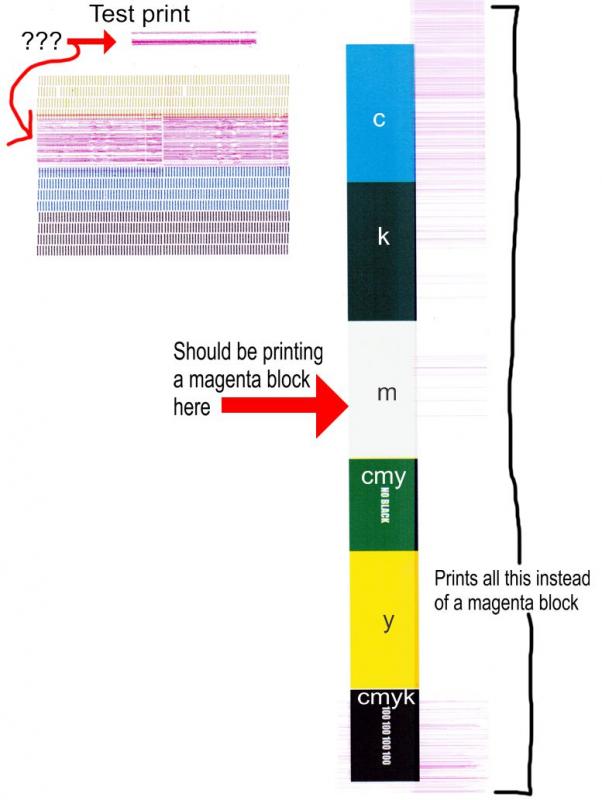

Anybody ever see anything like this problem? Please see attachment.
I just put in a used board. The magenta prints all over the place, except for where it's supposed to.

It looks like your not getting a proper electronic signal to the head. It could be the refurbed board but I would check the head cables and slider cables for damage or corrosion on the leads first. What was the magenta printing like before you replaced the board?

No, in fact, I replaced the main board because the Blue/Black head wasn't working at all. The Mag/Yel head WAS working fine! Now the Blue/Black head works, and Yellow, but the magenta has gone crazy. Cables look good. I swapped cables to test heads, and the problem went to the other head during the test, so it doesn't seem to be a head problem either.

If you swapped the cables and it switched heads It has to either be the cable or the board. You can isolate the problem by completely switching the cables. I am assuming that when you did the swap you just swapped the bottom part. So switch the cables completely top and bottoms and see if the problem switches to the other head. If it does then it is the cable for sure. If it stays in the magenta head the board is bad. If all the old board was doing was not printing black/cyan it is an easy fix. You just have to replace a soldered fuse. Its a few bucks for the fuse. If you can't solder you can send it in to have if fixed for between $100 and $200.

I replaced a blown F3 fuse and a blown transistor on the old board, and the CK head still didn't work. I also have a new carriage board, and new CK head. Putting the used board in is the only thing that has gotten the CK head working again, and the Yellow works, but the Magenta (which had been doing fine) has now gone crazy with the new (used) board.
Since doing the swap test, I've completely replaced the cable to the magenta side of the head with no change. Do you mean I should also switch the wider cables that connect to the very top of the carriage board and go to the main board?

It sounds like the only place the problem could be coming from is the used board since the M/Y head was working fine with the old board. We have ruled out the cables and the head so in my opinion, it has to be the used board. The M/Y head can't be damaged because the cable swap allowed it to print correctly. There is a small possibility that while working on it you accidentally nudged the wider cables out of position so I would check that but it is a long shot that it would only affect the magenta side of the head. I would see if you can find someone who can test the board.

I pulled the wider cables out (carriage board and main board) and put them back in with no change. And the cable ends looked good. I guess it's the replacement board. Ugggg. Thank you very much for your time VanderJ.

I sent the refurb unit back to the tech I'd gotten it from, and I also sent my original main board to him (which was malfunctioning with a different problem). He was able to fix my original board, so that's the one he sent back to me. The print problem that this thread refers to was DEFINITELY due to something being wrong with the refurb board (because my printer worked perfectly after I installed my repaired original board). I hope your problem is something simpler and less expensive to fix. Good luck!

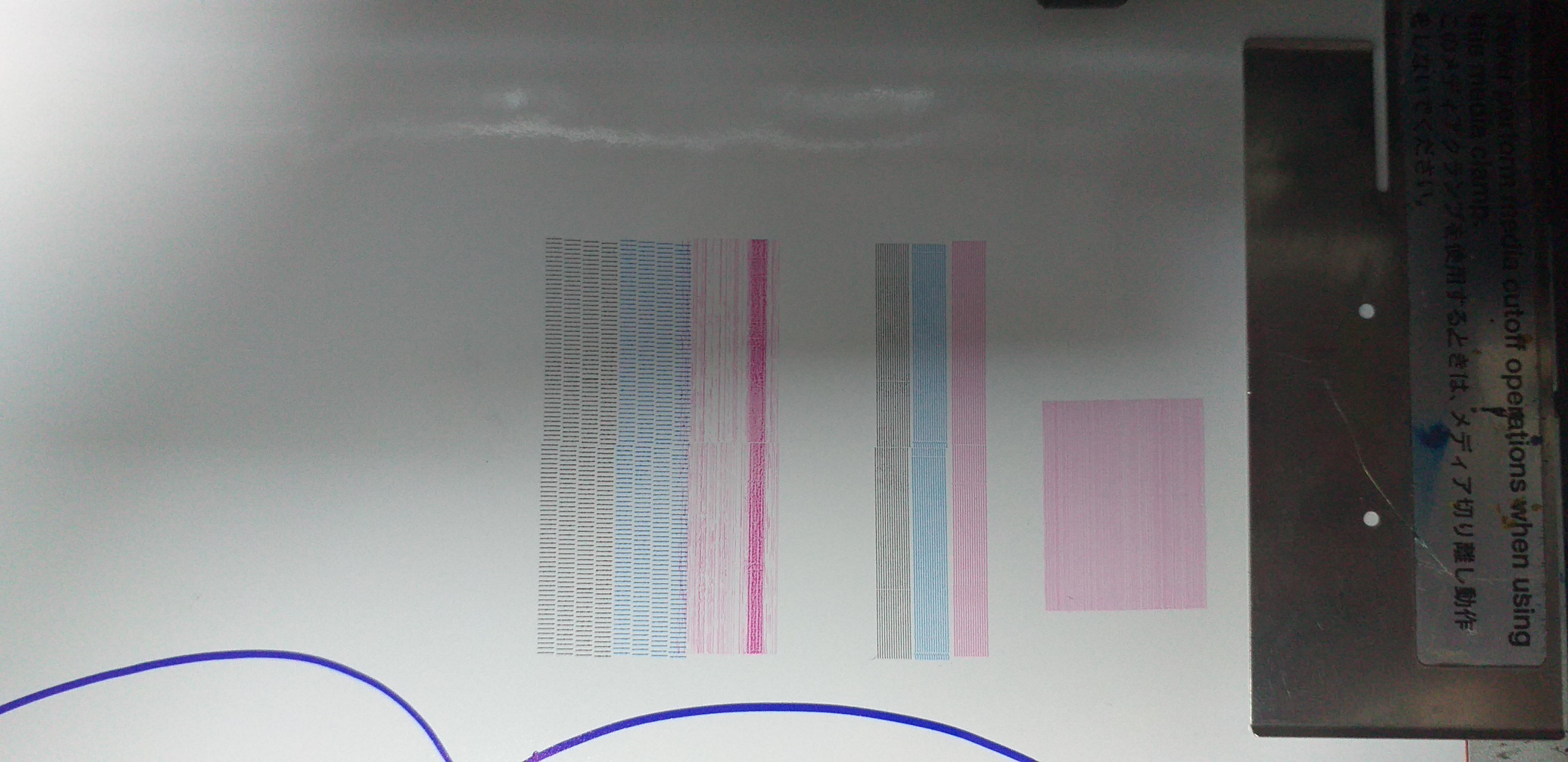

thank you very much for your answer, here you are my problem : print black when i print only red and yellow !!! just after a manuel cleaner :covereyes:

Wow! That is horrible! My guess would be a problem with the main board. But, maybe it's a cable problem.
Anybody is free to jump in here :) Because I am definitely NOT a tech.
If you have any spare head cables, then I would go ahead and replace the ones on your machine (WITH THE MAIN POWER OFF WHILE YOU REPLACE THEM). If you don't have spare head cables, then WITH THE MAIN POWER OFF, you can swap the head cables from the C/K head with the cables from the M/Y head, top and bottom (a complete swap). If the problem continues but the colors are reversed, then you probably have a problem with your cables. If the problem continues EXACTLY the way it WAS, then you probably have a problem with your main board, or maybe with the cables going from the carriage board to the main board. My guess is still a main board problem, but again, I'm not a tech.
