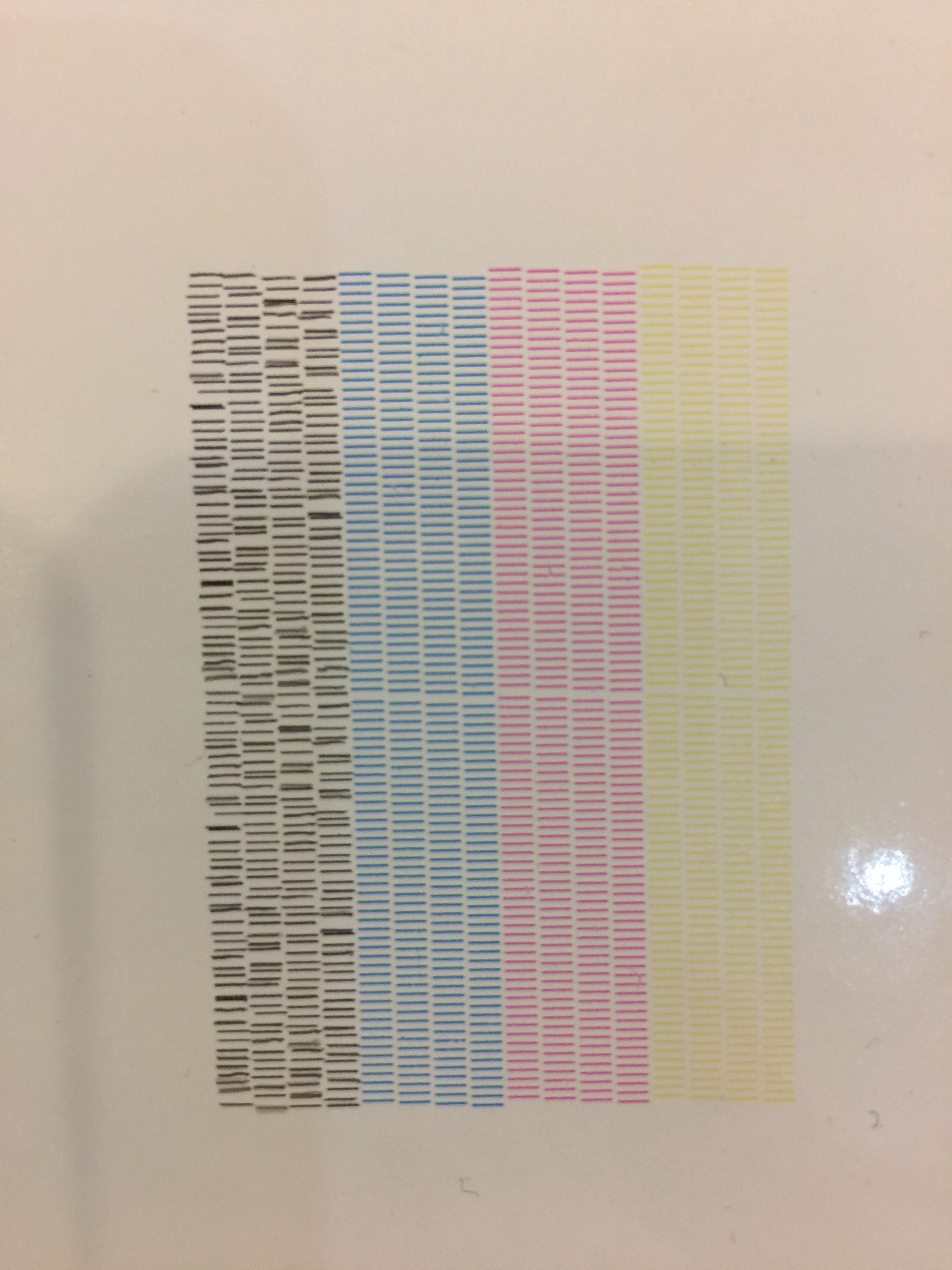

When I print my black looks fuzzy. All the other colors look perfect. I did a test print and this is what it looked like. I called CS Sign Supply (where I bought the plotter) and they will not answer or return my calls. Can anyone help?

Looks like too many deflected nozzles.. Either need a new black head, or static. Could also be head is set to high.
